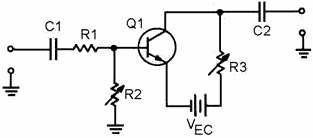

found this
AMPLIFIER INPUT/OUTPUT IMPEDANCE AND GAIN
You should remember that the gain of a stage is calculated by using the input and output signals.
Voltage gain is calculated using input and output voltage; current gain uses input and output current; and power gain uses input and output power. For the purposes of our discussion, we will only be concerned with voltage gain.
Figure 2-11 shows a simple amplifier circuit with the input- and output-signal-developing impedances represented by variable resistors. In this circuit, C1 and C2 are the input and output coupling capacitors. R1 represents the impedance of the input circuit. R2 represents the input-signal-developing impedance, and R3 represents the output impedance.
Figure 2-11.—Variable input and output impedances.
R1 and R2 form a voltage-divider network for the input signal. When R2 is increased in value, the input signal to the transistor (Q1) increases. This causes a larger output signal, and the gain of the stage increases.
Now look at the output resistor, R3. As R3 is increased in value, the output signal increases. This also increases the gain of the stage.
As you can see, increasing the input-signal-developing impedance, the output impedance, or both will increase the gain of the stage. Of course there are limits to this process. The transistor must not be overdriven with too high an input signal or distortion will result.

If you look carefully at the schematic, you will see that there is a resistor (or a combination of resistors) to ground in each switch position.
This method uses resistors to simulate a low input impedance.
The downside is that the gain is reduced in the 'low-Z' switch position.

If you want a variable input impedance, make an FET preamp with a 2M input impedance, and simple add a 2M variable resistor across it's input - this will allow you to vary the impedance from 1M to zero ohms. By putting a resistor in series with the pot, you can set the minimum impedance you can adjust to (that resistor in parallel with the 2M of the FET preamp). It will only have an effect on passive guitars though, where reducing the impedance will alter the sound somewhat (good or bad?, who knows).

I still don't understand the problem. As anything from 0 to 10M input impedance is easily achieved using valves, what is the issue? Anyway, here is my solution:
Have an input stage which is basically grounded cathode but with switchable cathode degeneration. Two resistors in the cathode. The one next to the cathode sets the bias, and may be bypassed. The other, bigger, resistor to ground may be bypassed (high gain, low Z) or not (low gain, high Z). The grid bias resistor goes to the junction of the two cathode resistors, so in the low gain high Z position it gets bootstrapped so its effective value is raised.

cool, that is what I wanted, thanks
