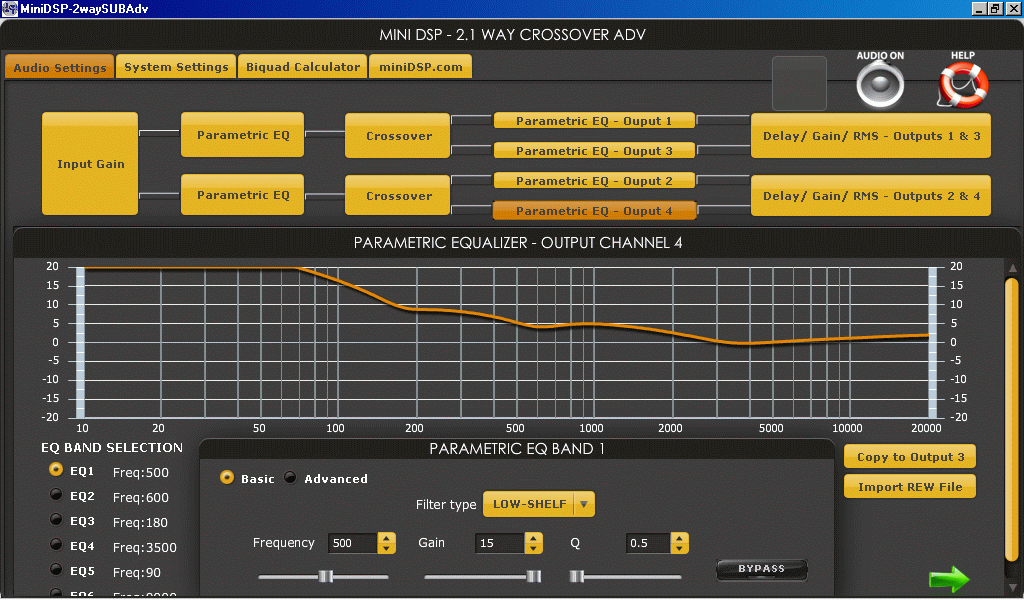

I have implemented a compensation scheme for tiny 2 inch, pipe-based speakers which needs more than 20dB of equalization at low frequencies. This leads to the graph of the Parametric EQ section 'clipping' at +20dB even though the EQ itself works fine. It is apparently a display limitation in the plugin.
One quick and dirty way out would be to implement an attenuator in the Parametric EQ common to outputs 1&3. Is this possible (perhaps with a Biquad?). Else it is possible to change the displayed range on the plugin graphs to -10dB to +30dB (for example)?
Mmmh, well 20dB of EQ is actually a LOT.. :)
Though it may sound fine, it's not impossible (depending on your gain structure) that you could saturate inside the DSP without knowing it... In general, applying that much EQ (on any speaker / DSP or not) is not good idea/typical and that's basically the reason most DSP platform you'll ever see would have a scale similar to the miniDSP (some even capped to +/-15dB).
Hope this clarifies,
DevTeam

First of all, please let us apologize if our earlier message sounded offensive or like if we were looking down on you. That wasn't our intent at all. We were just speaking on a technical aspect (electrical effect of adding 20dB to an amp/DSP 28bit path) and that's all there is to read. :) We're not here to judge how the kits are used as there are indeed many good use our there. We'd love to hear of your utilization for this setup! :)
What we wanted to highlight is the reasoning behind the 20dB scale & why it was capped on the scale to prevent from getting complaints of saturation inside the DSP (e.g. adding many PEQ boost to the same frequency) . If you do a bit of research on fixed point DSP (28bit) and their internal gain structure, I think that it will help understand a bit more of the headroom inside a DSP.
Ultimately, as we said earlier on, it really depend on your gain structure. Providing you're careful at the input and leaving enough headroom you may be fine. You could look into building a gain scaling biquad (i.e. gain linear value in Biquad equations) if you want to scale the whole PEQ down. Not sure it would perform the same effect you're expecting though as it would just be equivalent to simply not boosting the signal that much for each band.
DevTeam
True, but lowering the gain would allow me to visualize better the effect of small changes I am making in the region which is saturated high at the moment.
The headroom is fine - I am using the Analog gain potentiometer as the master gain control, with 0dB out of the source driving the input close to 0dB. Then the 80dB attenuation in stage controlled by the gain pot.
What I was asking about the biquads is this - the last time I designed with a DSP was 1986, and that was a head positioning servo for one of the early 5inch hard drives. So I am not familiar with Biquads - I am still learning how to manipulate the coefficients. I just implemented an LR 24dB lowpass in Biquad, which, to my surprise, worked, and at that point it was easy to work out that a gain biquad would just have B0=gain_coefficient, with all other parameters zero.
