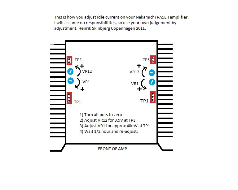

I never found any servicemanual, schematic or adjustment procedure, so I had to reverse engineer the whole shabang and calculate decent standing currents myself.
Note the schematic and adjustments are somewhat different for the other models PA5, PA7 and PA7mkII, so please use this only with PA5EII and maybe the non-european version PA5 mkII.
So I will here share my findings in case someone else will need to adjust his/hers Namaichi PA5EII.
This procedure gives approximately 10mA through drivers Q114+Q115, 115mA through each output-transistor Q116-Q119 and finally 40mA through each CFP-secondstage output-transistor Q120-Q127.
I read about some people who where bumping up the current to gain more class A sound. Eventhough the heatsinks seems to be able to handle it, I will strongly recommend you to keep the original settings. The CFP/sziklai output stage is superstable and seems in perfect symmetry at these settings. But if mess with it, bad things could happen.
Here is how to do it.

slow or low ?
Don't mind the temperature - it doesn't need to be anything specific, and if you play some music with moderate volume the temperature will increase. The temperature is a biproduct of the standing current, and this is the important parameter.
If you have the indicated voltages +50%/-30% at the testpoints, then your amp is working as it should.
...NEW TO HI-FI REPAIRS?
If you are in anyway not absolutely sure what you are doing, then leave it to an experienced technician!
BE AWARE that the above mentioned adjustments must be made in VERY SMALL increments, and with slow movements!
The output is a Sziklai / Complementary Feedback circuit and it is very delicate, so even if you are an experienced technician you should be very careful.
And do not be too obsessed with getting within +/-40% of the values anyway, since it is not always possible.
This is a DIY site, and I will bear no responsibility whatsoever to what you do to own equipment.

slow or low ?
I just noticed what you wrote Don't mind the temperature - it doesn't need to be anything specific
You are clearly wrong about this ....
okay...then please share with me/us what the proper temperature is ?
The lack of public available information about these wondeful amplifiers can be helped if everybody would share what they know or think.
Just for info: What I meant was of course it needs to warm up to a stable temperature, but the main goal is to have some idling current through all transistors, but not too much as the sziklai risks going crazy and smoke will come out.
its a thingy that is planted inside the amplifier probably a twist or perversion of the designer ...look again ....
...are you reffering to the thermonic resistor in the bias circuit?
Please be aware I still only have the schematic from PA-5 / PA-5E downloadable from hifiengine.com - I don't have the MKII schematic.
Since I had the PA5E-MKII for repair I needed to develop my own procedure.
So from this shortened servicemanual that I took the info of 40mA idle per output transistor, and I adjusted the PA5E-MKII for the same adjustment and ran it in my system for while with no problems. So I concluded that it must be okay.
But If you have the information about a specific temperature it should reach then please share.
Hi Craig,
I'm late to the party, that's all. This thread started during a time when I was absent, so it's just now that I saw it.
Set the test point to 40 mV for output bias current. That's a fer sure thing. I can't remember this amplifier having two sets of adjustments for bias. I know for certain that the PA-7 MKII only has one bias set control, and you set that for 40 mV as well. It's important to note that this is the bias setting for only one output transistor. All the others are supposed to share equally. While it has a one ohm emitter resistor which should force them all to share nicely, you still need to make sure the outputs are matched roughly the same beta. If you are servicing one of these, check the current on each transistor (amp in service position). Once you have confirmed they are sharing current properly, you can set the bias.
The heat sink should be warm with the amplifier idling. Each channel should be about the same temperature as well.
These amplifiers are licensed Stassis designs, one of Nelson Pass' creations. I haven't any idea if he is aware of that additional adjustment on the PA5 MKII, but he might have an idea what that adjustment is all about. I don't think he actually designed these amplifiers, but that is another question for him I guess. Generally speaking, these amplifiers are extremely robust. I have only repaired a PA-7 that died because one of those copper box staples fell inside it. The staple did not survive either, in case you were wondering. I have checked a few for proper operation, but just that one for an actual failure. The CA5 and CA7 are really nice preamplifiers too. Just saying.

Since I have been gathering information on the Nak PA amps, I thought I would share this quote from Nelson Pass regarding bias setting on PA5:
"Arrange to get the amplifier some serious ventilation and then raise the
bias until the heat sinks run at 50 deg C after an hour of operation."

..... Thinking that a CFP pair or set will oscillate if biased hard is wrong my estimation is the totally opposite the harder you bias them the more stable they get ....
