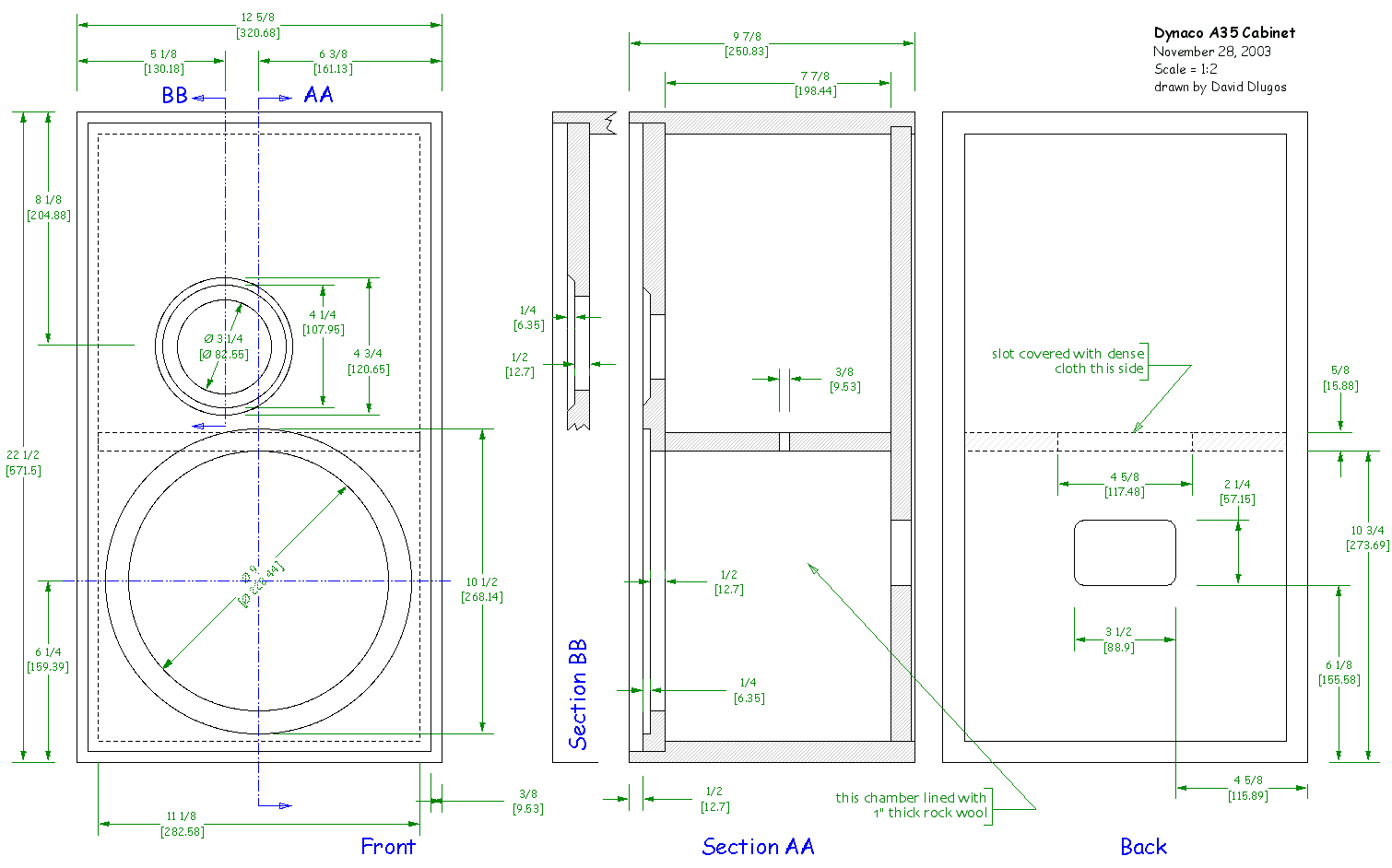

I´ve been doing some sketches of a cabinet in the style of Dynaco a35 today. It looks promising, but I must say I´m skeptical about such a low placement of the drivers. As the second chamber needs to be a bit larger than the one behind the driver, I cannot see a way around that problem.
That said, the center of the tweeter is only 5 cm lower than the center of my full range drivers in my current project, so it might not be an issue.
I'm not sure If I understand you correct here, but could you not arrange the drivers as you like and then make the second chamber behind the first? Sketch would help ;-)
As I´d like to keep the tweeter on top, the only option left would be to have the woofer in the lower chamber (or seriously remodel the cabinet).
Attached is a cabinet drawing of Dynaco a35. The horizontal brace features the aperiodic port, that vents into the upper chamber.
There shouldn't be a awfull lot of work to rearrange the chambers, so that the upper chamber is placed behing the first... I mean if you concider moving the drivers upwards on the baffle, then the original A35 design is altered anyway ;)
