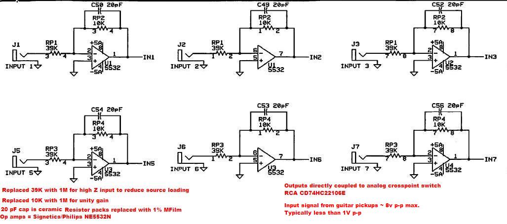

I'm rebuilding a crosspoint switcher for use with guitar pedals and thought this group would have some great insight. The problem is annoying hiss in the output signal of a box that was originally designed for production and studio work in the late '80s. I've re-purposed the unit to switch guitar effects.
Consequently, I'm changing the input from unbalanced low impedance (39K) to unbalanced high impedance (1M).
The power supply = 78xx/79xx regulators. I recently upgraded these with more modern replacements. Hiss is significantly reduced but still there. Would a "finesse regulator" solution help here to further quiet things down?
The audio section consists of a 5532 running as an inverting amp with a gain of .25 and an input Z of 39K. From the 5532, the signal goes to a CMOS analog switch to the output amps (5532 running as inverting amps with a gain of 4 and an output resistor of 47 ohms).
To use with guitar pickups and instrument level signals (100-300 mV), I set the input amps for unity gain with a 1M input and fdbk resistors. For the output amps, what value resistors should I use to set the gain? Should I use low resistance to keep the noise down (10K versus 100K)?

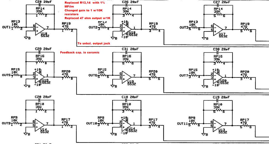

The output amp drives a 1K ohm load resistor instead of the original 47 ohm resistor. Should I go back to a lower value resistor than 1K?

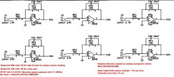

I've attached schematics are for the input and output sections of the unit. Both are very straight fwd., but my electronics knowledge is a little rusty. The only thing between the two amp sections is the analog switch that routes the inputs to the selected outputs.
The changes I've made are in red. Would I benefit from rewiring the DC supply to the input amp section to use +/-18 VDC instead of the existing +/-5 VDC?

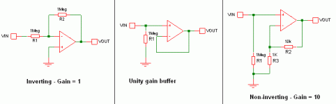

None of them.The Philips 5532 has an "input resistance" of 300K ohms. The "differential input Z" of the 4562 is 30K while the "common mode" input Z is 1000 M ohms. Which is most relevant to my situation?
Lets look at a couple of examples, assuming the input Z values you gave for the 4562 and assuming the opamp has a voltage gain of 10000 i.e. 80dB (at some or other frequency):
First circuit:
Ignoring R1, the input impedance at the input to the opamp itself is 30K in parallel with (R2/gain). Since R2/gain is about 100 Ohms, the 30K doesn't make much difference, the impedance there is about 100 Ohms.
The final input impedance of the whole circuit is R1 in series with that i.e. 1Meg + 100 Ohms. So even the 100 Ohms doesn't matter, input impedance is determined by R1 to several decimal places.
Second circuit:
The input impedance ignoring R1 = (differential input Z * gain) in parallel with common mode input Z = (30K * 10000) in parallel with 1000Meg = 300Meg in parallel with 1000Meg = at least 230Meg, probably closer to 300Meg, depending on phase. So again, the final input impedance is defined by R1 as 1Meg. The 230Meg (or whatever) makes little difference.
Third circuit:
The input impedance ignoring R1 = (differential input Z * gain/11) in parallel with common mode input Z = (30K * 10000 /11) in parallel with 1000Meg = 27Meg in parallel with 1000Meg = at least 26.5Meg. So again, the final input impedance is defined quite accurately by R1 as 1Meg.
Bottom line - you seldom, if ever, need to worry about the input impedance if opamps.
Cheers - Godfrey
