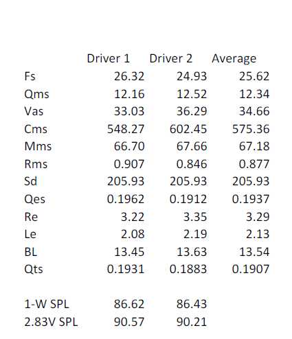

Here are two different sources, you also may want to search this forum:
  • MCM_55_2421_blamus_TS.txt

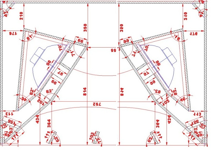

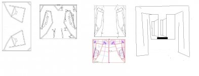

this wil fit in a 400 ltr cab.
haven't tought about a fold yet.
th don't agree much with these mcm.
2 mcm in series
agree... I usually like these in a dual driver cabinet, 8:1 compression, 4-6 liter front compression chamber FLH cabinet.
You 'can' if you are looking for an (under 100 liter per driver cabinet) get a reasonably flat TH response at about 6:1 compression.

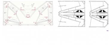

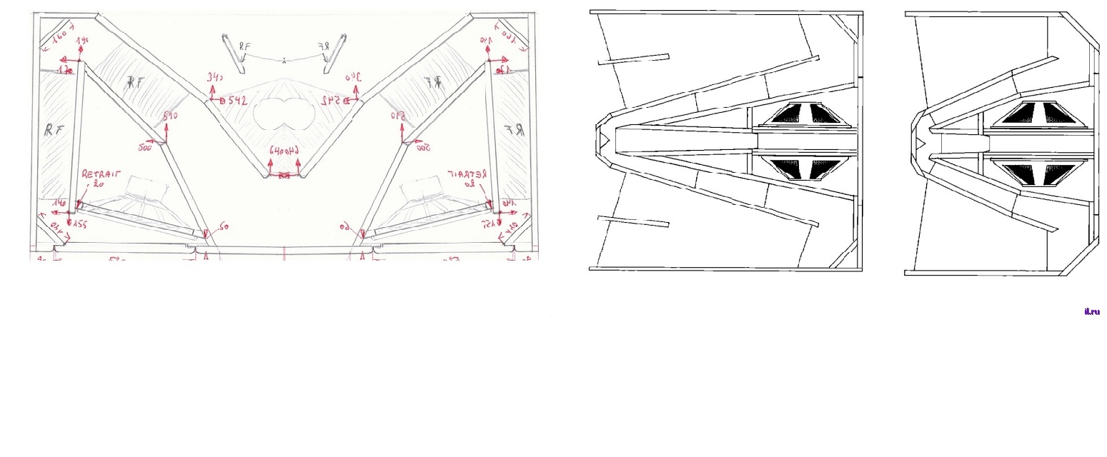

yep, mike and I ping'd on the shop sub... Take a read on where the fold came from...
Mike's a good guy, he and I have traded a bunch of useful info... I blame him for some of my DIY'ness...
The problem I have with most of those folds, is they are about 60hz long at most... If you want a 40hz horn, none of them work well. The fold I came up with on the dual mcm allows 2 tapers in a square box, which is also of interest with the mcm driver.
The front chamber is the 'key' that I found for the mcm, along with 8:1 compression.

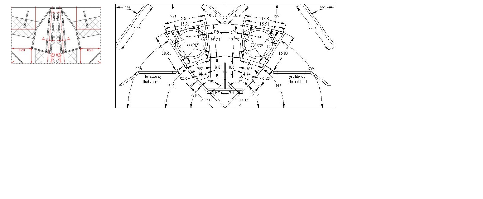

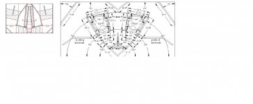

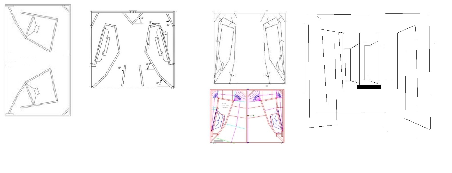

Jbell you are saying that the horn path of the designs I posted are too short for 35hz
Designs from tda audio
lets see if any of these will work
I think I might have missed your question somehow.... Are you wanting to build one of these big boxes as designed for mcm 55-2421's? and put in 8 drivers? (4 in each 18" driver location?)
Or are you looking to these designs as folding inspiration and want to make a smaller version that takes a pair of mcm's? (which is what I assumed)
It would be kinda cool I suppose to have a baby tda running mcm's... but it would take some additional horn folding to make it actually perform correctly once you scale it down from 18" drivers to 8's....
