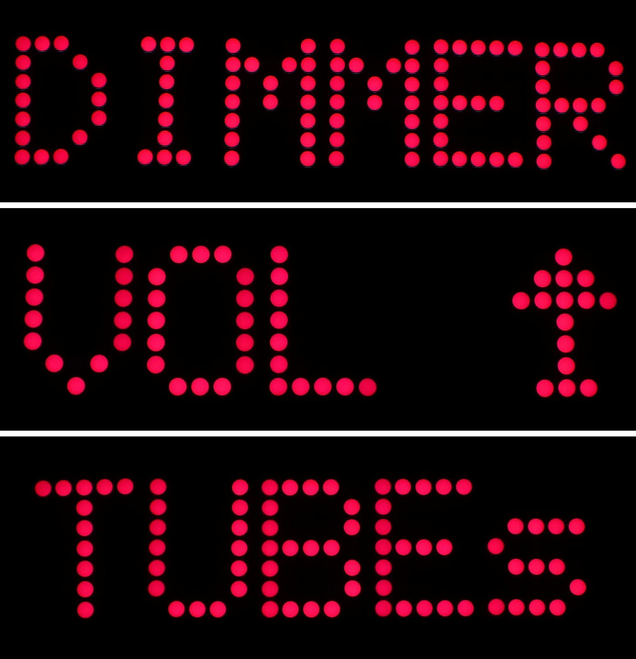

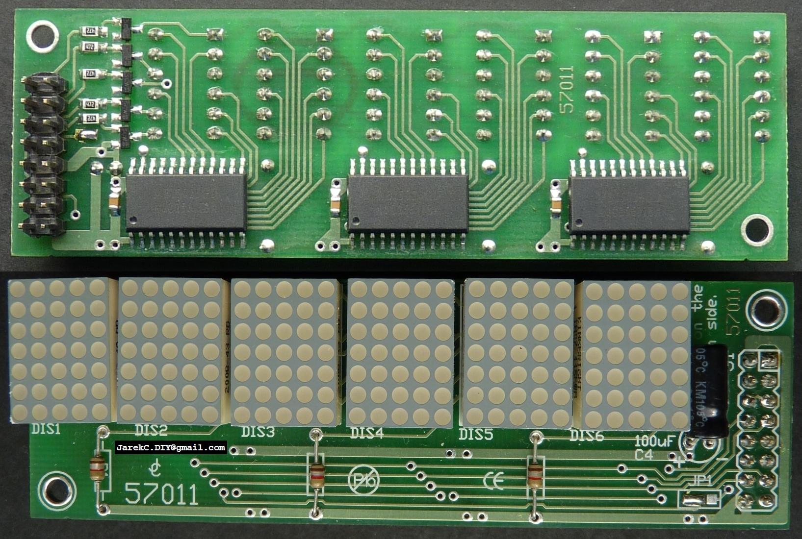

- LED dot matrix display (6 characters, 5x7 dots, 0.7 inches)
- dimmer with 3 programmable levels

- all displayed messages programmable by user

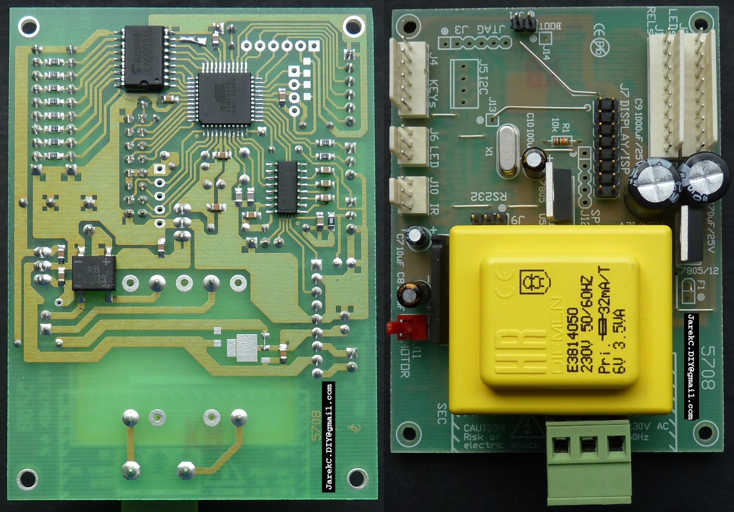

Today schematics and some photos.
Best Regards
JarekC

For SON1,SON2,SOFF1,SOFF2 putting -- on two last positions will display timer.
SIN1 = Input 1 name
SIN2 = Input 2 name
SIN3 = Input 3 name
SIN4 = Input 4 name
SMUTE = Mute
SVOL+ = Volume up
SVOL- = Volume down
SON1 = On Rel1->Rel2 (V_heater->V_anode)
SON2 = On Rel2->Rel3 (V_anode->Speakers)
SOFF3 = Off Rel3->Rel2 (Speakers->V_anode)
SOFF4 = Off Rel2->Rel1 (V_anode->V_heater)
SOON = On Realy4
SOOFF = 0ff Realy4
SDIMM = Dimmer
STUBE = Tube timers
STOT = Controller timer
ST1 = Tube 1 name
ST2 = Tube 2 name
ST3 = Tube 3 name
ST4 = Tube 4 name
ST5 = Tube 5 name
ST6 = Tube 6 name

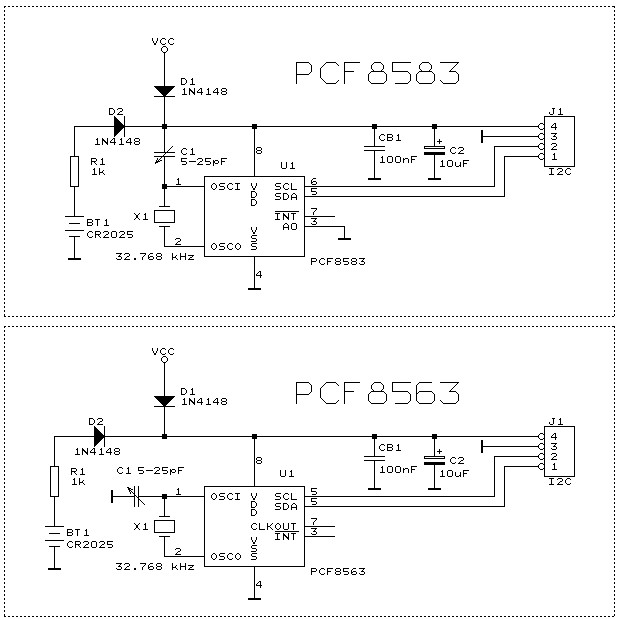

I made a few improvements in firmware and now it is possible to display the current time (in StanBy mode). Time display brightness is controlled by the parameter DC.
Real Time Clock is based on PCF8563 or PCF8583 chips.
RTC is connectet to J5.
Below schematic of required RTC circuit.
I also working on a version for PGA2310/2311 chips (in place of amotorized potentiometr)
Best regards
JarekC
