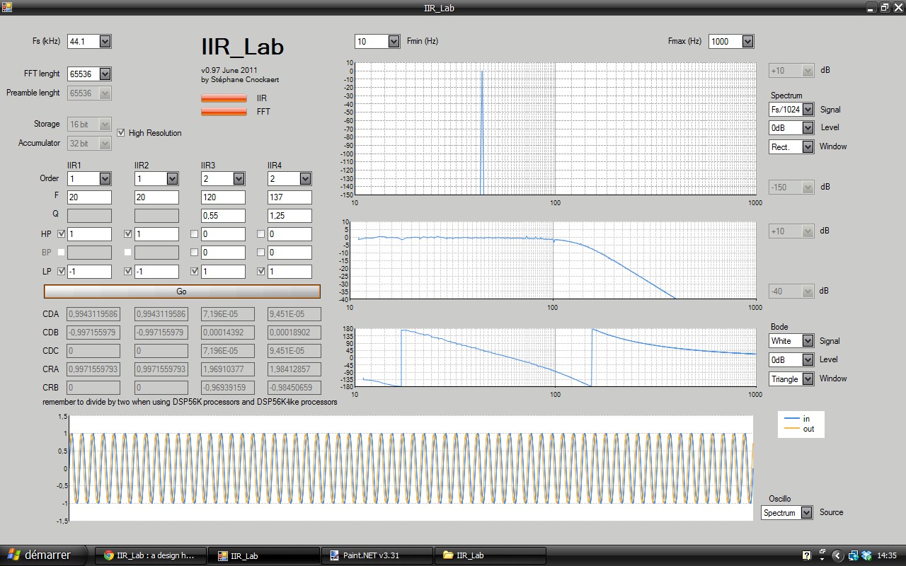

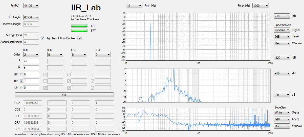

This small application helps you calculating your IIR coefficients basing on an intuitive approach.
First of all, you need to provide the cutoff frequency (say 200 Hz) and the Q (say 0.707). This way the program is able to calculate the retroactive coefficients of the IIR (the resonating cell).
Then you need to specify how much highpass, bandpass and lowpass you want in the transfer function. You can combine the thee elements in any proportions. This enables you to generate all possible 2nd order transfer functions including pure phase shifters (allpass), notches, etc.
The five corresponding coefficients of the IIR get then listed.
Up to four 2nd order IIRs can be cascaded.

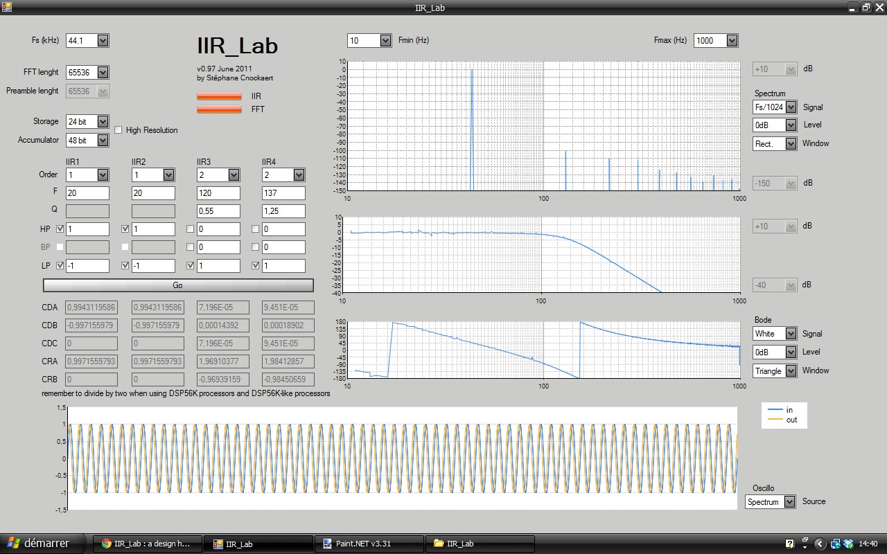

What you get as result is the Bode Plot of the IIR filter cascade. The Bode Plot gets calculated using what you may call the brute force again : a signal gets generated at the input (a white noise), a FFT is then calculated both on this signal and the signal coming out of the cascaded filters. A triangular window is used as default. The comparison between the input signal and the filtered signal gives the Bode Plot, in magnitude and in phase. You can decrease the level of the input signal. More about this below.
What you get also as result is the Spectrum Plot of the output of the filter cascade. In order to get something useful, the input signal is not anymore a white noise, but a sinus having the edges precisely matched to the sampling window. The frequency can thus be 1/256 of Fs, or 1/512 of Fs and so on. Using such trick, we meet the periodicity criterion and as a consequence the spectrum comes out without any sidebands or other transients effects. This feature enables a rectangular window to be used, and such rectangular window is used by default.
Here again you can decrease the level of the input signal. When decreasing the signal level to, say, -70 dB, and if using a 16 bit data and a 32 bit accumulator, you quickly realize how the dynamic range gets limited. The harmonics are quite present. Below a certain threshold the signal vanishes. Sometimes depending on the filters setting and input signal amplitude and shape, you may get a DC offset that mutates into a triangular wave (say at -60 dB), like the filter turned into a very low frequency oscillator.
You then realize that adding some dither may help preventing the filter getting crazy.

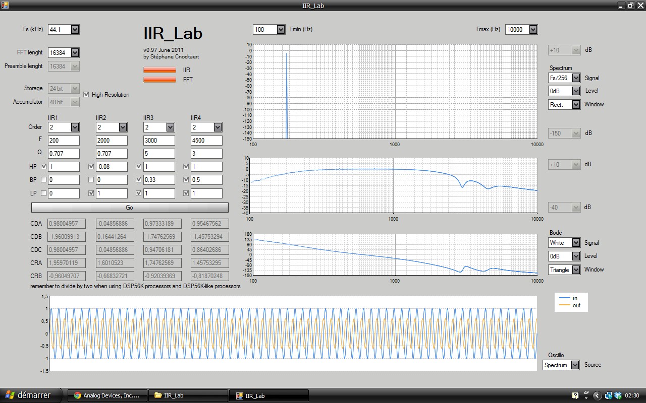

Fiddling with the parameters, you may discover that other configurations like the 24 bit storage and 48 bit accumulator are not completely free of artefacts of this sort when using 2nd order IIRs having a cutoff frequency below 60 Hz or so.
There is also an oscilloscope view. You can view the time evolution of the above signals. The oscilloscope view allows you to see the effects of the finite quantization at the very low levels like -90 dB or so.

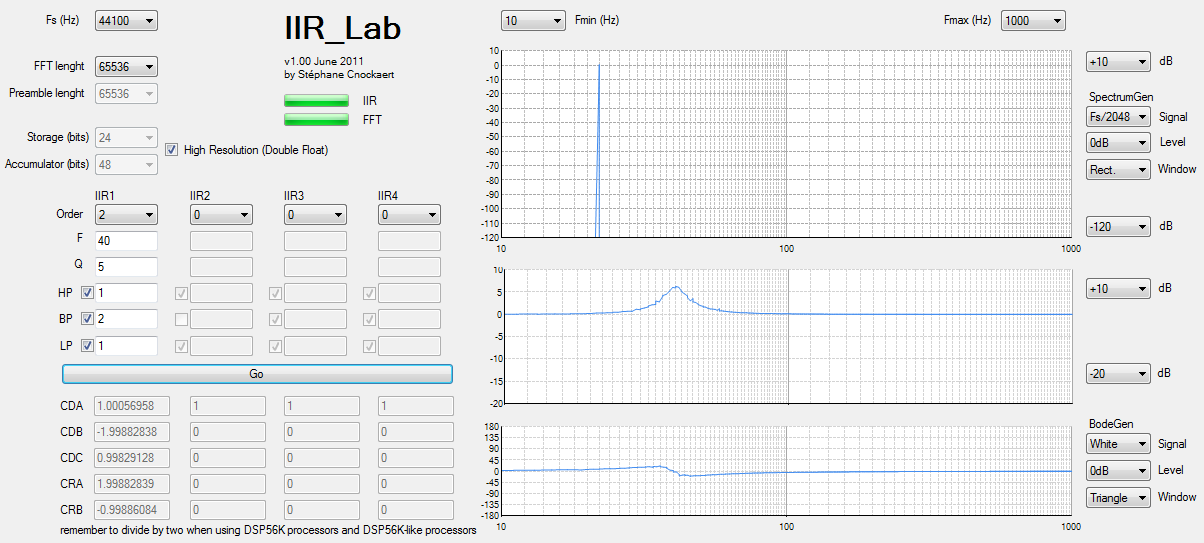

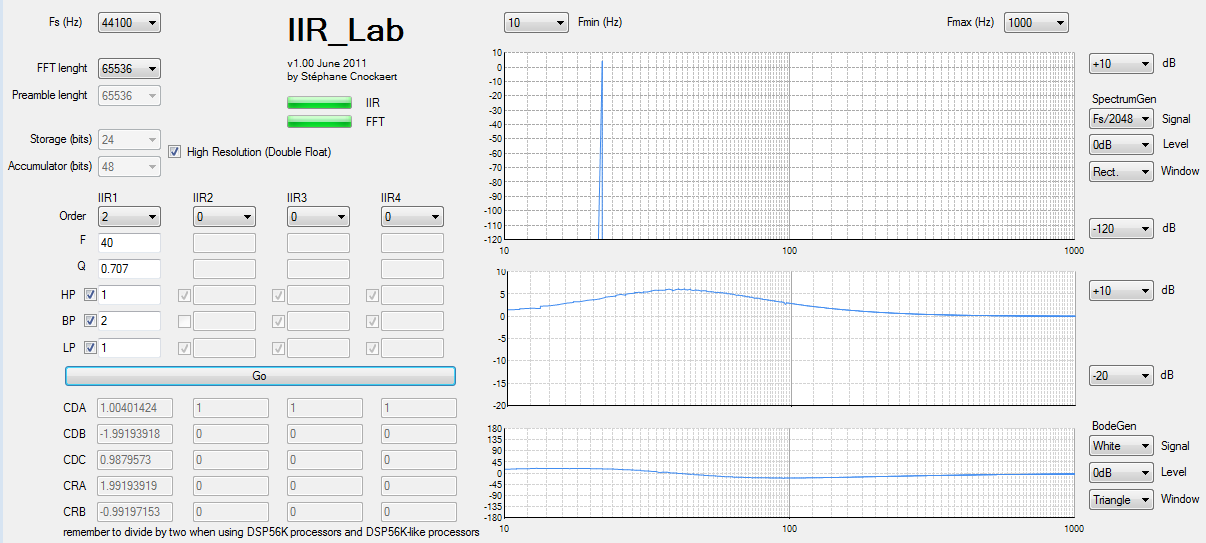

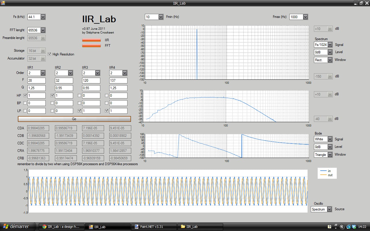

An interesting case study is a very low frequency highpass filter, 2nd order, say 25 Hz, with a Q of 0.707 or so. You may need such highpass as infra-bass protection, and/or if you intend to build a digital Linkwitz transform filter, aka deep bass flattener. If you look to the IIR coefficients, you'll see how much it was needed to attenuate the input signal before it reaches the resonating cell. Indeed, the non-recursive (direct) coefficients (CDA, CDB, CDC) have very small values, less than 1/1000. Consequently, the accumulator gets as input 1/1000th or so of the original input data. Following this you get the huge gain buildup caused by the retroactive coefficients (CRA, CRB). The situation is not as bad as it may appear, thanks to the accumulator being far more precise than the data (48 bits instead of 24 bits), able to compute and retain 48 decimals. But unfortunately, as soon as the signal escapes the accumulator, all the tiny decimal bits get discarded. Only the 24 first decimals get stored, making the intermediate storages for the delay cells.
This means that when using a DSP56K architecture (24 bit storage and 48 bit accumulator), one should use an enhanced-precision arrangement when implementing 2nd order IIRs operating below 60 Hz or so. The storages should thus be wider than 24 bits, say 48 bits or so.

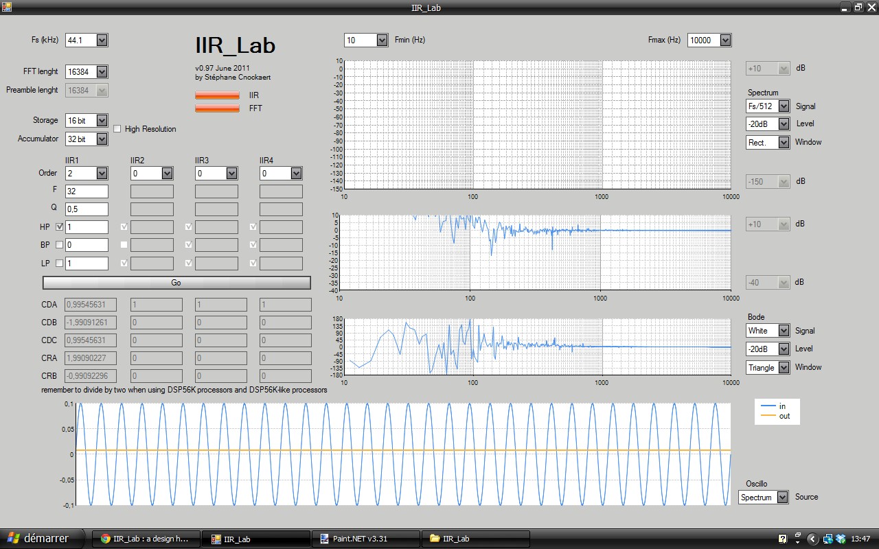

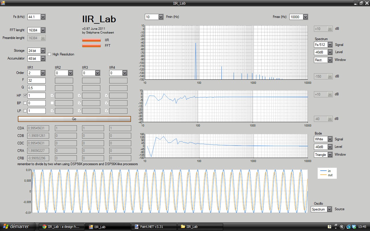

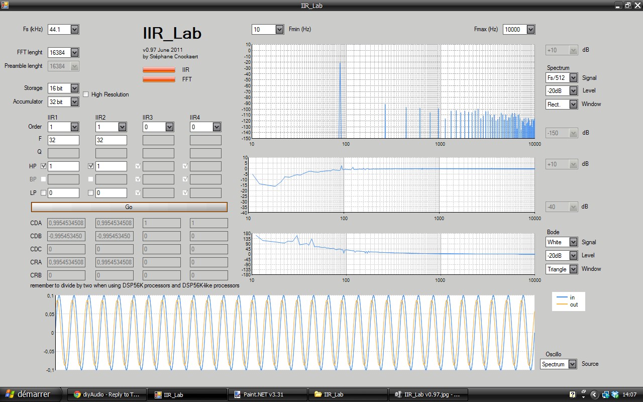

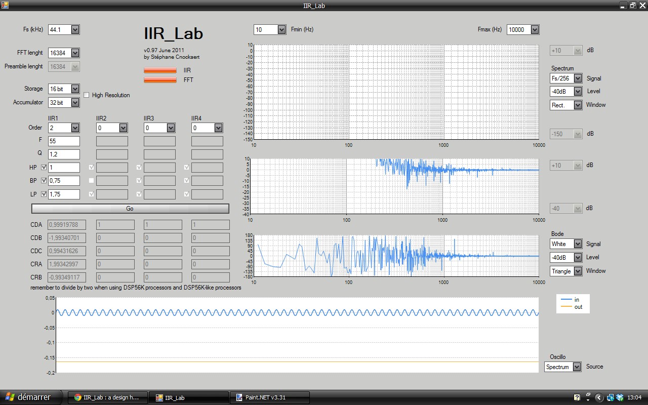

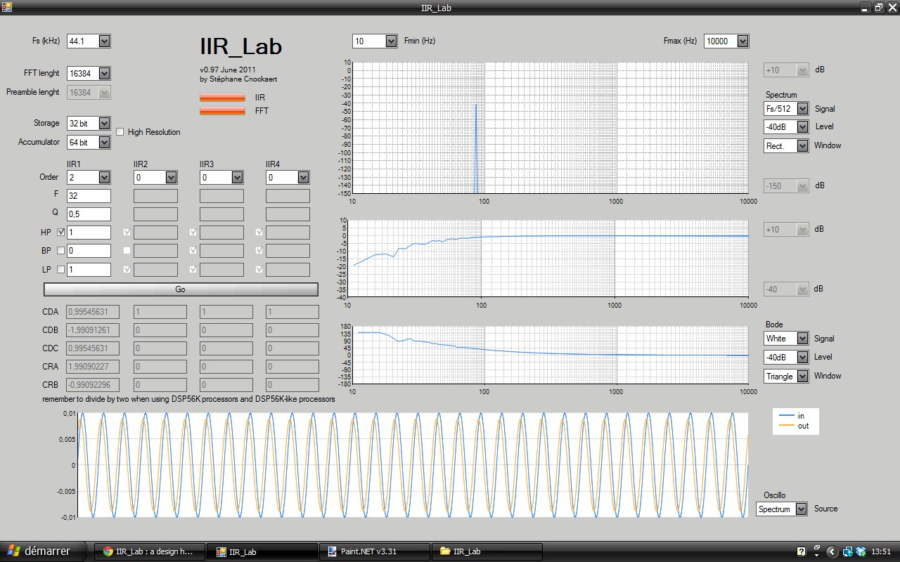

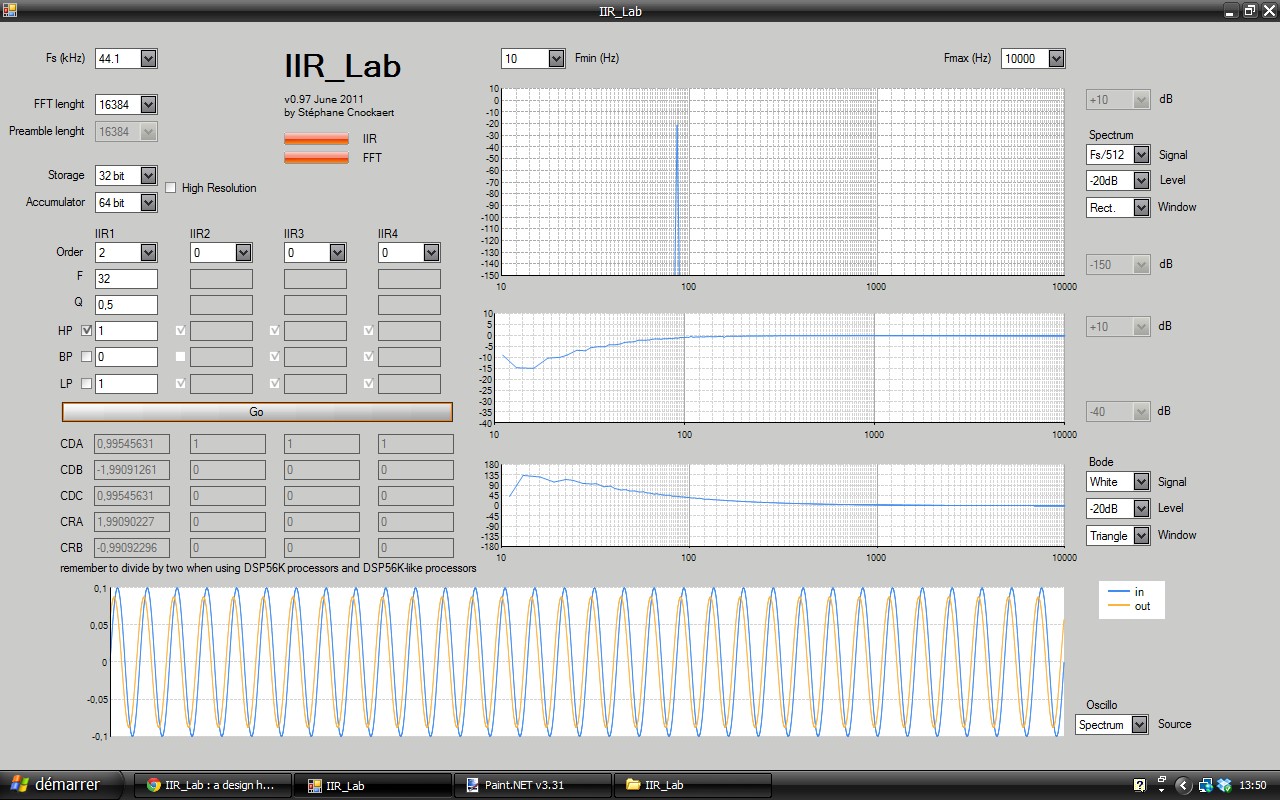

Here is the Linkwitz transform example (aka deep bass flattener). See the attached .jpg files.
16-bit storage & 32-bit acc arrangement
Note the many harmonics when inputting the -20 dB signal.
Note how the output signal vanishes when inputting the at -40dB signal. Massive DC buildup is taking place here with a -0.15 Volt DC output referred to 1.00 Volt full scale. Viewing the same output using a much longer timebase may show that we get a very low frequency oscillation at such high amplitude.

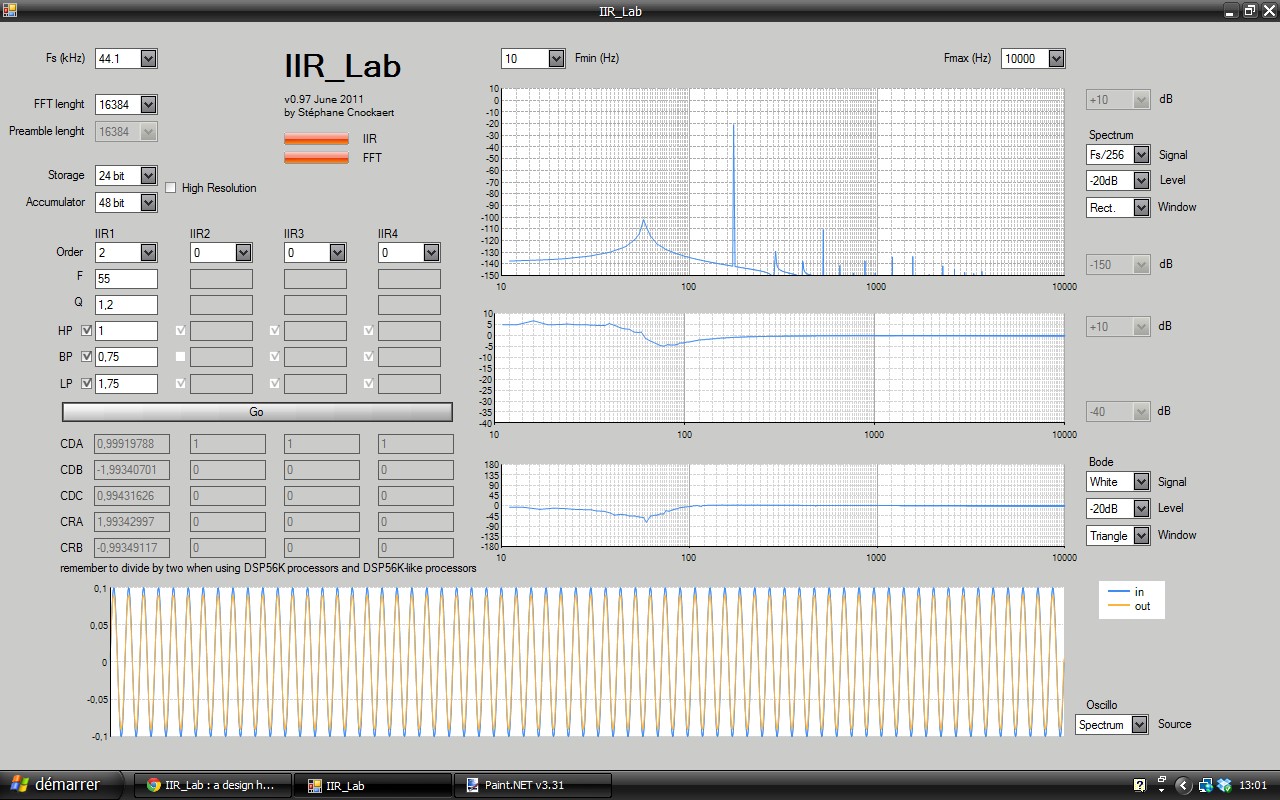

24-bit storage & 48-bit acc arrangement
Note the presence of some artefacts. They however remain below -100dB.
Note how bumpy the transfer function (Bode plot) becomes when inputting the -40dB signal. Compare with the transfer function when inputting the -20dB signal.
32-bit storage & 64-bit acc arrangement
Note how clean the output is. The output remains nice and clean even when inputting the -40 dB signal. The transfer function (Bode plot) remains consistent.
Steph

Linkwitz transform 16-bit storage & 32-bit acc (-20 dB in).jpg272.4 KB · Views: 451
Linkwitz transform 16-bit storage & 32-bit acc (-40 dB in).jpg243.2 KB · Views: 421

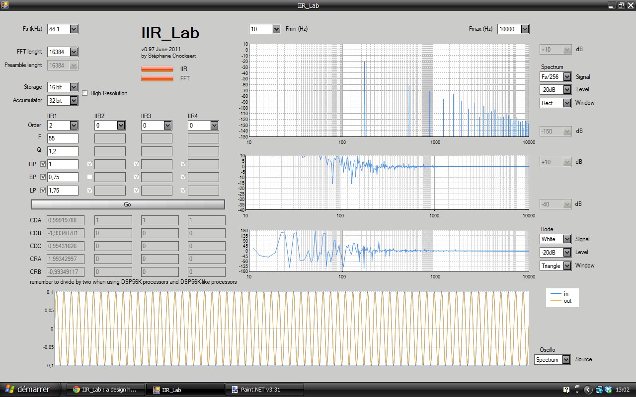

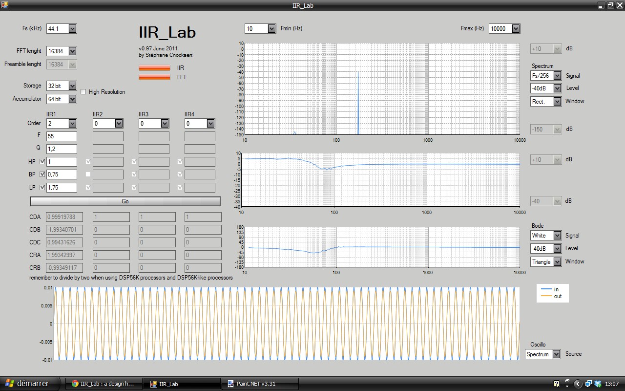

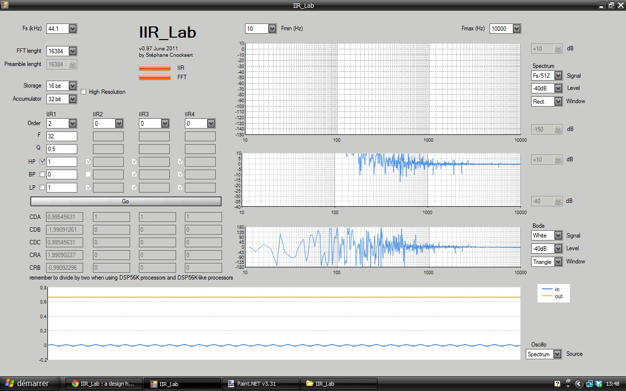

Here is the 2nd order Bessel highpass example (aka deep bass protector). See the attached .jpg files.
Note how the output signal vanishes when inputting the -20 dB signal and the -40dB signal. Massive DC buildup taking place. Viewing the same output using a much longer timebase may show that we get a very low frequency oscillation at such high amplitude.
Steph

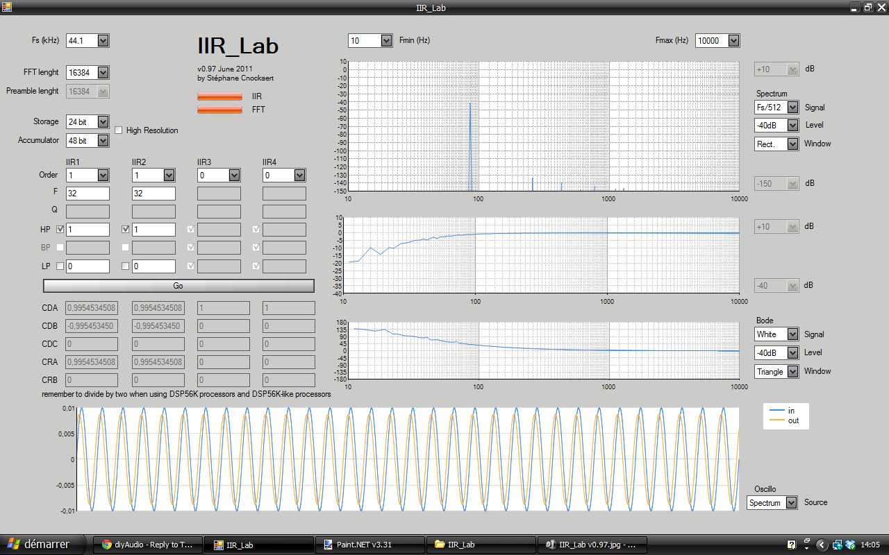

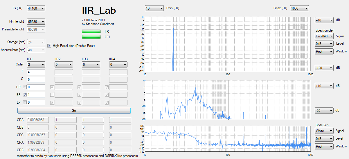

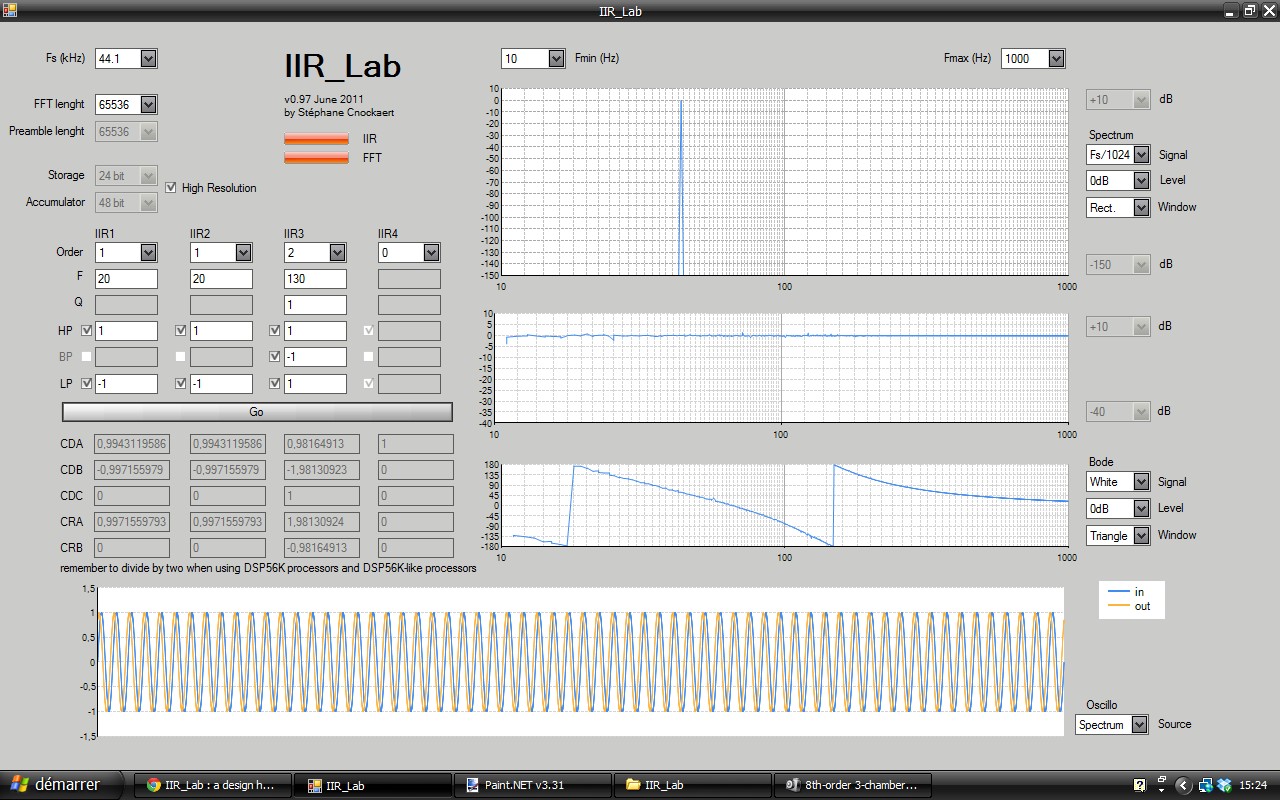

Is it smarter to use two cascaded 1st order highpass as deep bass protector, instead of one 2nd order Bessel highpass ?
Yes indeed. Even the 16-bit storage & 32-bit accumulator combination get a new life using this approach. And the 16-bit storage & 32-bit accumulator combination is delivering near-perfect results. See the attached .jpg files.
Steph

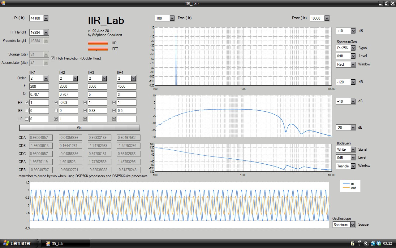

Here, a few design ideas using a 8th-order Bose 3-chamber subwoofer.
Note how DSP enables tracking the subwoofer phase response.
We get an all pass filter having the same phase and module response as the subwoofer, between 50 Hz and 1000 Hz. This may be used in a substractive crossover like the Lipshitz-Vanderkooy phase-compensated. Kind of generalized Linkwitz-Riley.
We also can get a lowpass filter having the same phase and module response as the subwoofer, between 50 Hz and 1000 Hz. This may be used in a substractive crossover like the Lipshitz-Vanderkooy propagation delay-compensated. The big advantage is the accurate global phase. If you put a squarewave in, you get a squarewave out. Is this commercially available ?
Steph

I ran a few cases with the biquad cascades I tend to use and found the noise floor on 32 bit storage with 32 bit accumulation is consistently -140dB or better. I'm not aware of any DACs which can compete with this, though there are a couple op amps that come close.
How do you go about measuring the noise floor? Estimate it from an FFT or some other method?
Yep, FFT estimate. IIR Lab displays the floor in its upper right graph, though most numerical configurations require selecting a lower bound smaller than the default of -120dB to see it. Provided you choose one of the Fs/2^n stimulus frequencies to get round the window, anyway---with other frequencies you'll just get the window's sideband level (unless the arithmetic's truly atrocious).
The blend occurs thanks to the non-recursive coefficients. In IIR_Lab, define four IIRs (IIR1, IIR2, IIR3, IIR4) having the same F and Q. Play with their HP, BP, LP factors and observe how the CDA, CDB and CDC coefficients get modified. Observe how the CRA and CRB coefficients remain the same. In IIR_Lab, the four IIRs get connected in series. Your PEQ (parametric equalizer) is thus a series one, not a "parallel" one that you may find in "graphic" equalizers, those last ones needing to fiddle with Q.Steph, can you explain a bit more as to how the HP, BP, and LP quantities are blended? I do quite a bit with peaking EQ patches and, while HP = 1, 0.1 < BP < 10, LP = 1, produces peaking EQ I'm seeing more signs of numerical issues for filters centered at low normalized frequencies than I'd expect for double precision floats. It's probable this is just the relatively limited FFT length and window selection---any chance of a drop with 256k+ points and a Hanning or Kaiser window?
I tried to reproduce your low frequency PEQ at 30 Hz Q=0.707 with HP = 1, 0.1 < BP < 10, LP = 1. On my side, the SpectrumGen plot doesn't exhibit distorsion using the High Resolution (Double Float). FFT size 65536 and test signal Fs/2048. SpectrumPlot from 10 Hz to 1000 Hz, Rect. Window. The corresponding BodeGen is clean (+20db to -20dB), Triangle Window, which means that the 65536 FFT size remains adequate. If you switch to 24 bit storage and 56 bit Acc, you get a -90 dB H2 distorsion, -98dB H3 distorsion on a 0dB signal. This being said, I agree that for the BodeGen plot, using a more elaborate window like Hanning or Kaiser could deliver cleaner plots, minimizing the disturbance caused by the non-periodic nature of the test signal, which is a white noise in case of the BodeGen plot.
I just did an install on a fresh computer, a HP DM1-4033SF having a 1366x768 screen, running Windows 7. Like you wrote, the install automatically triggered a fresh .net client download, quite annoying. Like you wrote, there was a security warning asking for the IIR_Lab install confirmation. Regarding the screen size, I wrote IIR_Lab on a WinXP laptop equipped with a 1280x800 screen. Next time I modify IIR_Lab, I'll remember to fit it on a Win 7 computer hooked on a 1366x768 screen, and possibly also a 1280x720 screen using scroll bars.FWIW, install of 1.0.0.23 went smoothly on my Win7 laptop with non-admin login; prompts for elevation at all the right places. It did spend a while doing something with .NET 4 client profile install even though full .NET 4 was already installed---I think the the detection of the existing install was probably just slow. A small feature suggestion if you happen to revisit this: a vertical scroll bar for the UI and better detection of the task bar would be nice. My screen's 768 pixels high so the bottom of the graph gets chopped off after resizing IIR Lab's window so its lower portion isn't hidden behind the task bar.
Hmm, wiggles should be visible at Q = sqrt(2)/2. They get worse at higher Q. Attaching a few screen grabs from IIR lab on my side. I also found if I uncheck the BP box I get an even more ragged notch filter. And if I uncheck HP and LP in the Q = 5 example I get a different BP response each time I hit the go button. Having looked at this more I am thinking perhaps the white Bode gen option is actually random rather than using a delta function and the result is errors in the Bode display due to the noise not averaging to zero at low normalized frequencies.
