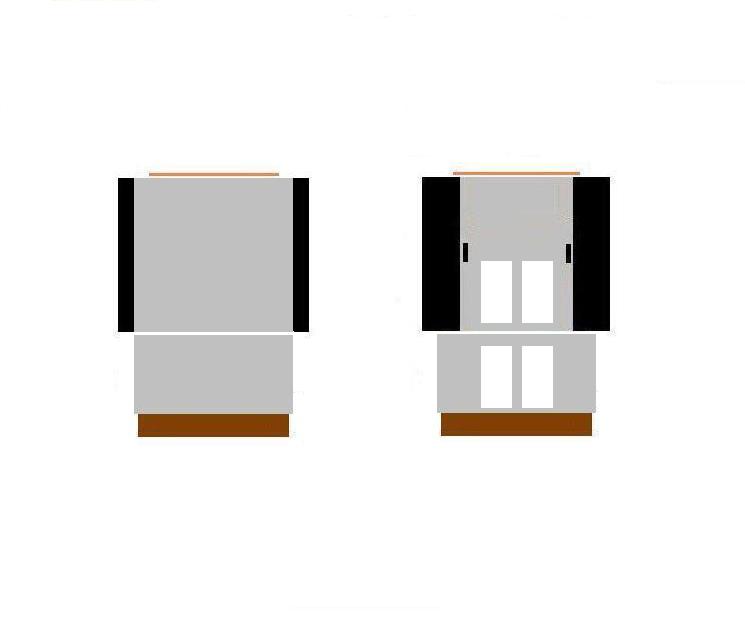

However I am largely headed the other way, separating out power supplies,
output stages, and front end circuits into separate pieces so that they can
be mixed and matched at will. While it results in many more boxes, it
gives me a playing field to easily listen to the differences in component
sub-circuits and refine them while keeping other elements constant.
But then that's me. Someone else will likely be happy to integrate
components so as to make life easier for customers.
I think that is an outstanding idea!
But how do you keep grounding (loops, etc..) from becoming an issue?
easy peasy
all metal boxes must be safety earth-ed
rest is simple
