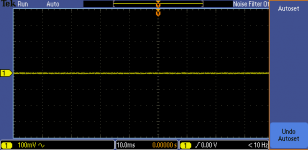

Well SoNic_real_one. Have you a clue about how these power supplies are? Just great! Maybe you can share your clue with us ...
Anyway, a power supply witch run their filter capacitors hot because of an internal hi ripple current, caused by a unprofessional design, is very wrong! And a shame too for a such name as Oppo...
BTW, what I state in my comment is supported by facts. Just measure an see your self on the audio board. I know well what I`m saying/writing!
Else, the statement you refer about the 25/27 Mhz clock is not mine... There is true that on the boards are many clocks. I do not care about these. I care about the clock witch is involved in audio stage. This is I`m talking about.
I`m not a hobby modder who want to mod only for fun. But I want that things (witch I pay quite much money for...) works correctly. I get frustrated when I see that a sold hi end product suffer of primary/elementary design faults. Oppo could run self a research, consult some professionals in design of electronics, before lunch their last player. Is not enough that a player sounds well enough. One have to get the most of that product witch incorporate the best in today components... In my opinion a well designed product, when is using the last/top electronics components available, can sound exceptional. BDP95 can this! Only some details (like for example a well designed serial power supply, and a more accurate power distribution to the boards/components) can bring much more to the same product. And unfortunately is not only the power supply problem in this player.... For example, long traces (50-100 mm) from the main oscillator/clock to the target chip is quite unknown in the electronic design. It is elementary that these traces have to be as short as possible... Well, not for Oppo... The main clock on the audio board (54 Mhz) run his output on very long traces. A well designed antenna for this oscillator! I just had to use a mini coax from the clock to the ESS9018. One can also hear the difference...
For not say more about the heat sink for the main processor... I can see that the designers of the main digital board, had an idea about a right heat sink for the processor. The electronics components were placed right on the board for the use of a such good radiator. But was never installed in that place. It was used a ordinary steel plate with a thermal guider compound... I mounted on that processor one heat sink from an old computer processor. I had so a better picture with exceptional details... Just simple, just immediate results...
But I can understand that the main line was for Oppo to come out with an under 1000$ best as possible player. Well, they quite succeed... Just for 100 bucks more could be the best player ever...
