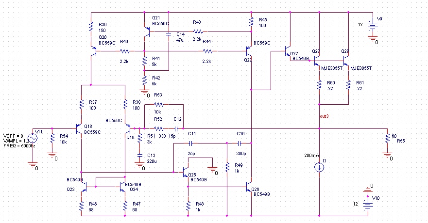

Hey guys,
just got a pair of AKG K701's which sound great but are a little lacking in absolute volume when driven by my sources (mostly PC soundcard), so I'm going to build an amp for them. Going for extremely low distortion and decided to go single ended class-A because I could. Won't be portable due to power consumption, but if it was made push-pull and the quiescent current was reduced a bit it might be practical.
Replace output transistors with whatever you like, I'm just using these because I have them. Paralleling them probably isn't necessary, I'm just doing it to ensure against and beta droop induced distortion (however unlikely that is at these low levels of current).
Also use whatever CCS for the output stage you like, I'll either go discrete ring type or more likely LM317 as CCS.
This will be powered by bipolar LM317 regulated 12v rails.
Spice gives promisingly low distortion figures.
Any thoughts on this design? Based around a D. Self type front end.

Hey thanks for the reply,
Where do you think a bootstrap is necessary? On the input?
The series miller comp caps are twin pole compensation; it's what I'm using right now on my class B 130 Watt power amp and it seems to work perfectly.
When I make the PCB I'll include provision for the second output device, if sharing is an issue I'll either increase the emittor resistors or remove the second device as at these power levels its obviously not strictly necessary unless I decide to significantly increase the quiescent current.
Hi mnturner
A bootstrap is typically applied to the output as in 5.22 (b) of the following diagram which is what I pictured when I viewed your schematic. Its purpose is to traditionally increase AC swing, however as you are only driving headphones increased output swing may not be necessary, A bootstrap might alleviate the need for the second output device and the problems that go along with current sharing
using a second device.
I would concentrate rather researching possible benefits of properties of a bootstrap lowering distortion, Cheers / Chris

I built a low power amp almost identical to this, but with a conventional darlington output. I went with a lower feedback network impedance and a few other values differed slightly, but the performance was first rate and distortion numbers generally under .001% across the audio band. The key to achieving those numbers in the real physical design has a lot to do with how/where you ground various parts of the circuit. My transistor compliment was MPSA56 and MPSA05 for the small stuff, and output darlingtons consisting of 2N2218+TIP32A and 2N4037+TIP31A. It ran on +/- 18VDC. (I'd dump the 3055s in a heartbeat!)
Sounds like complementary feedback pair or Sizklai pairs (or however you spell that guy's name). That's my preferred output stage topology, I've used it in a couple of class B power amps.
Did your headphone amp use complementary devices with a bias setting?
I thought about that but in this design I've just used the single ended output because it avoids having to use a Vbias transistor etc. to simplify PCB layout at the expense of efficiency.
I have a feeling using only one polarity of output device with a constant current load to set the quiescent current might possible be more linear too, but I'm not sure about that and spice sims haven't shown much difference either way.

Hi
Schematic shows input + op amp, also serving as signal input as grounding !
I suspect you meant to have an inverting op amp arrangement where signal input is to neg of op amp, then op amp + grounding and feedback returning to inverting input via a pole.
Cheers/ Chris
Mnturner, we seem to have tread the same ground. Ignoring the errors in the schematic, I've built this same circuit for headphone use, but with a power MOSFET device and better opamp. I've posted it here previously to mostly laughs and derision. Some interesting things happen in that circuit, especially if you use a MOSFET. The output of the opamp operates at the gate turn-on voltage of the MOSFET, so it doesn't pass through zero until the level gets up higher, so for small signals there's no crossover in the opamp. I used another MOSFET with fixed gate voltage for the current sink, rather than an IC, but either works. A large heat sink is essential because there's no temperature compensation and below a certain current MOSFETS are positive just like a BJT (depending on type). I ran a hefty enough bias that I could also drive speakers at moderate levels. I'm not a big believer in "amplifier sound" but I think this design sounded incredibly good compared to anything else I've ever plugged phones into.
I actually did build it in non-inverting configuration (for no particular reason), there is no pole in the feedback loop; gain compensation comes from the cap from opamp output to -ve input (without which it oscillates). There's a little ringing on square wave which will be minimized i think by adding a small lead cap across the feedback resistor.
Yeah in this build with bipolar outputs the opamp's outputs sit at about 1v dc; the output transistor's Vbe + the voltage drop across the 1000 ohm base resistors, so the opamp is in class A up to that point.
I like the principle of this design, it would beat the he'll out of those single MOSFET buffer amps people seem crazy about at the moment. Needs no output cap and the output stage (which is already quite linear) is enclosed within the opamp's feedback loop, so essentially you end up with only the distortion of the opamp.
I have some irf switching fets, I might try them out at some point.
I built mine with a 5534, but today I'd try a National LME opamp. The fets I used were IRF530 because those were what I had a few of. This was at least 15 years ago, so there must be better parts. I'll look for the schematic this weekend and post it if I can find it. Maybe my blameless design too. It would be interesting if somebody wanted to simulate it, since I know what it actually does in real life if properly constructed.
