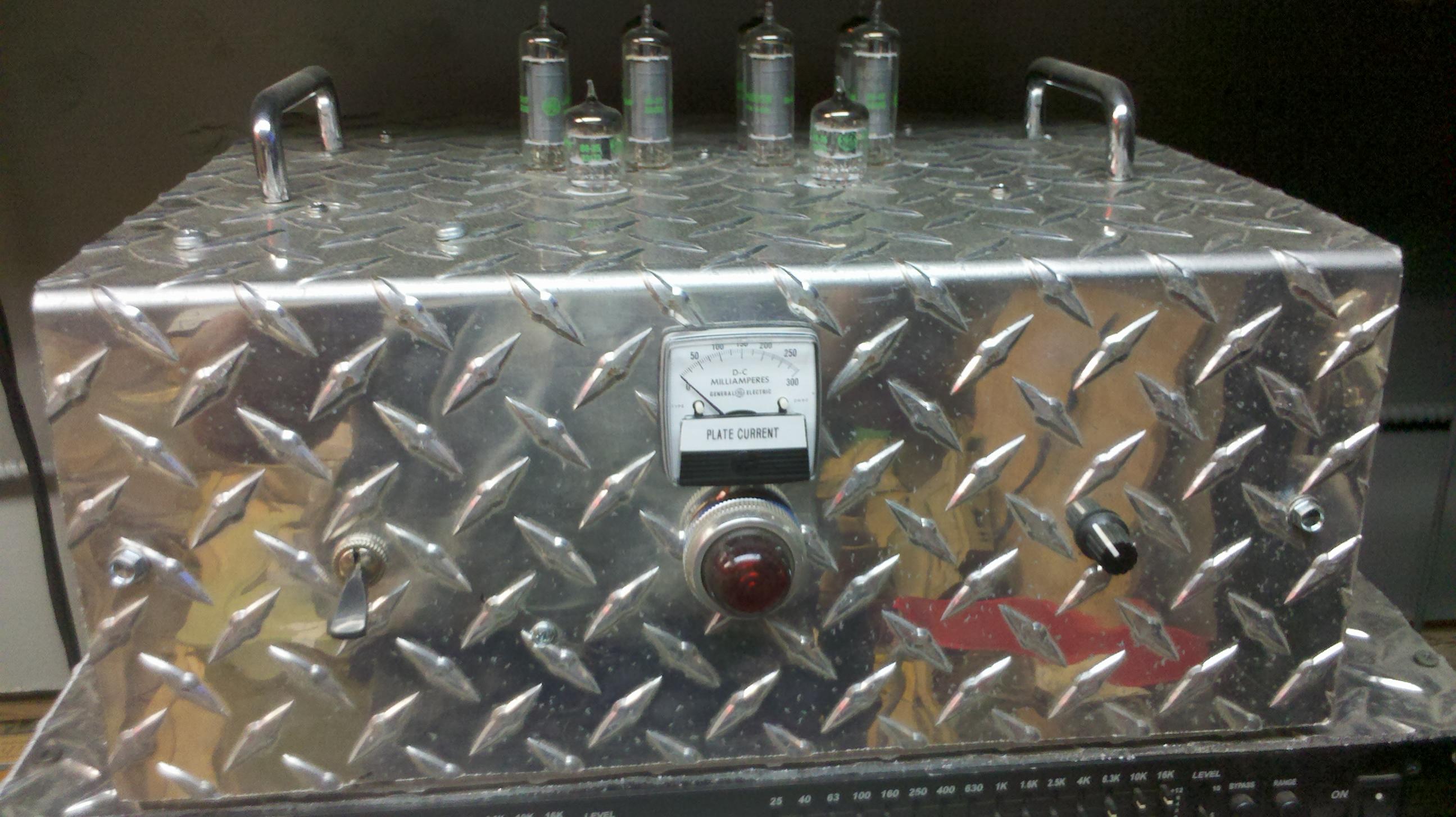

Just an update, I finished the tube rectifier mod on my 16ls kit and it rocks! I ended up using 2 6by5ga tubes in parallel and 2 diodes. After plugging in the tubes I held a nervous finger on the power switch and then said "The hell with it, that's what circuit breakers and fuses are for!" I closed the switch and was amazed by how quiet this amp has become. Befor the mod I could hear some switching noise and a faint hum but they are all gone now. I was able to keep the stock power tranny in service to provide the B+ and heater voltage to the 5670's and 6005's. I added a separate filament tranny to light the 6by5ga's. The increased voltage drop from the tube rectifiers is not at all noticeable, in fact I think this amp has a better and smoother sound quality with a little less B+. I kept the stock crc setup mostly in place but I yanked the 220uf first cap and replaced it with some vintage Aerovox dry electrolytics totalling 30uf and I put 3K ohms in parallel with the 470 ohm resistor to bring the resistance down a bit to compensate for some of the volt drop. I have never heard of anyone doing tube rectification in one of these kits but I highly recommend it. Aside from the obvoius sonic benefits, the two big bottles in the back really look cool!

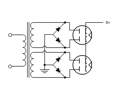

I did not want to start a new thread just for this, so,
I have a PT with two 300V secondaries and want to use two 6BY5GA in parallel.
Can I connect them like this, or is it better or just as good to parallel the two 300V secondaries and then parallel the 6BY5GAs and use only 2 diodes?
The series limiting resistors are not shown on the drawing.
