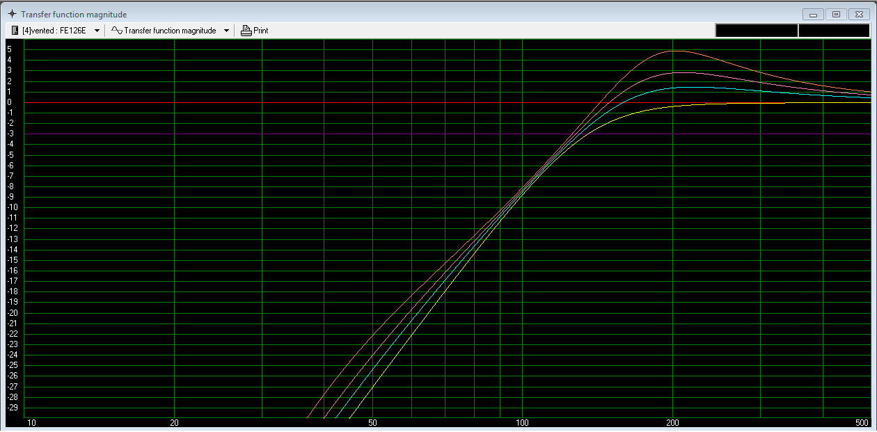

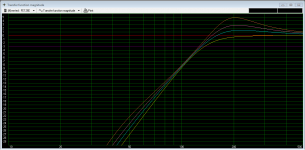

For a constant voltage, doubling the series resistance will half the current flow.
For amusement, fire up winISD pro, look under the "signal" tab, you can add series resistance. Lets see how much alignments change...
Substantially is the short answer Chris. For example, using the factory parameters of an FE126E (they're fictional, but serve), Q rises from a nominal 0.247 to a rather more substantial 0.466. The effect upon the basic box alignment / FR in your favourite WinISD Pro Alpha is fairly obvious, as you can see in the attached.
Using the aforementioned FE126E with factory parameters, here's what started out as a 4th order (QB3 if you prefer) box alignment, shown in yellow, with the usual 0.1ohms series resistance WinISD assumes to account for wire, contact losses etc. Blue = 2ohms series resistance applied, pink = 4ohms, orange = 8ohms.
