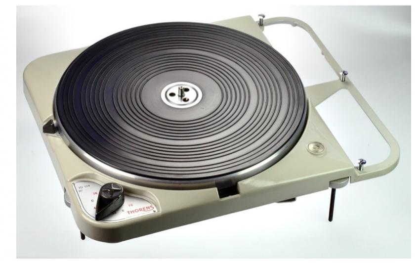

I had been searching for a td160 and rebuild a dual CS16. I did read Kevins threat and decided that for now I will spend some more money and buy one of those great vintige turn table designs.
Top on the list TD124, second Garrard 401 and third Garrard 301.
To my surprise I managed to buy a td124 in visual top condition all ready serviced.
It came in yester day it looks super as for beying older then 42 years I am 43 years and also look yust as new as the td124 .
The service job on the TT wasn't more that a dusting one I believe I see a defective capacitor of 10nF it is become thicker like we all do when we grow older so he can't help it. And it just can not reach the right max-speed. I already did some eddy-current break adjustment it isn't enough jet. Maybe the idle wheel is worn-down in diameter.

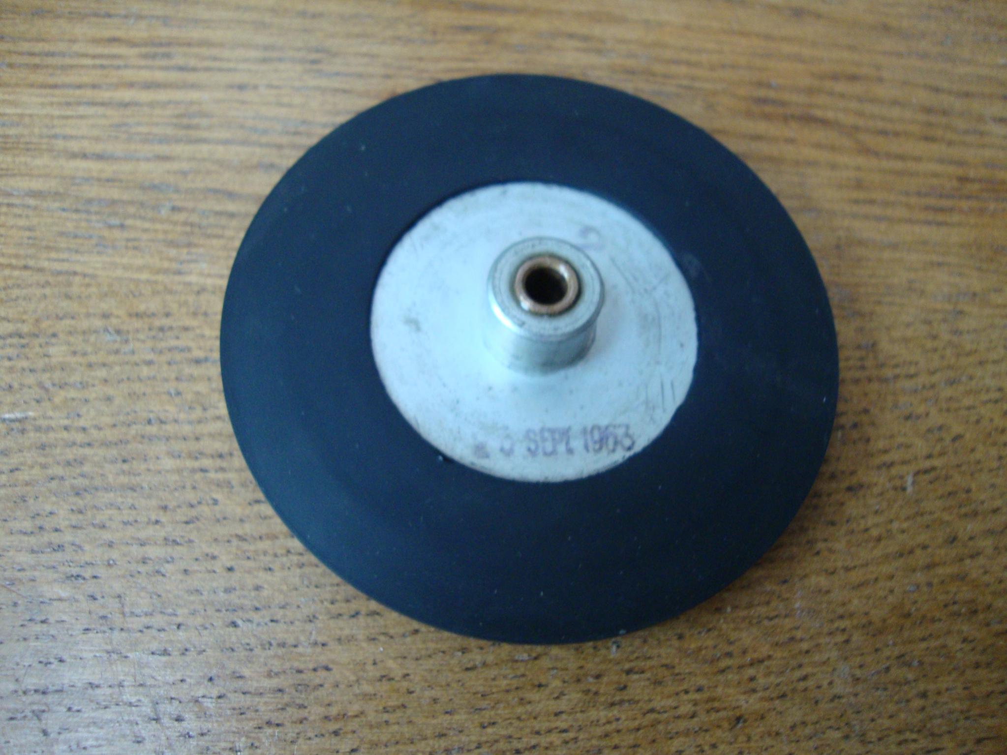

When cleaning the top of the turntable the rubber-plate was made black whit some black polish to look new I removed it right away. Without it look nice semi-gloss.

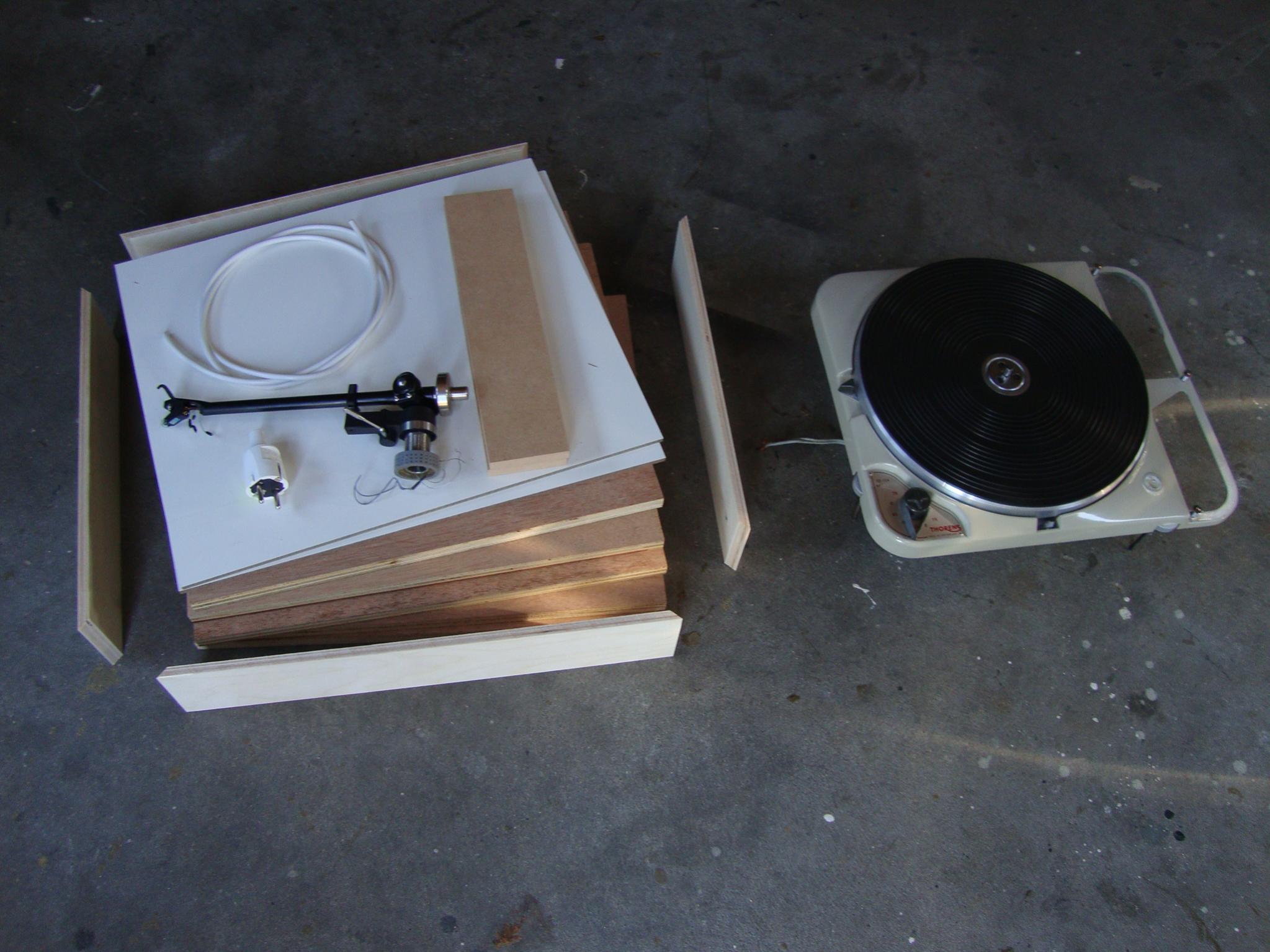

I just went to my favorite hobby shop they alway do a great job sawing parts precise to my specification and at a normal price.
And see here the RB301 arm came of my first TT project and has "van den Hul" silver tonearm wires.
So now I need a template to cut the 5 hardwood plywood plates to create a nice heavy plinth.
The outside is birch plywood the top and bottom is TRESPA a hard material witch will be painted black.
The arm board is of mdf to have the right thickness.
Mann I have to get to work I have to finish my tube amp and build the plinth for the thorens.

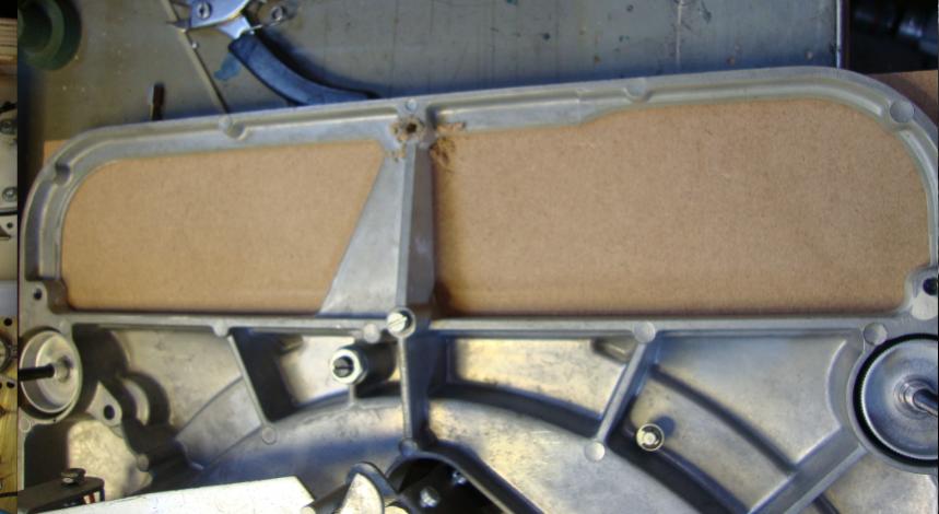

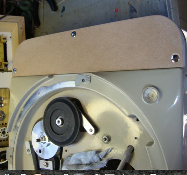

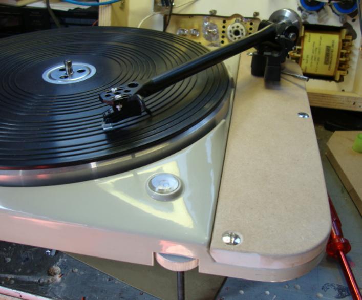

Arm board
After cutting a 71-322 mm piece of 12mm mdf.
At the inside I made a 30 degree angle.
Then I drilled the two holes at the outside. Mounted the board and at the bottom drilled the third hole for perfect fit.
With the router a copied the radius of the td124 frame. And then copied it to the arm-board.

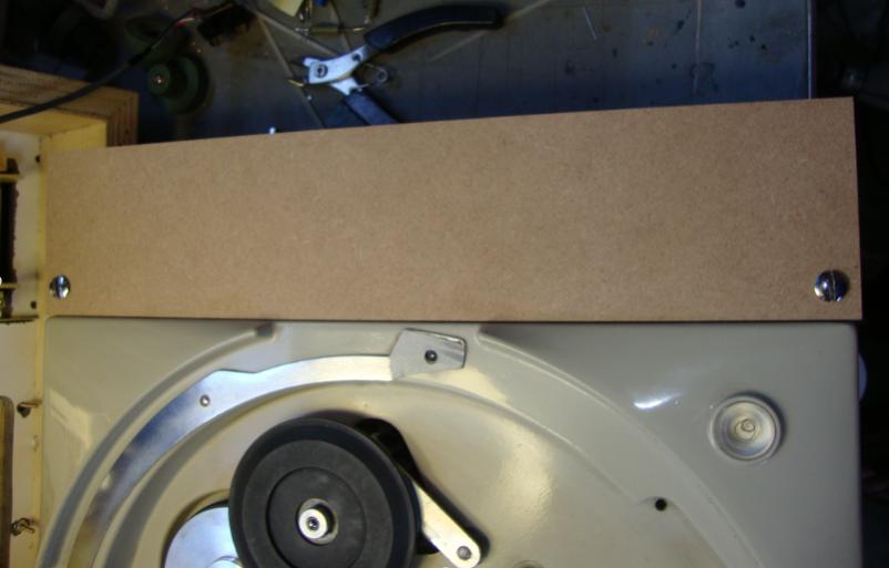

Now i need a template to place the hole for the RB301.

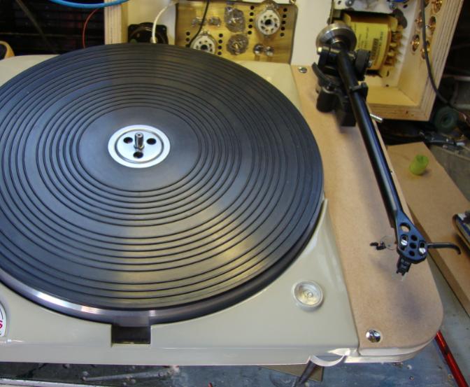

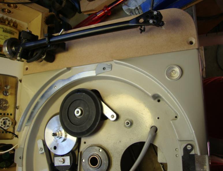

Next step tone arm mount hole and paint.
first picture the template with the right radius to mount the rb300. Big hole is the hart of the main bearing and the small hole the center for the tone arm. Fist very nice the VTA will be very near ideal with a lp thickness added.
The no nonsense shape off the RB301 fits the TD124 perfect.

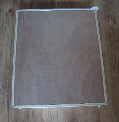

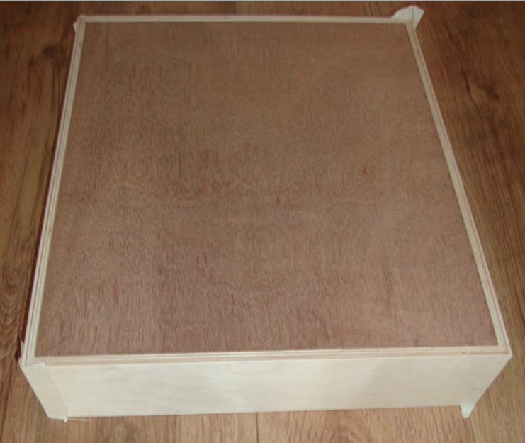

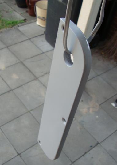

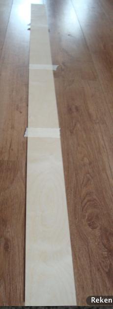

Ok now after this day of work.
Made a design for the plinth gone to the hobby shop and got me what I needed.
First made the tone arm board. Sanded and painted it, solved the speed problem I only hat to remove the motor and oil the bearings of it. The idler wheel of mine is 80mm. So here the result tonearm plate ready.
I wil make a plan now how to cut out the inside of the hardwood body.

Good question. What holds the idler wheel in position against the driving capstan and the driven inner platter rim?
See above image. There is a position adjust for the cam follower on the large arm. Additionally, there is a long tension spring (pull type) that serves to help retain position of the arm when speed selection is disengaged. That and the rest of the speed selector assembly which serves to position the idler wheel against the selected speed capstain on the step pulley.

I just took off the belt and idler wheel.
So I have cleaned the pulleys and belt and idler wheel. The inside of the non-machnetic platter were the idler wheel runs hat some sharper spots. So a sand it very loose with a very fine sanding paper and cleaned it so it had a flat smooth surface.
I cleaned the bushing and axle of the idler wheel oiled it again.
And mounted the assembly I can not see signs of wear on this turntable it bin hardly used.
On the idler wheel is a date it maybe say something about the age of the turntable. It says 3 september 1963 it means the table is made between 1963 and 1966. So it would be 48-45 years old. If it is the original one.
If you remove the motor capstan to apply oil to the top bearing, then make a note of where the capstan was on its shaft. The position of the capstan affects motor vibrations.
And don't trust the small libelle (level) on the deck. Check that it's true against a good level, used on top of the heavy platter (with the top platter removed). My small libelle was out of horizon by quite a few degrees. If they match, great - if they don't, go with the truer level, if affects drive train efficiency and spindle wear.
Assembly plinth outside rim of 10mm birch plywood.
First tape the outside to each other. Then turn the inside up bring on the glue. Now fold it together.
To get it perfect 90 degree finish I lay in the bankirai plywood filling just for good fit.
