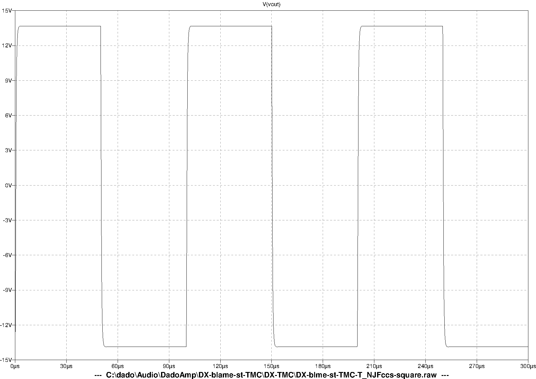

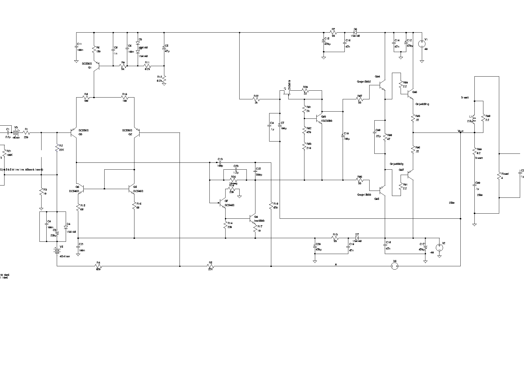

First TMC as I made this amp and listening to it every day.
Here is a schematic, square wave test, first with no parallel capacitor to 8ohm load, and second one with 1uF parallel to load.
dado

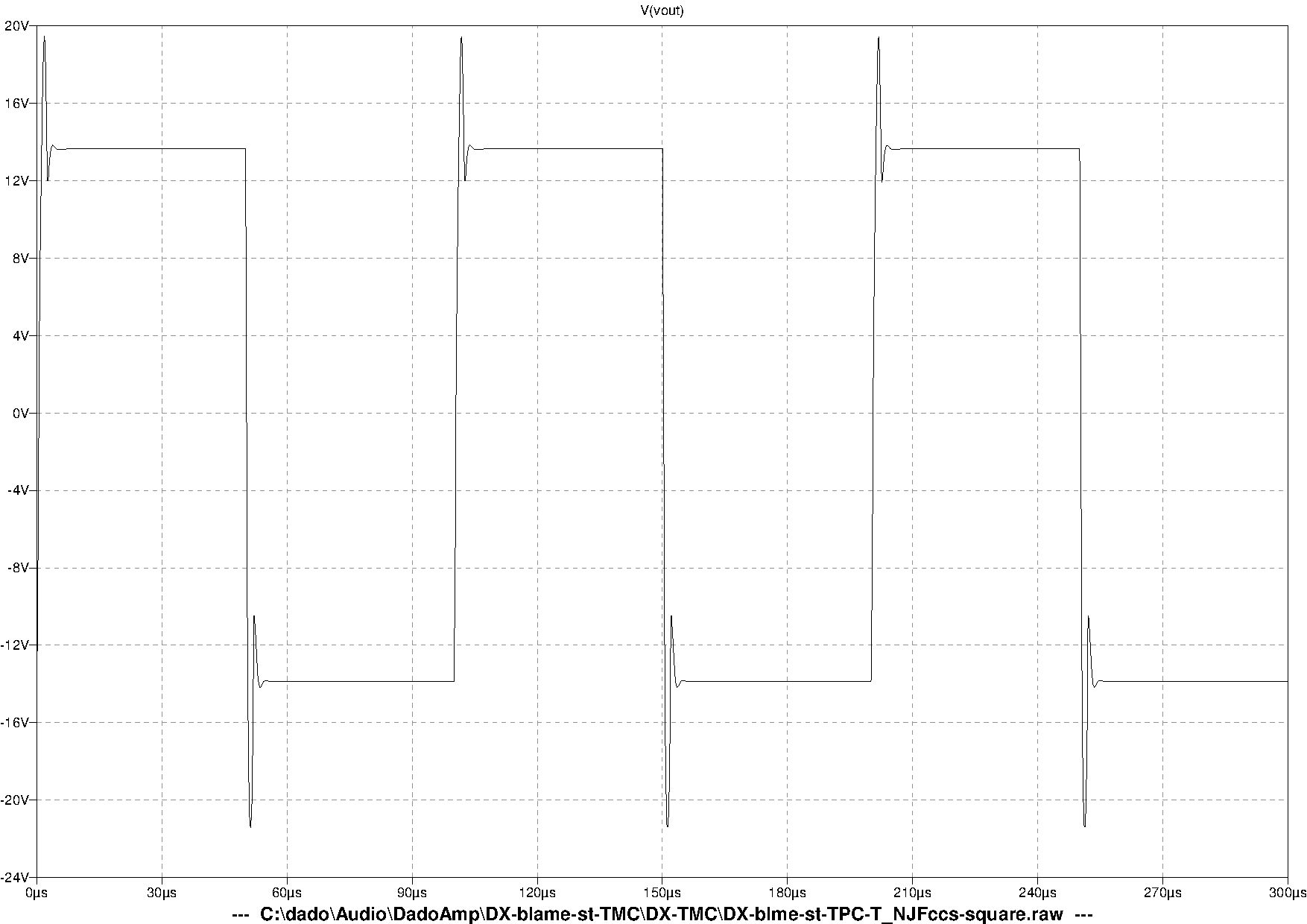

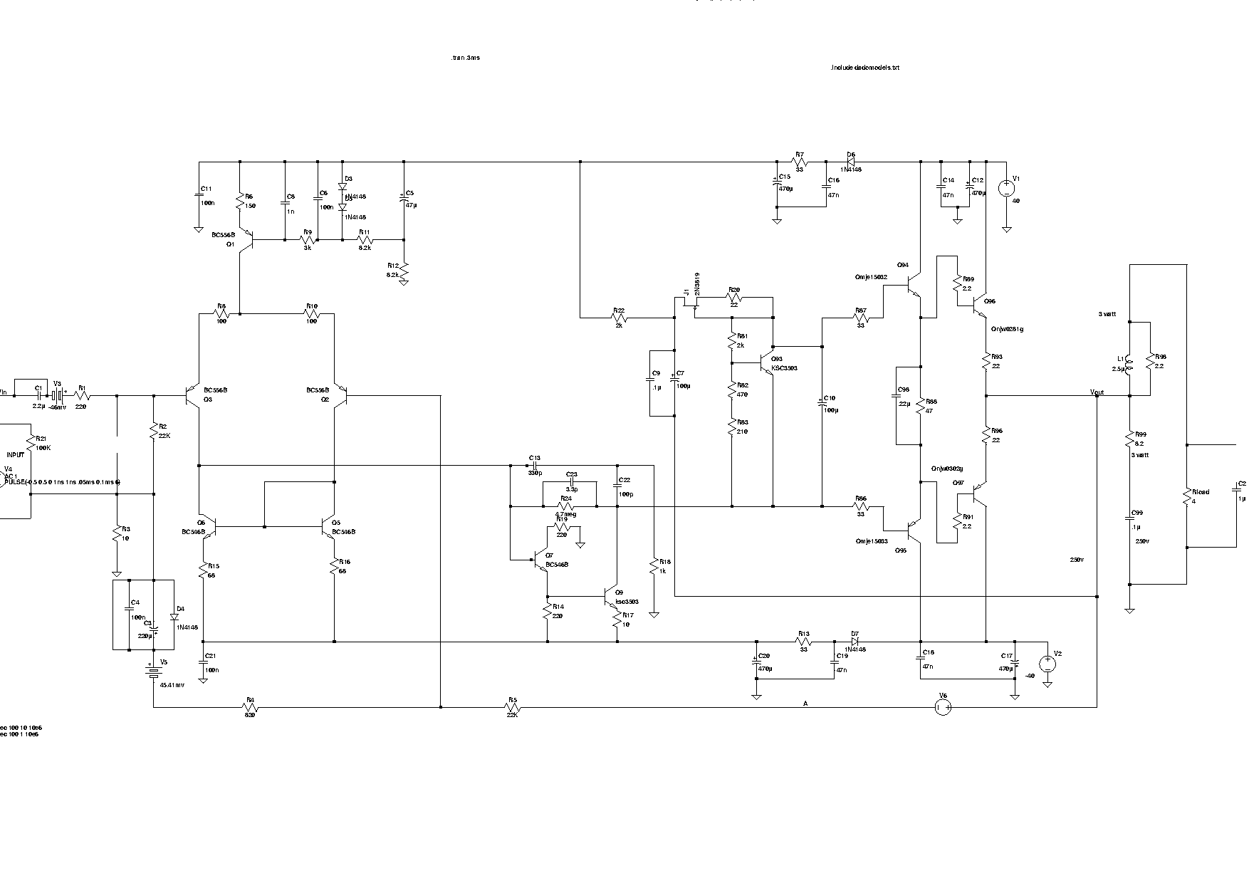

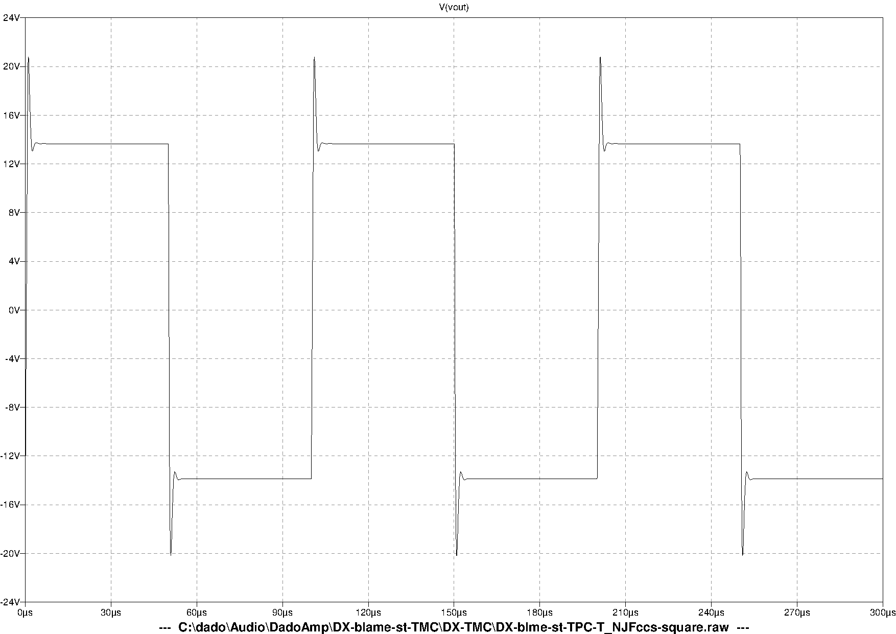

I tried to simulate TPC amp with similar distorton and OLG.
You can see that square wave has overshoot and ringing. I could not get ride of it with simple additional compensation, and my decision is that TMC is "better" and simpler in practical use. I was thinking about TPC in a way to decrease EMF influence from a loudspeaker on input stage.
I know that for many people this discussion is closed, But I would like to hear other opinion.
Here are TPC diagrams

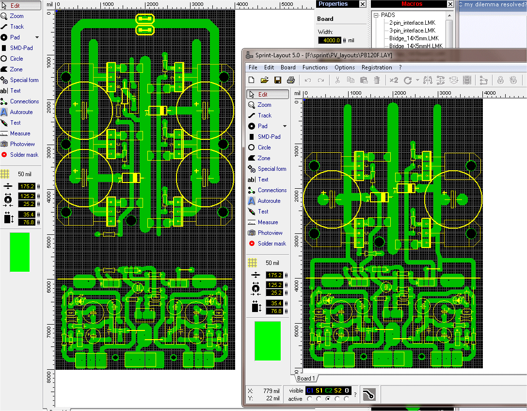

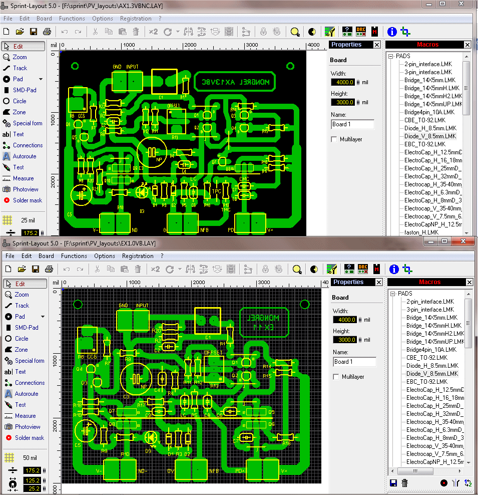

Strange , Dadod ... that you started your new "triple OP" thread. Unlike DX , I feel that even with the reduced impedance , any more than 2 pair OP's deserves and NEEDS a better circuit. In fact , your triple is EXACTLY what I was thinking for the PB150 power board. The TMC blameless is the best it can be but why not play with other topologies. That is why I am staying modular (below).
Also , the AX is universal TMC , TPC , CMC .... lots of room for play. I will not go "stagnant" ... :D
PS , I'll be over in your triple thread soon :) .
OS
