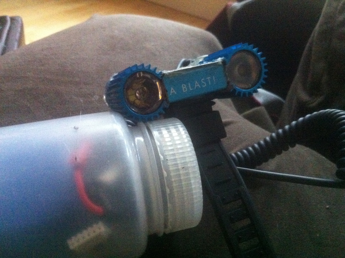

Here's my bike light--obviously diy (ugly!). It uses 2x Cree MC-E (emitter has 4 dies per chip, so the light is effectively 8 LEDs) attached to a 22v LiPo hobby battery. On the "medium" setting I sometimes get cars flashing their high beams at me. I used thermal epoxy to attach the boards to copper pipe ends and then mounted RC motor sinks around the assembly. Stays cool at all but the highest setting.

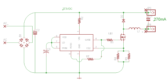

The reason is to limit deteriation at the PN junction, when you do LED strip lights they are generaly done on an aluminium clad PCB to remove the heat. Without removing the heat you would not get anywhere near the 50000 hours they advertise for LED lighting.
The LED itself is dereated at temperatures above 25C. Modern drivers are small 3mm IC's with minimal heat tolerance, maybe 600 odd mW unless its one of those with the copper bottom. The rest of the circuit is a mosfet (the cause of most of the driver's heat, normally aproaching 70C), an inductor dissipating heat etc... The current design I'm working on wastes about 1.7W between the wall socket and the LED. Outputing 12W, and doing well over 1000 lumens. It is twice as bright as a 15W CFL I have for comparison
Now when you deal with the small formfactor of a retrofit bulb, you have a 2W heater stuck in a sealed 1" diameter tube.... This alone requires quite a heatsink, as the temperature is added to the temperature caused by the LED. On a sink of about 4"x4" with 6, 1 inch high fins the LED (isolated from the driver) easily adds 25C above ambient. At 75C on the current LED I'm useing, you throw away at least 10% of light output due to derating.
Also the little sealed tube contains electrolytics which have lifespans reduced faster the hotter they run by quite a factor. So you on the one hand want to promise guarantee long life, as is expected from an LED, but the driver would be an achiles heel in terms of life expectancy.
Efficiency on the driver I'm working on is in the low 80% region.
Bicycle ligting tend to use more efficient step up dirvers, but have lenses with about 25 degrees diffusion. The LED I talked about has a 120 degree dispersion. Soure you don;t have as much light "wasted" on walls but working surfaces etc receive more light.

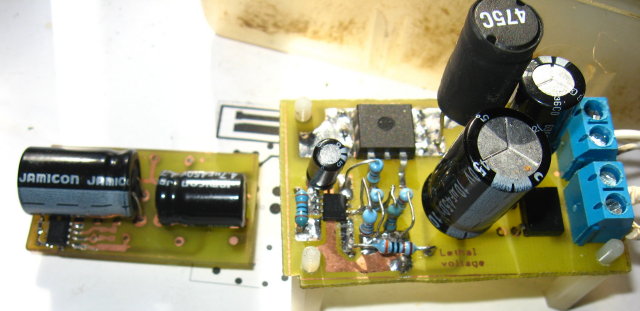

Here is the driver the big one is the previous prototype, the small one the current, the inductor and mosfet is on the other side of the board.

Nice! Coincidentally, last week I was checking out headlamps at an outdoor retailer for a new trail bike I'm considering buying and made the mistake of looking into the business end of the lamp while I quickly hit the power button on, then off. That was a really stupid thing to do - had spots in front of my eyes for five minutes after. I guess I'm still used to the "gentle" LEDs I experimented with back in my analog electronics college course back in '87 (in my microprocessor class the next semester, I was given one of the "fast" Heathkit/Zenith trainers to work with: the Motorola 8 bit processor was now working at a fiery 1 mHz! Yes, that's ONE megahertz :)).

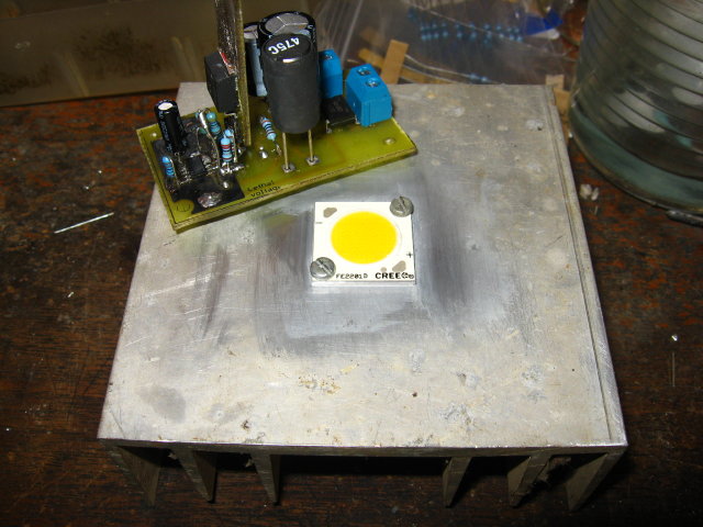

You get them loose, here is my sample of the new Cree LED that was anounced at the end of Feb, not available commericialy yet. Absolutely stunning colour rendition, and very strong output.

That is an AWESOME LED. 4000 lumens at 85oC that is just insane (especially since it is Cree (and not some no name Chinese company) which means it is likely a true 4000 lumens (or atleast close to it).
For white LEDs name brands are better (you can get specific color codes so they will always match), the last longer, are more efficient, etc. For example, for years chinese companies were releasing white superflux LEDs (also called Piranha LEDs) which were 5-chip 100mA white LEDs. This is a form factor that is square with four leads very commonly used in automotive lighting and what not because the legs allow for more efficient heat transfer. The white LEDs produced around 1-2 lumens (not bad at all for that time period), but color consistency was crap and they died easily. Then Cree comes along with their P4 piranha LEDs in white, bam 4-7 lumens at 35mA. More recently in comes Nichia with their new white superflux which puts out ~21Lumens at 50mA. These are still low power LEDs which mean NO heatsink at all and just a few is capable of lighting the inside of a car pretty well.
As for getting LEDs, yeah you can purchase them loose or in the case of high powered LEDs you can purchase them loose or mounted to a board/star. Such as like this: $9.80 - XMLAWT 1000-Lumen LED Emitter White Light Bulb (3.0~3.5V) - Flashlight Parts and Tools . To give you an idea of the output of that LED 1000 lumens is a rough equivalent to a low beam halogen headlight bulb (thought the halogen bulb outputs the light in all directions, this is very directional).
Lastly, why the huge heatsink? LEDs do NOT like high temps, most prefer the die to be kept below 125oC. Additionally, they produce a relatively large amount of heat (1W or more) from a die that is roughly 1mm or so on a side. That heat can cause a rapid T spike which causes thermal run away and then a dead LED.
