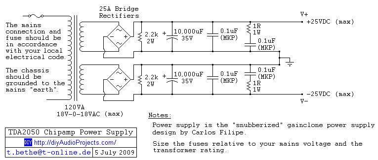

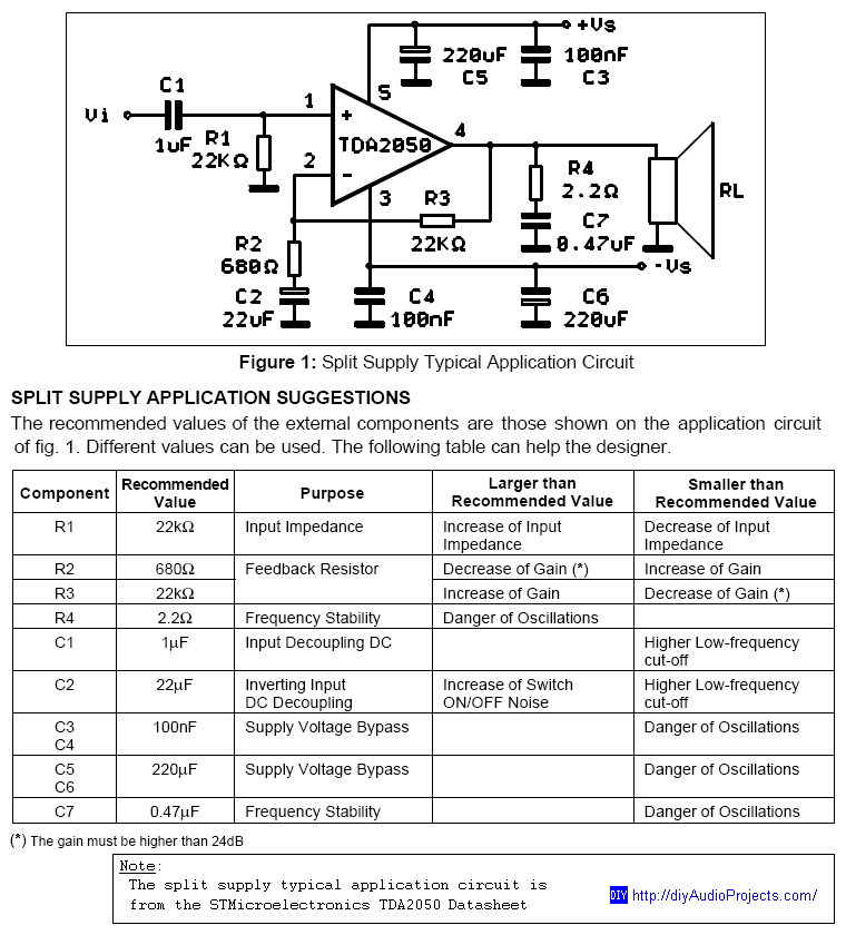

Go with single TDA , if you want more power go with TDA 2050 ,it is same thing with more power.
You cant use laptop psu !!!
To drive TDA 20xx series you need a simetrical votage supply,like 2 x 15 volts.I mean you need a +15v and -15v to drive amps.
Laptop psu have omly +18v.
Generaly you need common usage transformer with 2 output woltage betwen 14-18v (2 x 14-18v) with 50 to 70 watts (total).
One rectifier bridge (40v ;4 or 6A),2 x 3300mf or 4400mf 35v capacitors
for basic power supply a both TDA's (stereo).
TDA 2030 real power is 10-12 watt at 4ohm its sound very good.
Dont bother with power rating of any amps,go for how its sounds !!

Well...:rolleyes: I didn't find it in a kit ....it was in the middle of a Tv PCB and all I had to do was to cut the square containing the circuit and put it in a box
with a 20V trasformer ( unloaded ), a diode bridge and a pair of 2200 uF capacitors .:p
It has enough punch and it drives low loads.

If you want to use the laptop PSU to keep the cost down, just order the TDA2050. The others will work, but you can order a few and use them for higher power amps later. It can be wired into single supply mode just like the other chips. Output will be much reduced at 18 volts as they are meant to be operated on split supplies of 36-45 volts (total) to reach 20 plus watts. Since this is your first project, don't forget to use a heatsink with the IC.

Yes ,copper price has risen a lot ,and nowadays transformers cost has doubled in respect to 10 years ago . But you didn't specify which power . For 50 W I think you can spend 30$ ,or you may look at some dumpster where old tvs ,radios etc lay unused ,with broken electronics but with functioning transformers .

A psu transformator for you neds is about 10-20$ an other components for psu is less then 20$ (not near 400$).
Dont improvize be a pro,you education is to be a pro,its cost you a few $ more in that case.

I disagree with the last posts. Build the amp for single supply mode and use the laptop brick. Save the money for a real transformer and PS components for later. As a beginner, it is unnecessary and not desirable to take on too much on your first outing.
The TDA2050's internal bias comes on at under 3 volts, so no problem using a 9 volt battery in single supply mode, or two for split supply mode. One for the + rail, one for the - rail. You would be better served using 8 AA cells in split supply mode (4 per rail) since the quiescent current draw will drain 9 volt batteries in a few hours (and playing music in a few minutes).
