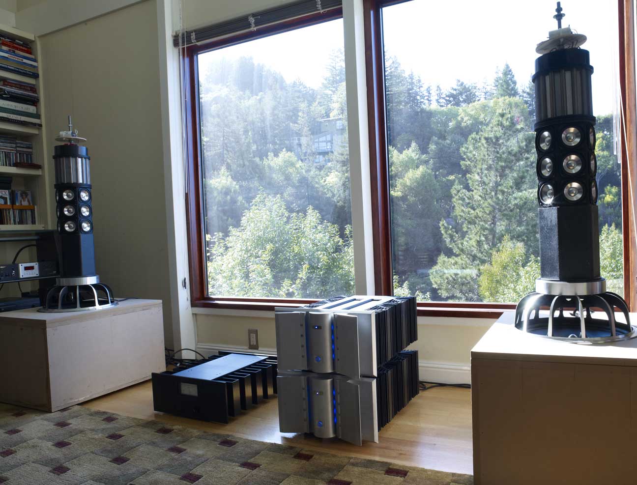

This is obviously work in progress, but which DIY project is not in progress?

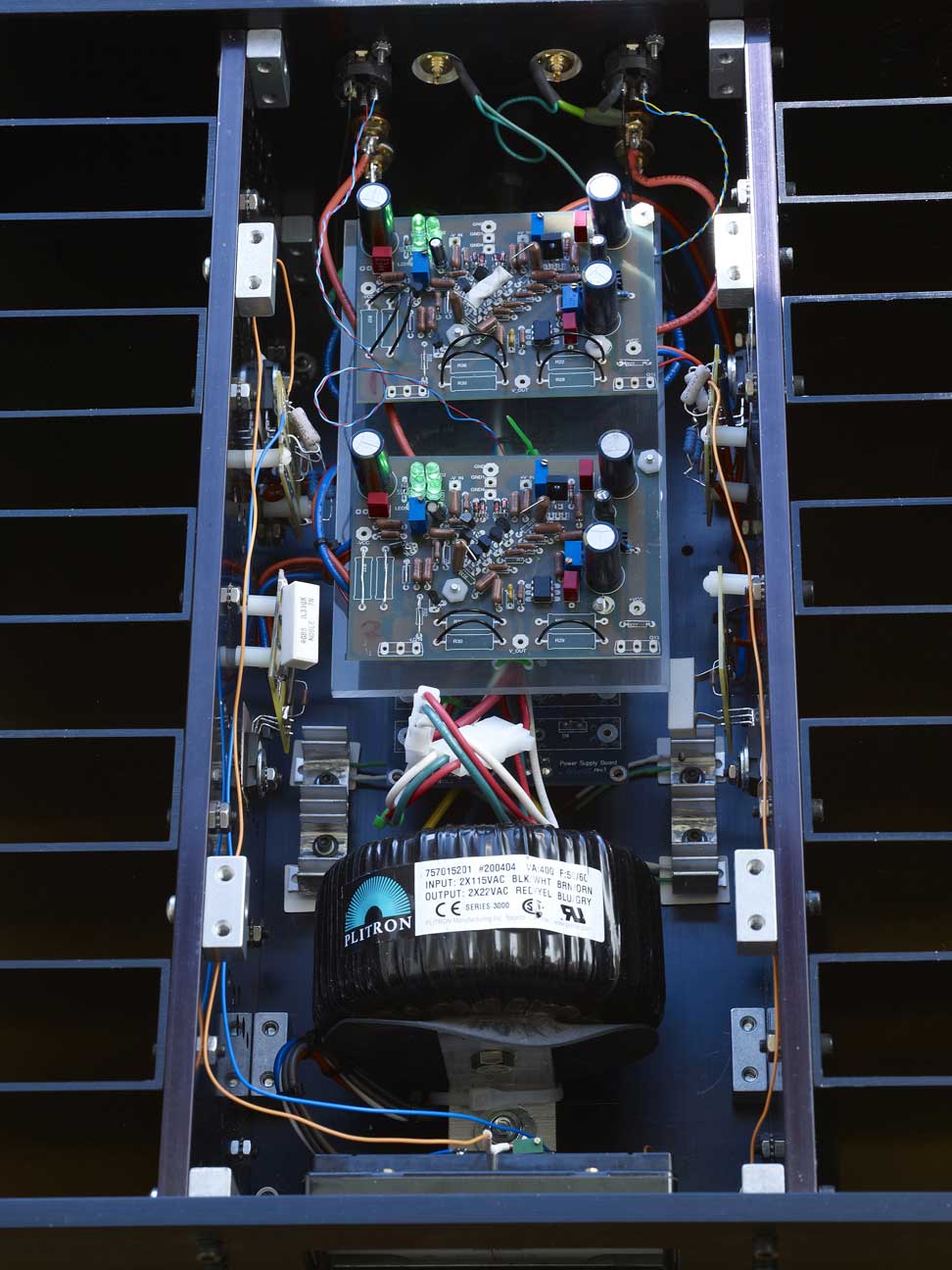

It has been a while since I had my original active three way system, that was based on Behringer DCX2496. Now I decided to change almost everything. To start from the end... Speakers - are RAALs Eternity on the top. Bass is Lambda 15" Enclosures are just made for the measurements and tests. The final ones will be made on CNC curved and hopefully beautiful. Eternity tops are naked in the shoot, they have covers and foams that are there to help with dispersion. Those are RAAL's omni speakers with 18 small mid drivers and 15 ribbons. Bass is positioned in the center of the column in order to maintain perfect time alignment, and since it is cut at 200 - 200Hz there are no ill effect on voicing because of the angle. So far I am very happy how they sound. Cannot wait to complete final boxes.

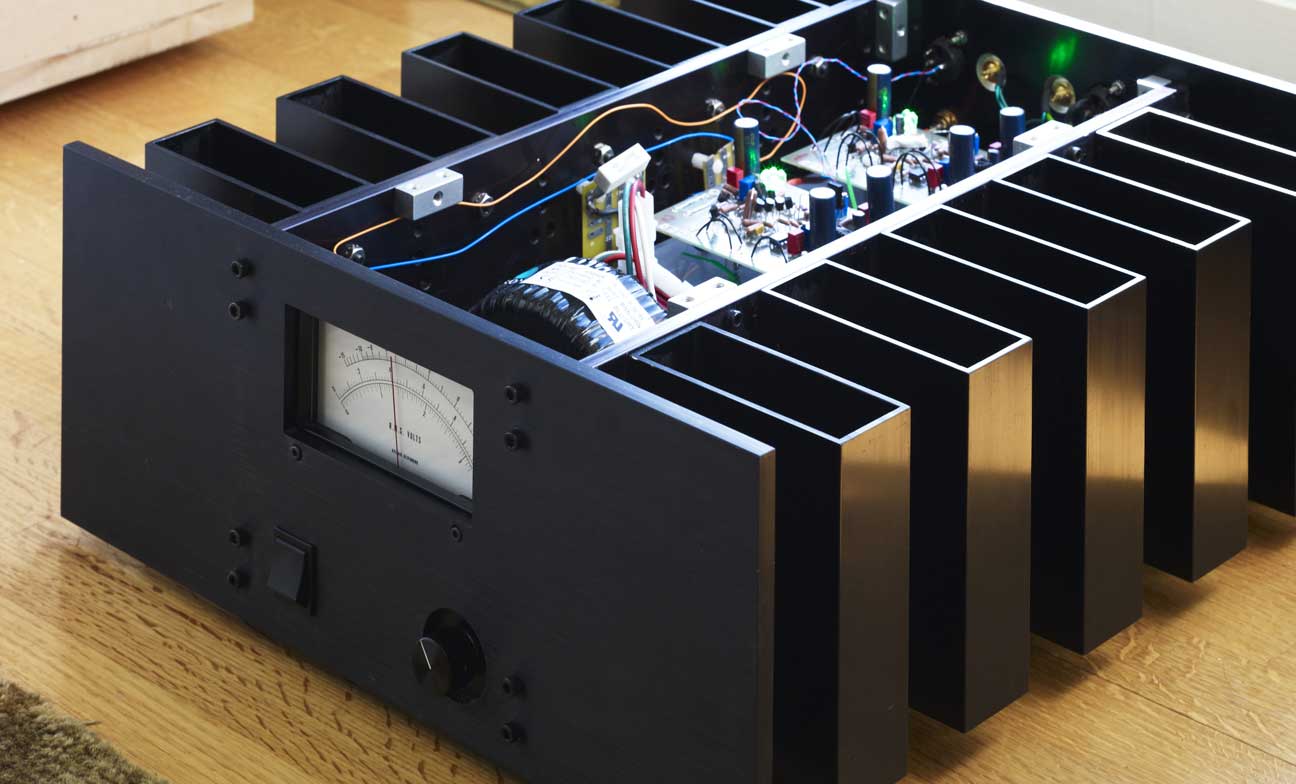

Amps - Nelson's X 600s are driving bass, cases are my execution, and Babelfish J2 is in the Nelson's test case, I was lucky to receive from Mr.Pass. That Amp has a holly character for me, since it is the case Nelson used, and amp is based on his J2, modified and designed by Zen Mod, playing on Alex's speakers
So in my room I have work of three guys I am fortunate to call friends - Nelson, Choky and Alex. I feel like three of them are constantly singing to me. :p:p:p
B2J works on Eternity and it sounds immaculate. It is just an exceptional amp. I loved that amp from the moment I first time heard it at Nelson's place and I believe that Choky's execution brings it even one step up. Originally I drove it with 2 x 400VA Plitrons with 2 x 130uF PS, but since I am limited with the case size and also because I am driving only mids and highs, I was comfortable shrinking PS in half.
The main changes to my system are going to happen in digital domain. I will be using asynchronous USB to I2S converter 332/384 8 channel output device with two (or three) Sabre based ESS 9012 DACs. Analog portion will be Twisted Pear's Legato, with Choky's designed 6 channel Lundahl transformers and balanced jFet buffers. Balanced from beginning to the end without a single cap in the path.
I am just working on the digital portion, assembling it, at the same time I am finishing speakers and amp installations. A lots of work, but that is what I enjoy the most. I have to say, I am really fortunate to be in the position to play with such a outstanding equipment, but more than anything, I am fortunate to know these exceptional people whose work I admire so much.
