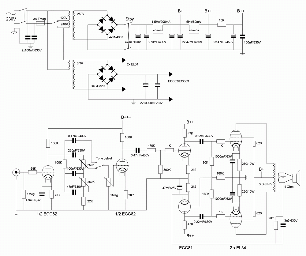

from the nature of your questions I conclude this is your first tube amp, since you ask about chokes
this one looks a lot easier to build
I have seen it in several places, so I'm not sure who designed it
but I guess its a proven design
