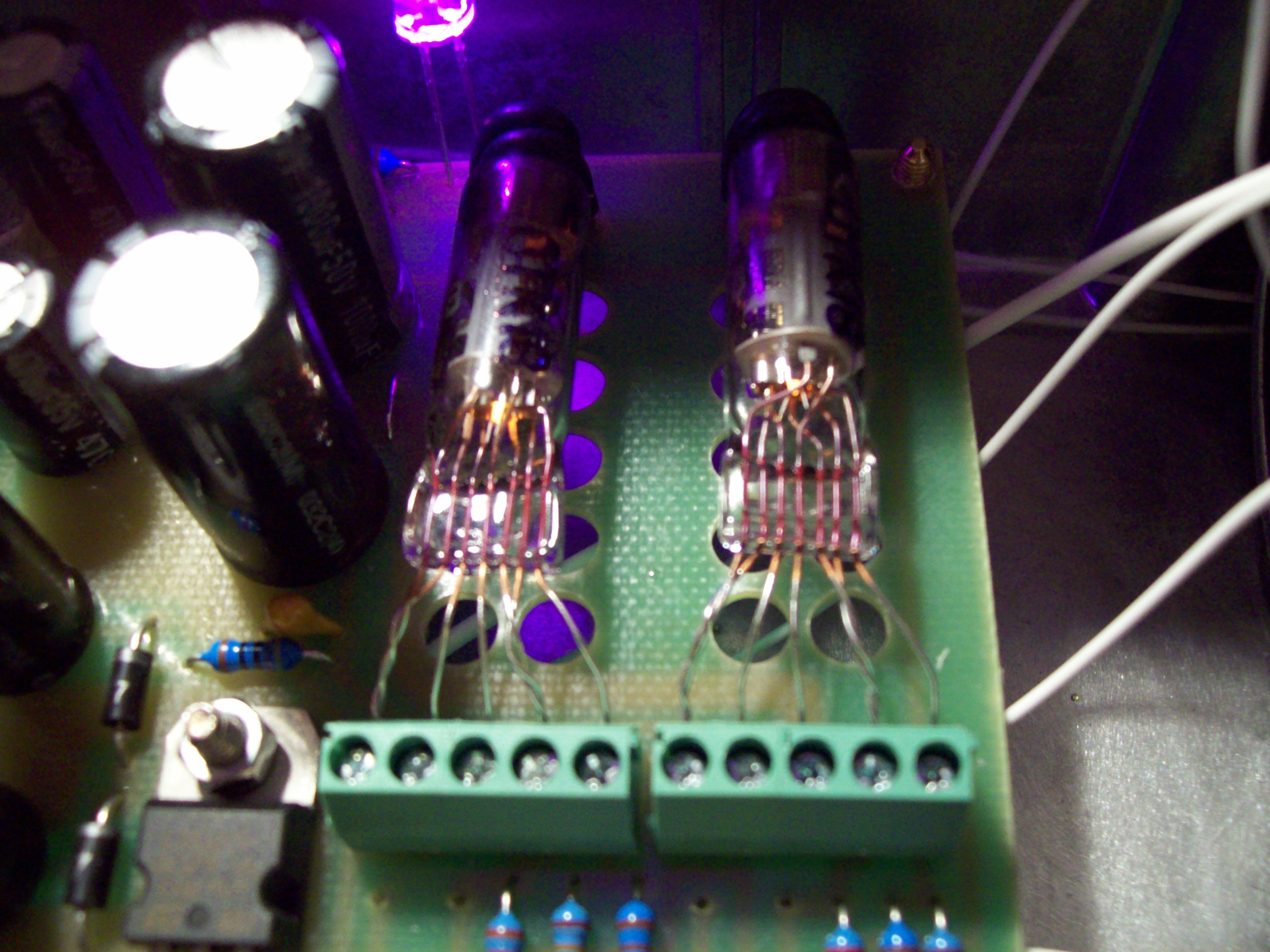

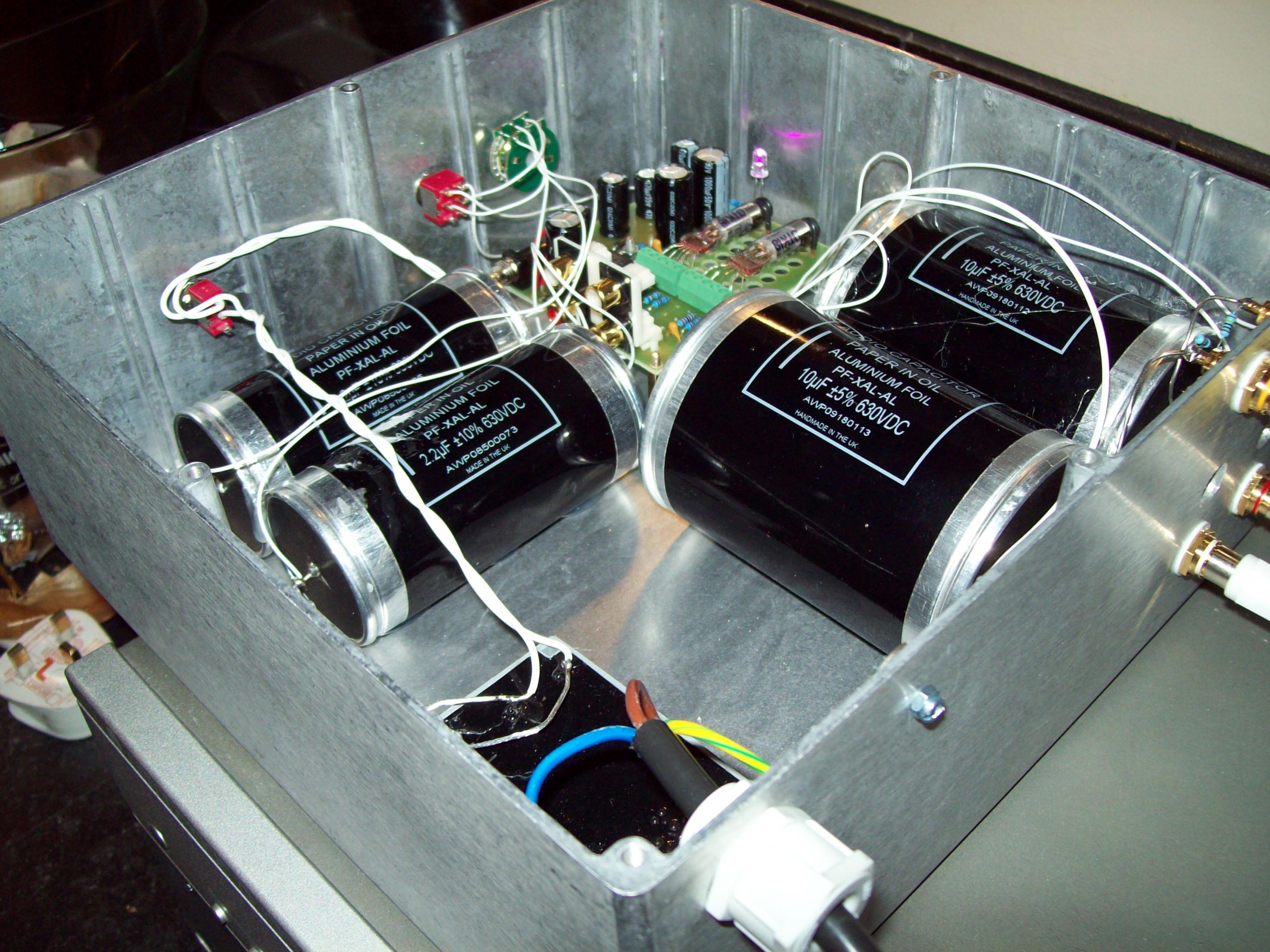

I bought one µTB-201 buffer board for a bit of fun. Just finished putting it in a box this evening and now it's plugged into my kitchen system playing digital radio.
I bought a pile of dented Ampohm PIO caps recently so replaced the onboard output coupling caps with a pair of 10uF PIO and also added a pair of 2.2uF on the input.
It definitely works! No hum or tube noise heard from where I'm sitting, but my kitchen speakers are not very sensitive.
