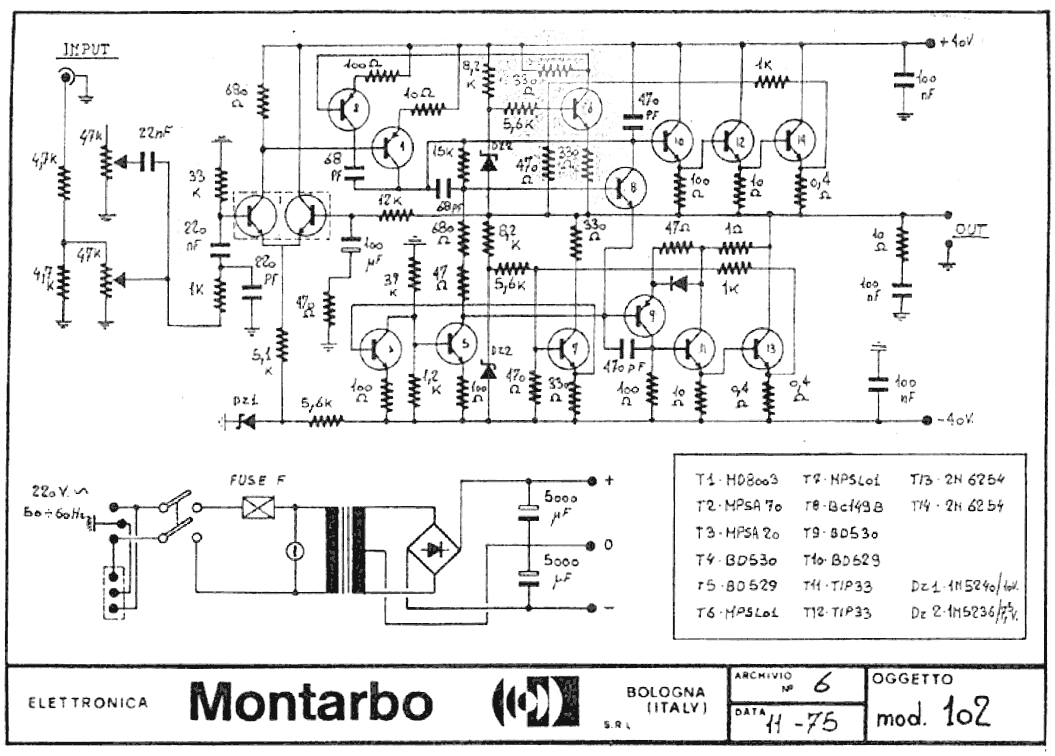

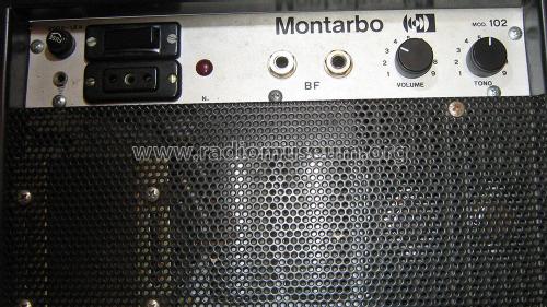

Hi everyone i'm looking for schematic for old montarbo mod 102 its 80 watt i guess . it use one BD751A and one BD750A transistors and LM391 ic . i try to get it from the montarbo company in italy but they sent me the same model number but it's the wrong one . please any help it will be appreciated :)... and here the one they sent
