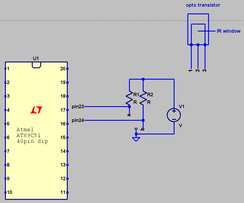

Hi all,
I have a remote control kit.
How do I identify the pins (1,2,3) on the IR receiver device?
How do I connect the IR device to PCB (a,b,c)
Using the diode function on a DMM.
The following connections show mV while passing ~1mA
legs . . . . mV+ . . mV-
1->2 . . . open . . 650
2->3 . . . 540 . . . open
1->3 . . . 740 . . . open
If the device is NPN then leg 2 is base and -ve current flows leg1 to leg2 and also leg3 to leg2. Legs 1 & 3 being collector and emitter.
If the device is PNP then leg3 is base and +ve current flows leg1 to leg3 and also leg2 to leg3. Legs 1 & 2 being collector and emitter. Does the highest mV reading of 740 indicate that these are collector and emitter with light/heat holding the junction as apparently open?
How do I tell from the voltage drops which is collector and which is emitter?
How do I tell if it's PNP or NPN?
Finally,
how do I connect 1,2,3 to a,b,c ?
R1 & R2 are both 22k.
The supply is 5Vdc

Those things are usually a self-contained receiver with a tuned circuit for a particular frequency. You supply power and ground and the decoded signal appears at the other pin, active low IIRC. The transmit signal is pulsed at 30~50kHz depending on model, but you don't see the modulation on the receiver output. I identified mine from the datasheet + I scoped the output with a soundcard. 38k is a common frequency, I just blasted it with a few remotes I had handy.

You check the data sheet. It isn't an NPN or PNP. It's a receiver with ground, power and signal output at TTL levels. They typically run around a mA to operate and as Wakibaki said, the carrier is already removed so if you put a scope on it you'll see the envelope of the data which makes the micros job much easier.

Yes the PCB has the atmel control chip on it and three pads labeled a,b,c as shown in my diagram.
The IR receiver is mounted on or in the front facia. A 3 wire connection with three pin 0.1" pitch sockets can be used to connect them together.
The ground comment ticks a box.
Pin C is connected to PCB ground.
Pin 2 is connected to the metal enclosure around the IR receiver. That fits with the wiki description that the base is not connected and the light is the base input signal.
Maybe these two connect to each other.
Then that just leaves pins 1 & 3 to pins a & b
But why am I getting transistor type readings across pins 1, 2 & 3. Pin 2 is apparently connected to the IR junction.
I must assume that the IR receiver is a IR module, not simply a IR phototransistor. Nobody would use a phototransistor for remote control, when an IR module does so much of the hard work for you. If what you have is indeed a phototransistor, then that begs the question: is that what your kit needs, or does it need an IR module? (i'd bet it is the latter).
An IR module has power, ground and output pins. If you bought it then you know the part number and should look up the datasheet. If you salvaged it from an old VCR or something, then you should trace the original PCB to find the power and ground connections.
The output of IR modules is almost always an open-collector style digital output, which is active low (it idles at Vcc and is pulled to ground when an IR signal is present). They usually have a built-in pull-up resistor, but not always. I assume that R1 or R2 is a pull-up. Usually power is supplied via a small resistor (100 ohm) followed by a decoupling cap. This forms a filter to prevent noise from the supply from affecting the module.

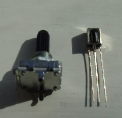

The two RC kits all came together as a new unused unassembled kit on 4PCBs, each PCB was pre-assembled. rotary encoder which I don't intend to fit and a receiver.

From the photo, it could equally be a phototransistor or a IR receiver module. But your original circuit diagram would not support a module. In fact, the circuit would nicely support a dual phototransistor, which would likely have two collectors and a common emitter. There need not be any base connection on a phototransistor, though a base is sometimes provided. With no more information than you have given, I assume that it is a dual NPN, and would try pins 1 and 2 to a and b and pin 3 to c. Try measuring resistance (not voltage drop) from 1 to 3 and 2 to 3, with 3 being the black lead. Vary the light level and see if the resistance changes.

Hi Andrew, these IR receivers are pretty common and output a TTL level signal.
Three connections, one is ground, one is 5 volts, and the output (comparator output here) is usually an open collector PNP stage requiring a resistor of 1 to 5k to ground. Depends on the input C of the following stage really.

Just looking again at the diagram post #1.
It just doesn't look correct. The IR receiver as mentioned above is normally connected to a 5 volt supply with the output connected to a designated port on the micro. That port is configured via the code to accept the TTL level signal from the receiver.
Your diagram appears to show that supply coming from a port on the micro... !!!! Why ?
The micro has no means of processing and interfacing with "just photo diodes" as far as an making an IR receiver goes. It needs a fully processed 0/5 volt logic signal applied.

Both the 22k are fed from the regulated 5V supply (except it measures 5.6Vdc). The chip monitors the lower ends of both 22k.
I see your and the earlier point that this metal box with the window is not just a transistor.
Is there a safe way to connect the (unknown) receiver to a plugboard so that I can scope the outputs? This hopefully will show the ttl signal or the carrier frequency with some intermittent modulation when I activate the controller buttons.
The CPC receiver module pic looks very similar. The middle leg (2) is connected to the metal case. Legs 1 & 3 exit either side of 2.
Andrew, by sure you have an IC infrared receiver and the middle pin of any IR receiver "IC" is the GND node. The +V supply pin is either the Nr. 1 pin or Nr. 3 pin. In most cases, pin Nr. 1 is the output of IR circuit. The output of IR in "idle mode" is +5V. When it receives a code its output drops to 0V. In any serial protocol (from those that i know) the transmitted/received code forms "slots" on a constant +5V line. Another one issue, is that the IR receiver should be tuned with the carrier frequency of the remote control handset transmitter frequency that you use. Are you sure that you have compatible (in carrier F) IR handset and IR receiver? If yes, then you can tie pin 1 or 3 of IR receiver thru a 10K resistor in +V supply and then you can find what pin is the output with your oscilloscope.
tying pin1 to +5V via a safety resistor and pin 2 to 0v allows the scope (10M load) to see the output at pin 3. Is it as simple as that?
What if pin 3 is the +5V and I have it connected the wrong way? Does the safety resistor protect the receiver from damage?

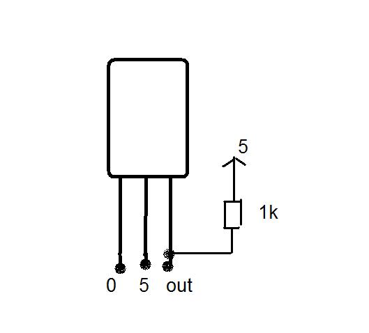

Andrew... I have one very similar in front of me. From left to right it's ground/+5v/out.
On this one the output is an open collector NPN so it needs a pull up to 5 volts... sorry I mentioned the other about I think.
I am also a non digital guy!
The output of IR receiver, it is the collector of a NPN transistor which is connected thru a resistor of some KΩ to the +V supply rail, internally in IC. Indeed, it is very simple.

Tested as post17.
Very noisy signal across 10k, ~60mVpp.
Draws 3.8mA through the 470r.
4V2 across 10k and drops to 4V19 when I activate a controller button.
I can see spiky modulations on the output but I can't get the scope to lock on to them.
Mooly,
I see you have middle leg at 5Vdc
and taken output to 1k pull up.
Is it worth re-powering to your example?
