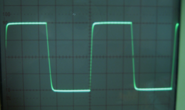

I thought I would share my first amp design and build project with the group here. I started out to build the JLH Class A, but it evolved into something a bit different. After completing the JLH I was not satisfied with the output offset drift. I also didn’t like the requirement for a regulated power supply, so I wound up switching to a differential input section with constant current sources for both the input and output sections. I stayed with the quasi-complementary output stage per the JLH design. My simulation showed very good results, although I struggled to get the transistor parameters right, so I have some question as to how good it really is. I have to say it sure sounds great to me, and my musician sons both said it sounded “Not Too Bad, ” so I call it the NTB:)
I switched the output transistors from 2N3005 to 2SC5242 for better linearity and easier mounting. The bias current for the output devices is 1A. The power supply runs at +/- 15V. At 8ohms, that works out to about 14W per channel. A more conservative rating on the power supply of 13V gives more like 10W per channel. One critical component was the “current splitter” which feeds the two output devices. I had to find a device that had a very low base-collector output capacitance and went with the NTE373 at only 14pF. This greatly improved the overall performance from the original device I had chosen. The rest of the transistors are pretty common components. Because I had two transformers on hand, I went with separate power supply boards for each channel, each with 8800uF of filtering. There is another 2000uF on each amplifier board for local decoupling. I used separate ground returns for that.
I drew the schematics and laid out the boards using ExpressPCB. I have been very happy with their software and service. I did not get the solder mask or silkscreening option.
The heat sinks were found on ebay. After about 4 hours with no load, the maximum temperature I could measure on the output chips was about 150F. I have access to an IR thermometer from my work which sure makes things easier. My transformers are each rated at 2A, but they run pretty hot at about 140F. I wasn’t expecting a heat problem there, and I may add a heat sink to each of them.
I have attached the schematics and an output waveform picture. I will post a few pictures of the build in a separate post. The squarewave output is at 20kHz, and +/-10V. The slew rate looks like about 20V/usec, although it is hard to tell from the picture. The amp is very quiet with no trace of hum at the speakers. It has an output offset of about 4mv.

Bigun, I think your hunch is right regarding the cap on the phase splitter. I tried a capacitor in the 300pF range and I still had some ringing which I didn't like, but I bet there is an intermediate value that would be better. I may order a selection and do some further experimentation.

This issue with ringing can be a 'red herring'. I've looked at this recently and found some popular opinion that it's just a case of compensating the amp until it's smooth, as you've done, but I've seen some more considered thoughts on the internet pointing out the flaws in this approach which suggests that some ringing is 'OK' and preferable to over-damping.
For the kind of topology you have, with the LTP input, a compensation capacitor around 100pF should be much closer to the right value. In my own experiments I found the value had a subtle but repeatable impact on the sound. A value too high makes the sound a little dull, a value too low makes the high end too bright and somewhere in the middle you find the magic in the sound.

Be careful driving your amp with a square wave - I blew one up like that - square waves really stress the output devices. At full power it will blow it up before you have time to adjust your scope - at least it did for me !

Joel, very impressive (first amp or not) I doubt any additional congrats compare with NTB. I really like the clean build, and clean square wave response (20V/us seems sufficiently fast to me for 10V rails). Your thought out responses reveal the care that went into this.
