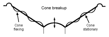

1. It is my understanding that the high frequencies off a conventional dynamic driver emanate from the center, off the voice coil and transfer outward through the cone to the rim/edge. The edge where the rubber/foam surround is generates the deepest bass, the middle frequencies come off the middle of the cone (right?).
2. However on whizzers with the free edge sticking up in the air with no surround, it is the rim top edge where most of the high frequencies emanate from (right?).
Please feel free to correct any of my statements, they are not stated as facts, only as my current understanding.
A picture or video would go a long way towards helping me understand this topic.
I still have not found anything on the actual cone. However what is shown below is close. I'm still looking for something which applies to Full-Range drivers and any "skin effect" of frequency change on the cone/cap and distance from center to edge.
Just having the correct terms will allow me to do a better search. What is the term or phrase I should be working with?

Kach 221,
only a few frequencies from a cone speaker is made by a "Kolben" movement, the T+S area and above, than it comes a "Schubbereich" working, than bendigwave area,
than a multiple faced array, the highest tones are made only by the voice coil.
Your last pic shows the Manger driver, AFAIK on the manger HP there are
shown laser holographic pictures where you can see the "movement" of the Manger.

Manger - Precision in Sound
The images made with laser Doppler vibrometrics show the concentric wave movement of the bending wave diaphragm at various frequencies.
