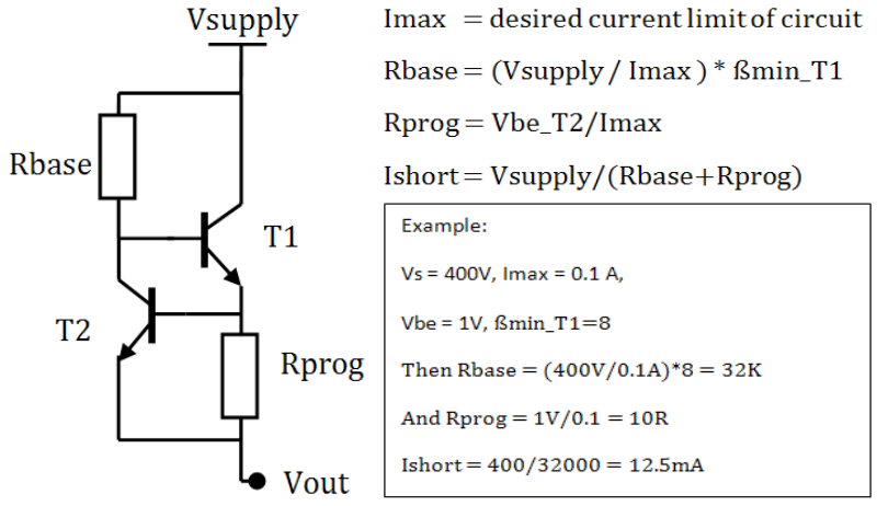

I wanted to use more than the maximum allowed capacitance of 47uF after an EZ80 rectifier. The maximum capacitance is limited by the amount of inrush current the EZ80 can take upon startup. The maximum current of an EZ80 is about 100mA.
So I've used a simple current limiting circuit to limit the current to 100mA (see attached schematic).
With luck, you can find all required components in an old PC power supply.
The circuit is positioned directly between the tube rectifier and the capacitance.

You may be confusing average current and peak current. The maximum DC current from an EZ80 supply is 90mA. The maximum peak current will be significantly greater than this. The effect of this current will depend on the shape of the pulse, the duration, repeat rate etc. The data sheet gives values for max cap, min series resistance etc. which if adhered to should lead to a reasonably long happy life for the rectifier. Exceeding them will shorten its life. Demanding less will lengthen life.
A big cap means a short (in time) but large (in amplitude) charging pulse, unless you use a big series resistance. Your current limiter is even better than a resistor, but you will end up with a supply with quite a high output impedance i.e. bad droop on load. You could use a higher current limit - 200mA?
On the other hand, why on earth use a vacuum rectifier then pad it out with lots of SS? You don't have to use big caps as reservoirs. You might end up with a better supply using a smaller cap and just a series resistor. Fewer bragging rights, though!

hmm interesting views.
The main reason for using a valve rectifier is slow turn on upon startup, and because I had a transformer that in conjunction with a valve rectifier just gave me the right voltage, without having to dissipate any to match the circuit.
One downside, however, is that because of the current limitation, the ripple of the power supply increases, for which I'll have to work harder to remove that...
In normal operation, the circuit only uses about 60mA, so the current isn't limited. Since DF96 suggested I can increase the current limit, I'm wondering up to how much I could increase the current.
Since the datasheet advises a limiting resistor of 300R for 325-0-325 into 47uF, rendering a peak current of 1.5A, that if I can increase the current limit a great deal more.

I've tried limiter - 47uf - choke - 340uF.. But the choke I have isn't very big, so that didn't help much except make the hum 'nicer to listen to', if that makes sense.
I've also tried doubling the limiting current to 200mA (soldering an extra 10R resistor on one leg and then pushing it on with an insulated screwdriver), and that didn't give any audible difference.

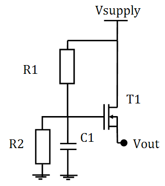

Hi DF96,
of course, but I like playing with regulated power supplies. RC I can already design!
Anyway, the second regulator should work better because the R that is used in the RC combination can be made much bigger, compared to the basic RC.
Have you ever designed actively regulated power supply circuits?

Your choices are LC or RC ripple filters, or an active decoupler made from MOSFETs. If designed correctly, there should be no problems with residual AC ripple.
