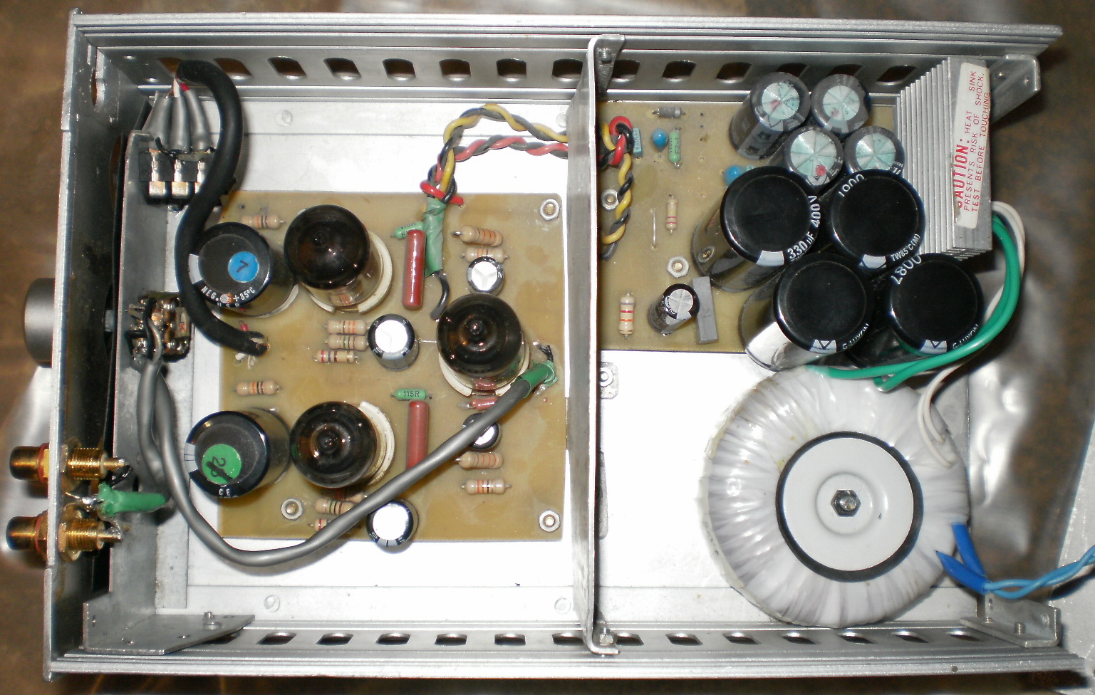

hi Stixx
and thanks for the quick reply. I have maybe average knowledge of electronics but when it comes to tubes I'm a complete noob. I know about grounding schemes and I'll check that too when I dismantle the thing completely. meanwhile, this is how it looks with the cover off (if that can reveal anything at all). will get back soon with more details.

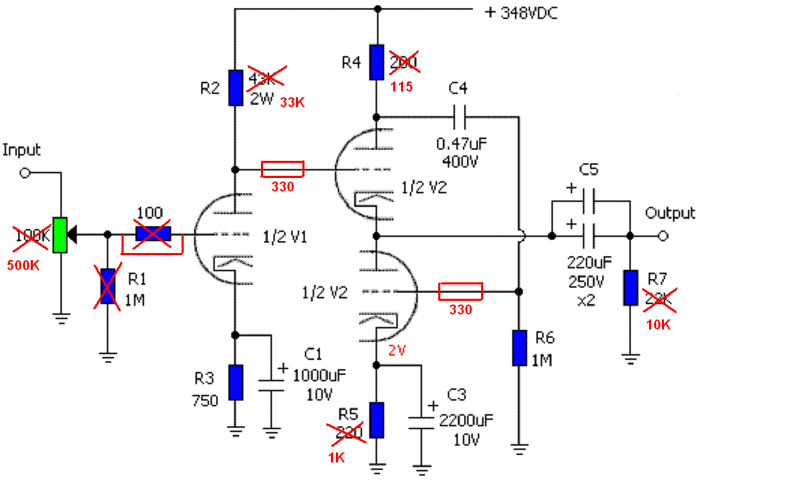

took a look at the way it's made and it's a bit different from Bruce's schematic. the differences can be seen in the attached pic (drawn in red).
other differences not seen in the pic:
- the power supply doesn't use the cap-res-cap-res-cap scheme, instead all caps are just wired in parallel
- one rail of the heater supply is shorted to ground
and star grounding is not thoroughly obeyed...
where should I start?

Changing R5 will have a significant impact on the bias point for V2. What's the reason for the change?
500 kOhm input pot is rather high impedance. I suggest lowering that to 47~100 kOhm at the most. If this is indeed the problem, you should be able to make the hum go away by turning the volume all the way down.
Does the hum change with the setting of the volume control at all?
I would probably prefer to leave the 100 Ohm and 1 MOhm on the input in place. Then I'd AC couple with a 220 nF cap between the volume pot and the junction at the top of R1. That way any DC from the source won't interfere with the biasing of V1.
If you have hum with the wiper of the pot grounded, I'd start looking for ground loops and implement star ground. Also make sure you take the output from the power supply from the last filter cap and not earlier.
I have no idea. the guy who built it said it had some deviations from Bruce's schematic but couldn't tell exactly.
nope. stays unchanged regardless.

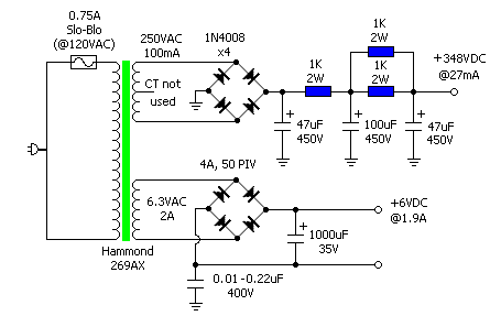

one more Q: do you think that omitting the 1K/500ohm resistors from the PS has its effect? I'm assumming Bruce didn't add them for no reason but OTOH 1800u sounds reasonable for a low load. which leads me to another question: what biasing class is this design?
I do a wild guess that the hum is caused by the build quality... not the circuit itself... metalwork looks rather crude.
Changing R5 means the the output tubes draw a lot less current... probably only 3mA instaed of 10mA... which is rather strange because now the output tubes draw less current than the input? (I built the MJ variation of this amplifier...)
Are the RCA inputs isolated from the chassis...? I can't see any isolating washers...
no, they're not isolated. that's a good point, I totally missed that.

Don't understand that one :confused:
No you can't remove R5 as it is the biasing resistor and if original is 220 ohm
I think the designer has good reason.Can MJ be the japanese magazine?
IF so the japanese like to bias with low current for long life of tube and to them may sound better?But if you bias at now 1K like Stixx said at 10mA
then you are running it hot so don't expect to last long but if you like the way it sounds at high current so be it.
regards.
Edit: So now the bias is 3mA? That's up to you,but I think you would want more current?.If you omit the series resistors of the power supply as they form a RC filter for ripple then you just have capacitor filtering and not a pi filter but if you do follow the original then I'm afraid your B+ will change and you will have to readjust the anode voltage.
I'm talking about the 1k/2W resistors in the power supply. I understand that R5 is a biasing resistor (the parallel cap would indicate that) and can't be omitted.
PS: what japanese magazine are you referring to? MJ stands for Morgan Jones if I understand correctly

When the builder left out the series resistors in the psu (????) this is a strange one... because then he changed the topology from CRCRC to C only... which would mean much worse filtering of ripple.
Btw. you can easiliy simulate psu topologies in PSUD2 (free download) to get some insight... maybe the builder left out the R's since he didn't have enough voltage to start with? You definitely need at least one R in your filter... like CRC.
Ahh.... that's the voltage droping resistors to get 348V but if your circuit is not using 348V and something lower and most important your AC secondary
is not giving 250Vac then of course your value of resistor is different so
you base it on your transformer and circuit design, not the drawing.

oh, I get it. the original designer had only that Hammond transformer at hand and used the resistors just for dropping the voltage.
PS: I've been avoiding to call it a PI filter as AFAIK the nomenclature refers strictly to the case when a series inductor is used
