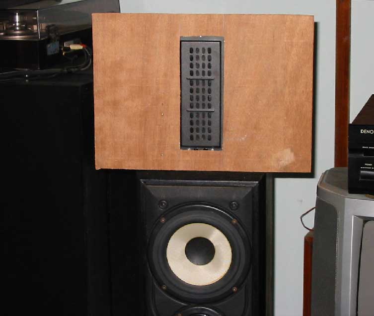

Hi Leadbelly,
I have a pair of the Neo8PDR's. I was also very worried about the large HF peak above 10Khz and the subsequent rolloff.
I use it in dipole mode in an active two way system ( on trial).
The Neo8 is crossed over at 600Hz with a -12db per octave crossover and the woofer is crossed over also at -12db at 600Hz.
The woofer is a 12 inch Peerless( classic range) in a sealed box with Qtc just under 0.7. The Peerless sounds remerkably good even when rolled off at 600Hz. The sensitivity levels have to be matched. This is easy as the system is active.

In the picture the Neo8 is standing on the Mission 701. The Neo8 baffle is 14 x 10 inches. I also tried the Mission 701 as the woofer
( active crossover) and it isn't any better than the Peerless. Bass is of course much worse than the Peerless.
