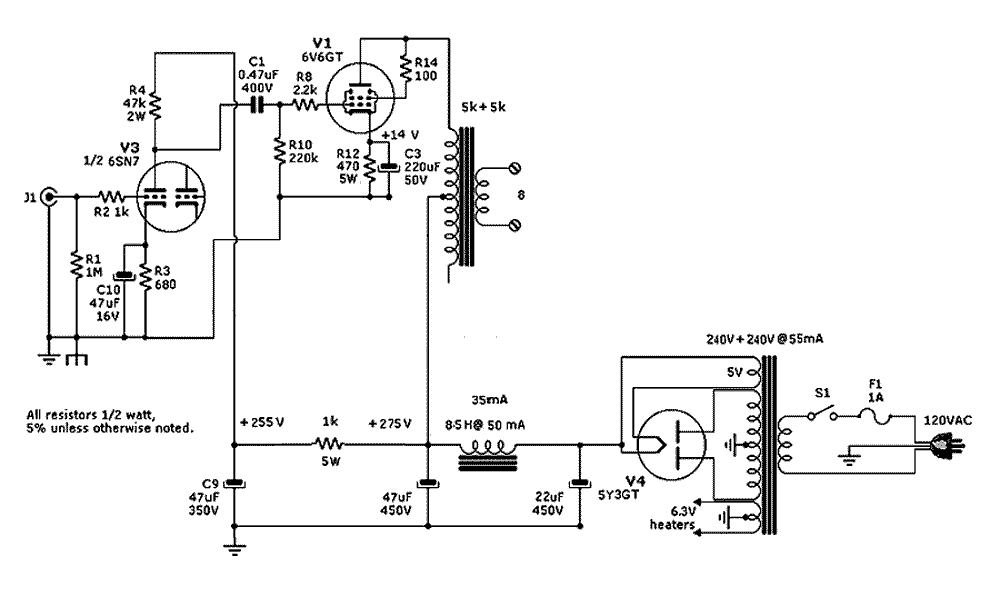

So, I decided to build my first low-power valve guitar amp. In the past I built some amps but I haven't used tubes inside them since now. I have one Russian 6P6S tube (it's electrically identical with 6V6) and it will be a base for a power amp.
As a preamp I would build this, if possible. I mean if it's possible to match the power amp on 6P6S (it's a must, so if I have to change my idea I'd rather change the preamp). I would be very grateful if someone here could help me with a schematic for this :)

I´ve done this one and I have no complains.
and it´s very simple.:cool:

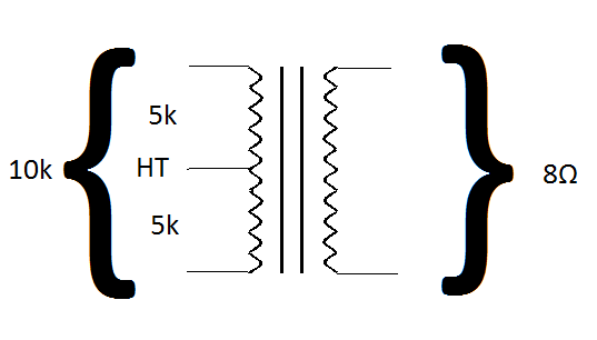

You've not really connected B+ to the center tap on this transformer have you? In this configuration an 8 ohm load is only reflecting 1/4 of the total primary impedance to the 6V6.. (Also only 1/4 of the primary inductance)
I have no clue if this transformer has a 20K primary as would be implied by the 5K + 5K shown in your schematic (unlikely) more likely it is a 10K primary in which case the impedance reflected to the plate of the 6V6 will be about 2.5K which is a bit low for good performance. A proper gapped 5K SE output transformer would probably provide better performance.
There is a second triode available for use with your current tube line up, should not be too hard to get the additional required gain across two stages.
its a 10k push pull transformer using only a half of it ,just in case of not having a 5k SE opt.
the other half of the 6sn7 can be used for more gain, or in case of the need of another SE module if you dont want to miss use it (a 6sn7) you can also put in the same circuit a 12au7 or a 6n1p or a 6j5 leaving all without changes.
