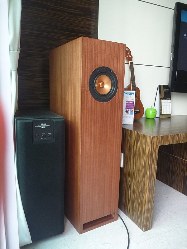

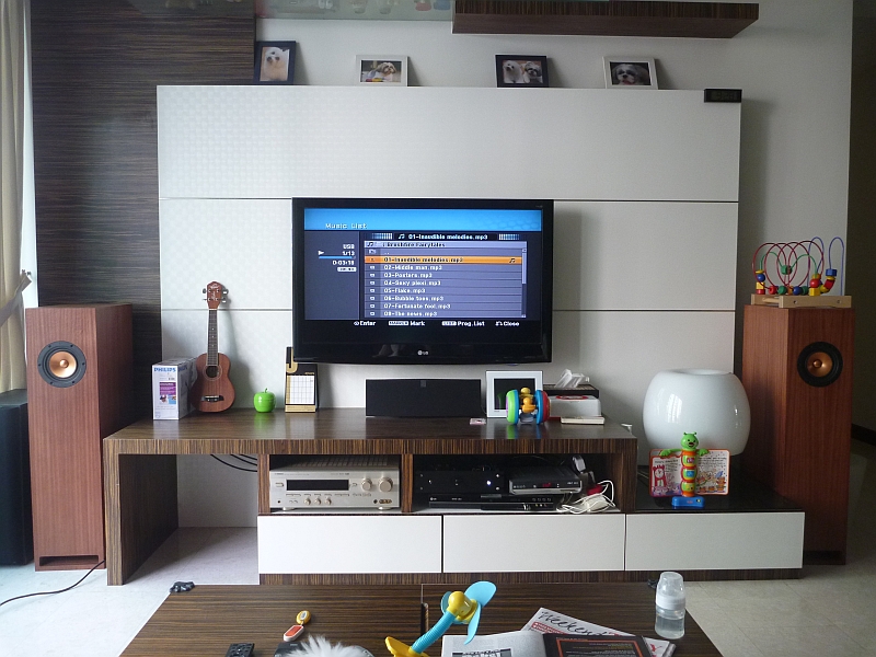

Finally got the cabs back. Marine ply veneered with Sapele veneer, finished with waterbased polyurethane. I quite like how everything turned out. Pensil cabinets have high wife acceptance factor.
Still a work in progress, I'm currently running Arjen Helder's tube buffer/TA2020 T-amp, LG Hardisk DVD recorder/player into the Alpair 10.2/Pensil. I'm in the midst of building a USB DAC to feed my laptop music files.
Being quite new to hifi and stuff, I won't be able to contribute much input for comparisons but coming from the system I was running, KEF Coda 9.2, Alesis RA-100 amp and Marantz CD5000, this new setup is so much more detailed and clear. Its like taking a thick curtain off my previous setup.
As for the reason of adding another driver/electronic crossover, I guess there is no strong reason other than why not? DIY is becoming quite affordable to be able to experiment and experience.
All in all, I'm very pleased with what I have now and looking forward to the addition of dedicated DAC.

You've made a great looking system. Reminds me of Graham's A12 stereo/HT set up:
Graham's hifi page
Glad you're enjoying the experience.
Mark

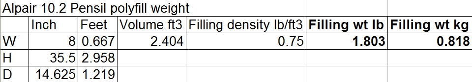

I've just bought more polyfill for the cabinet. Stuffed it to the right prescribe amount 0.75 lb/ft3 which translate to around 0.81kg for the Pensil 10.2. Quite packed!
WOW, now the bass is tight and solid. Played Portishead - Dummy and I could actually "feel" the bass while the vocals and instruments remains clear and defined. I'm really impressed with Mark's Alpairs! I wasn't expecting this when I decided to go the full range way.

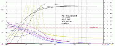

FAST should work well. If you keep the A10.2 sealed you can just use the 2nd order roll-off as all, or part of, the high pass filer.
9.2 liter sealed gives a Q of 0.707 with an F3 of 71 Hz. If that is too low you can actively filter it (you don't want to use passive that low)
