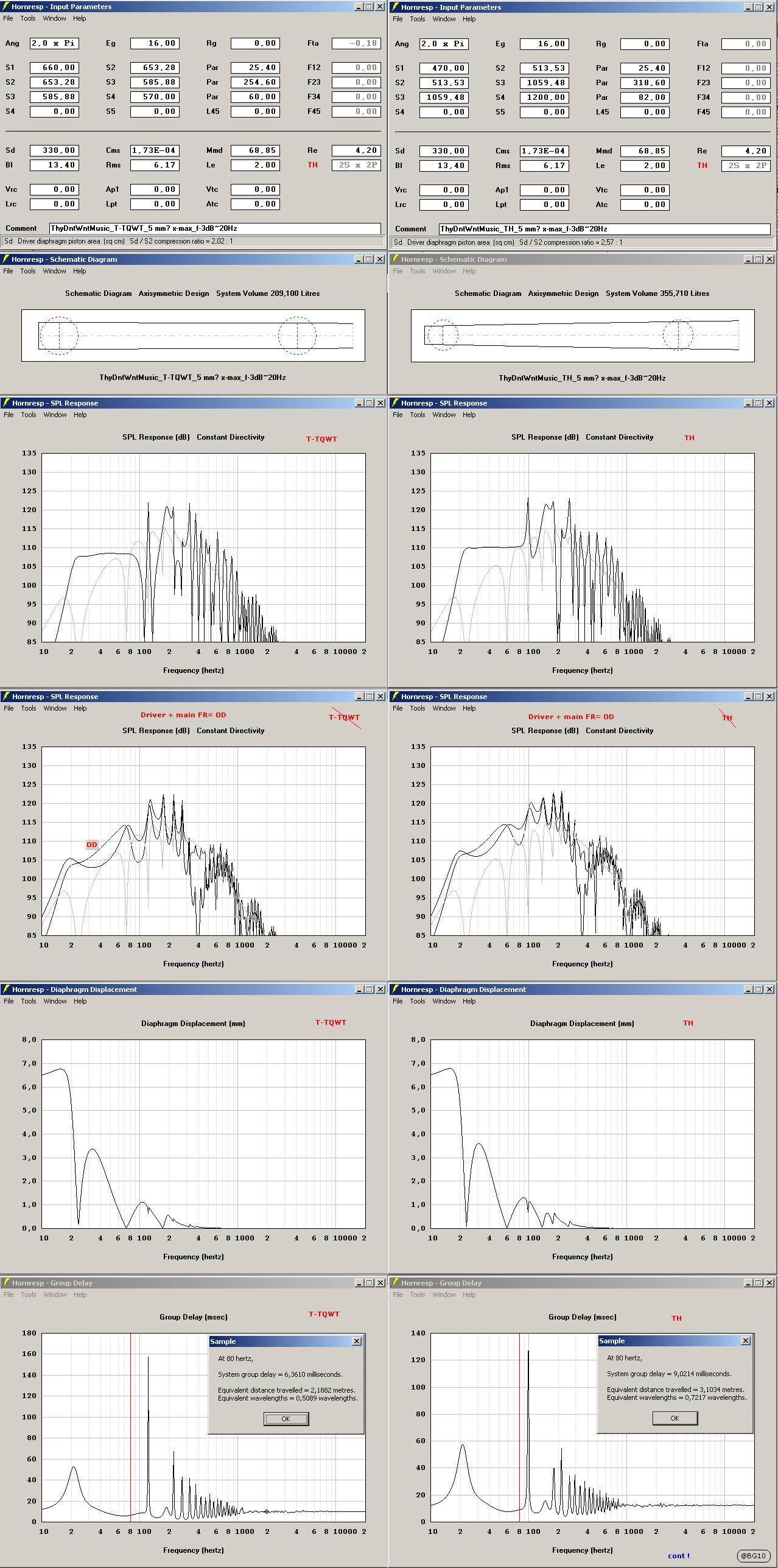

I've currently got them modelled in a 2.4m long (total) tapped horn.
165cm^ throat, 330cm^ mouth, with the woofer 15cm from each end.
it gives a theoretical 103dB 1w down to 40Hz, but the mouth just seems way too small to yield that kind of efficiency.

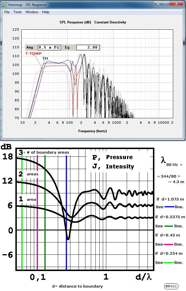

I had modelled a simple, single fold 240cm horn, with eight woofers in it...
one thing I noticed though, was that if I doubled all the "S" figures, and the number of woofers, hornresp suggested that the frequency response would change, and it would play lower...
is this correct?

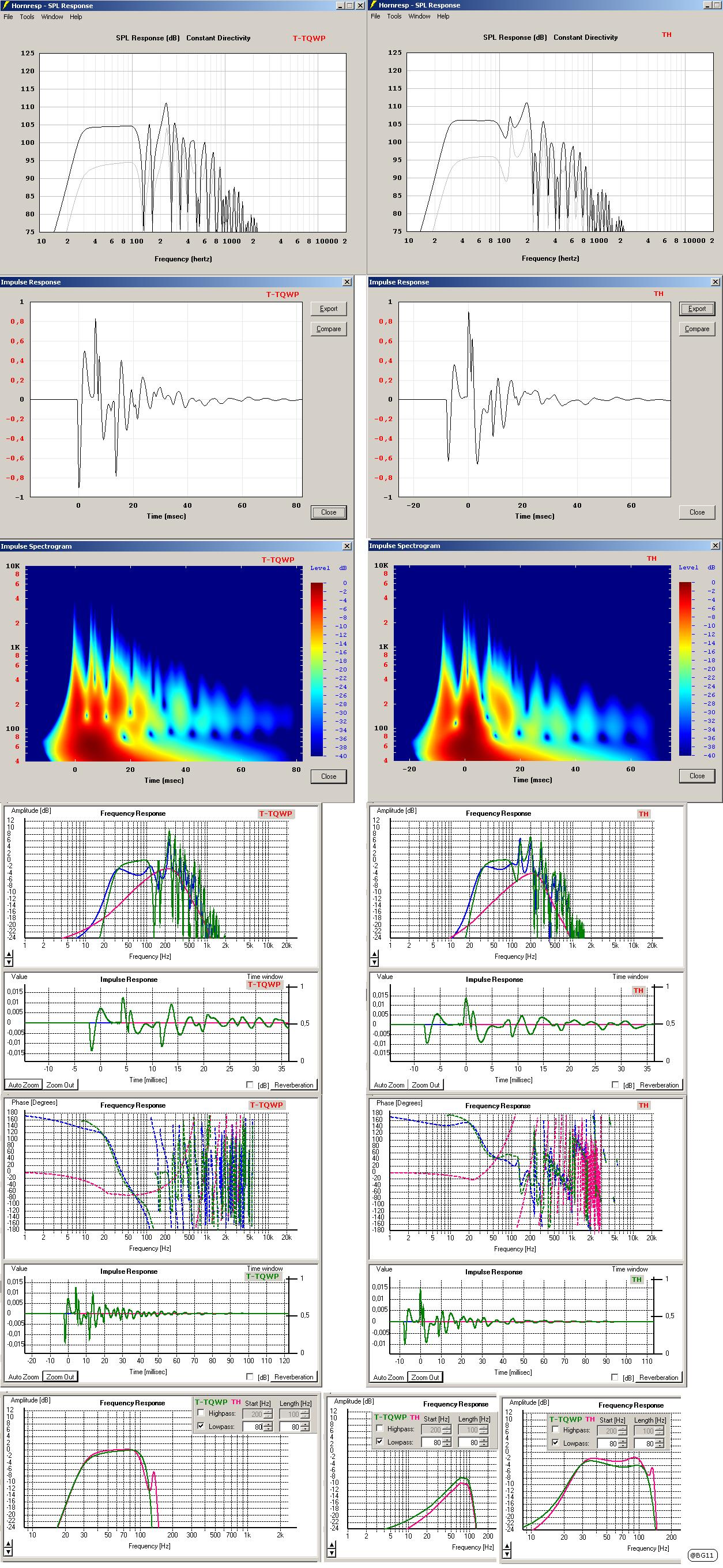

FYI:
b:)

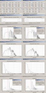

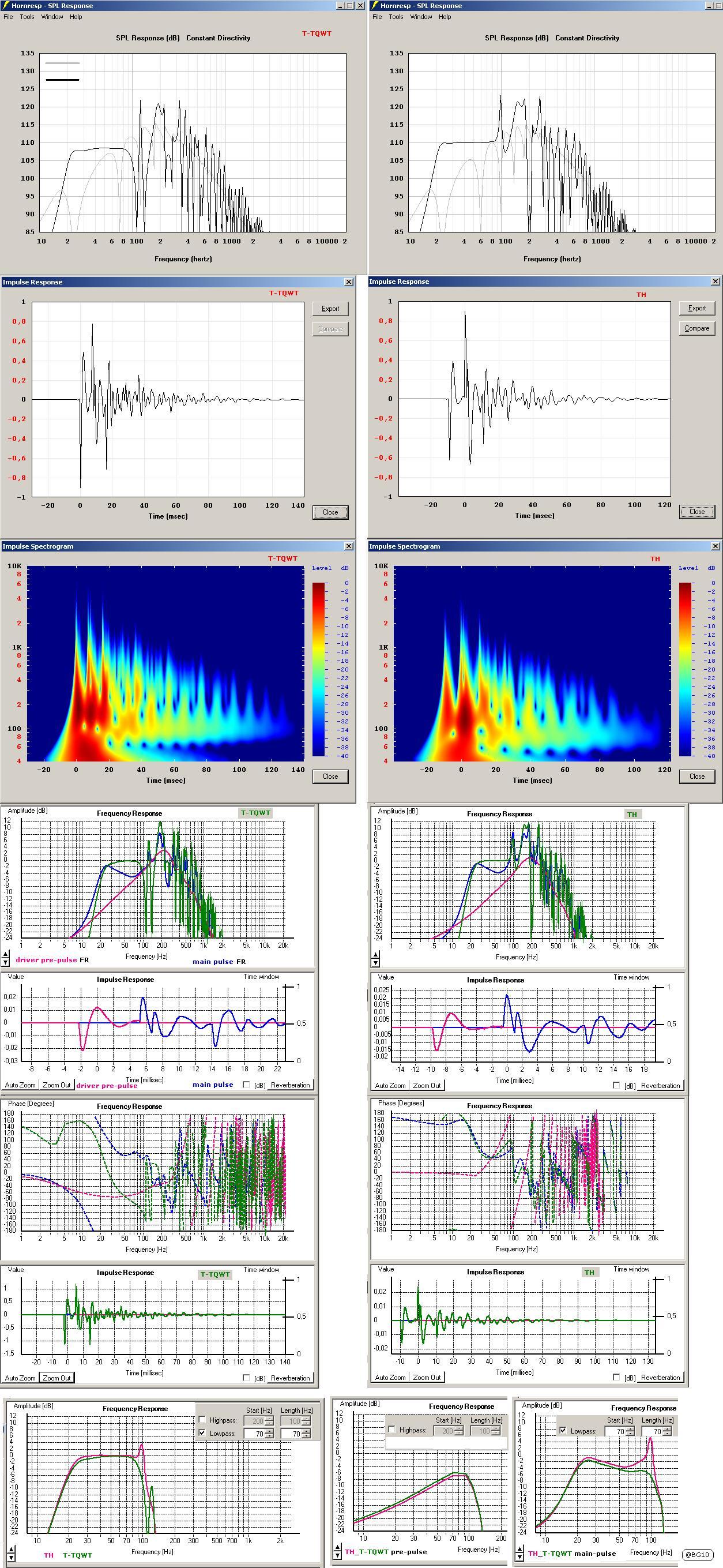

I'm considering just doing the design in black and not worrying about 30Hz and below.
same power as the grey line (which is your TQWT) in 8th space, with 1 watt.
Sorry for neglecting the 30 Hz requirement: That is IMO, a better choice for your drivers than what I came up with :eek:. See the revised simulations for closer down to ~30 Hz and promising more improved SQ performance.
How do you know when your design are within 8th-space? See the 8th-space picture?
b :)

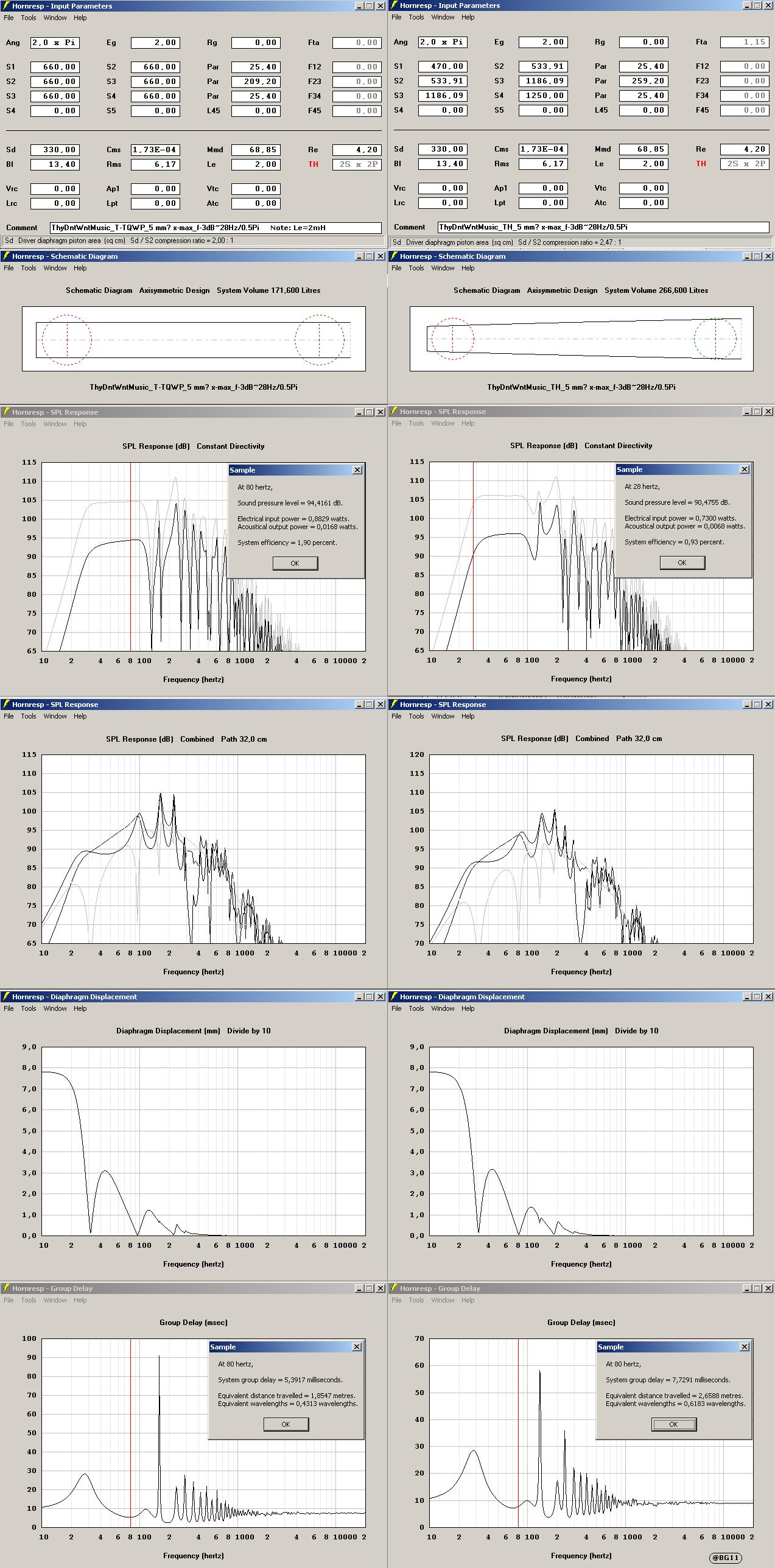

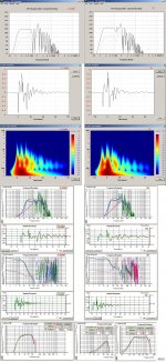

b :)
what do you mean by that?

what do you mean by that?[/QUOTE]
IMO,You cannot count on 100% 8th-space boundary in-band gain for a realistic design to reach 150 dB/1m using all your drivers. I think at most would be around ~140 dB (Accompanied with lot of hear-able distortion and other artifacts included too, of course).
I did quite like your first design, but I felt they were lacking the efficiency to reach 150dB
:eek: I try to support SQ in my designs and for home environment: I would never endorse SPL levels that would permanent injure a listeners ears.
