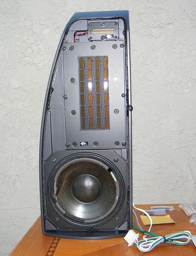

I purchased the Fostex RP9 speakers at swap meet for 30 bucks. They appear to be brand new in the box, so using the mid and tweet will possibly save me money in the long run for total cost of components. The woofers were not usable due to age and some cone damage (Fostex use to be close to where I live, and I have a suspicion these were refurbished or new old stock someone got when they closed down). I will need to find other woofers.
The tweeter is of unknown model number. I have a suspicion it is an ft7rp without the front bezel or faceplate, possibly. It is a super tweeter.
The midrange is the fs21rp.

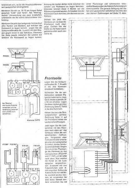

First picture is of the rp9 that I got. It has an 8 inch woofer for scale reference...

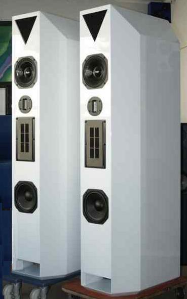

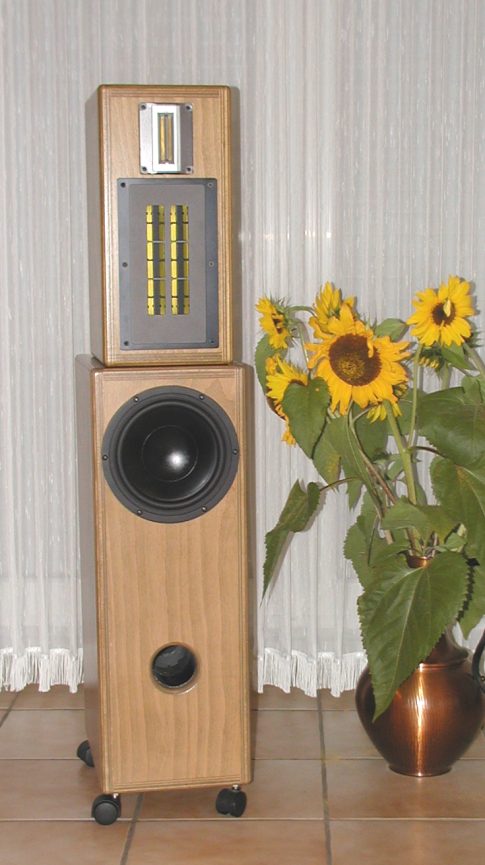

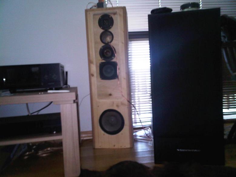

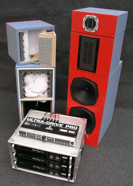

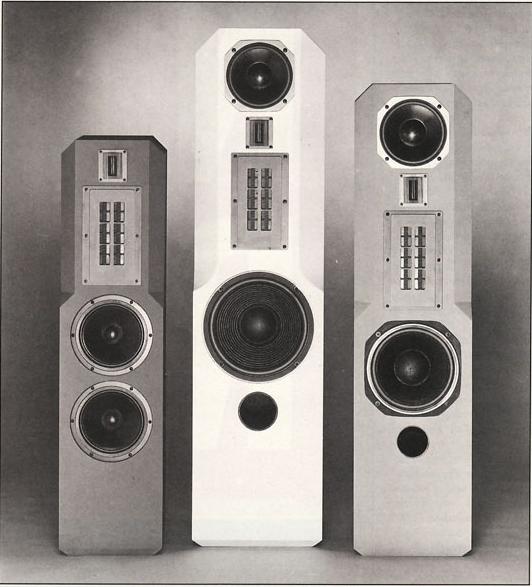

The rest are RP series pictures I found online.
I also threw in a couple of other pictures I found interesting, although using different ribbons altogether.

Here are some pictures and a little info on the RP series.

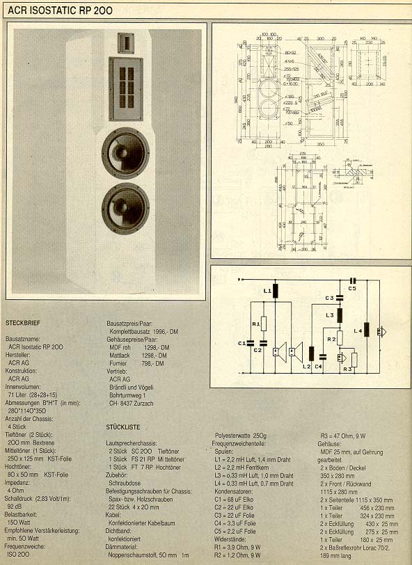

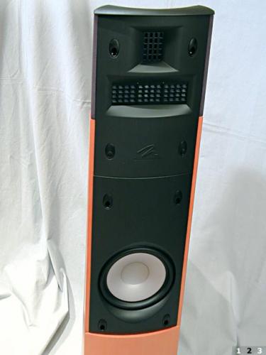

Here is a cool picture I found. I like it a lot
Looks like an enclosed mid tweet version of what I want to do... Looks to have amp for tweeter... Maybe overkill for me? I dunno

I found the info on the enclosure! If you look at the spec sheet for the rp200, you can zoom in and see the total enclosure volume for that design is 71 liters. They break it down to the drivers, and its 28, 28 and 15
Cool. So now I know that if I go with the sealed enclosure on the mid, it's 15 liters. Awesome!

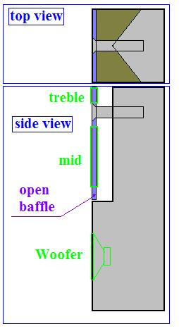

The sound of a good OB is worth it all the way!
A good idea came into mind, it is attached below. I don't insist on the proportions.
It combines a TL and a OB. Actually the original idea is this one: Enclosure Design and Construction for the Lowther DX Series of Drivers, but upside down.
I have tested it upside down and adapted to another woofer and the results regarding the low frequencies is great. With the opening at ear level the perception for very deep and convincing bass is very strong.
p.s. don't mention my woodwork skills - I am just testing the idea...

I you are going to use subs anyway (i thought that you said "music only")
then no need to go under 100Hz.Twin 8" will give you omph and speed.
Try the Hivi golden cone ones that will match the color of ribbons!
Cheap too.
For a chamber resembling the shape of the RP-21 you only need about 15cm depth.
Stuff the 2/3 rear part with Acustastuff or similar and you're good.
Don't opt for too warm 8" cones.They have to be fast and have good
strong magnets to start/stop on par with the planars.
Unless you can find the Fostex FS-41RP (he,he,he) that would cure your problems...
