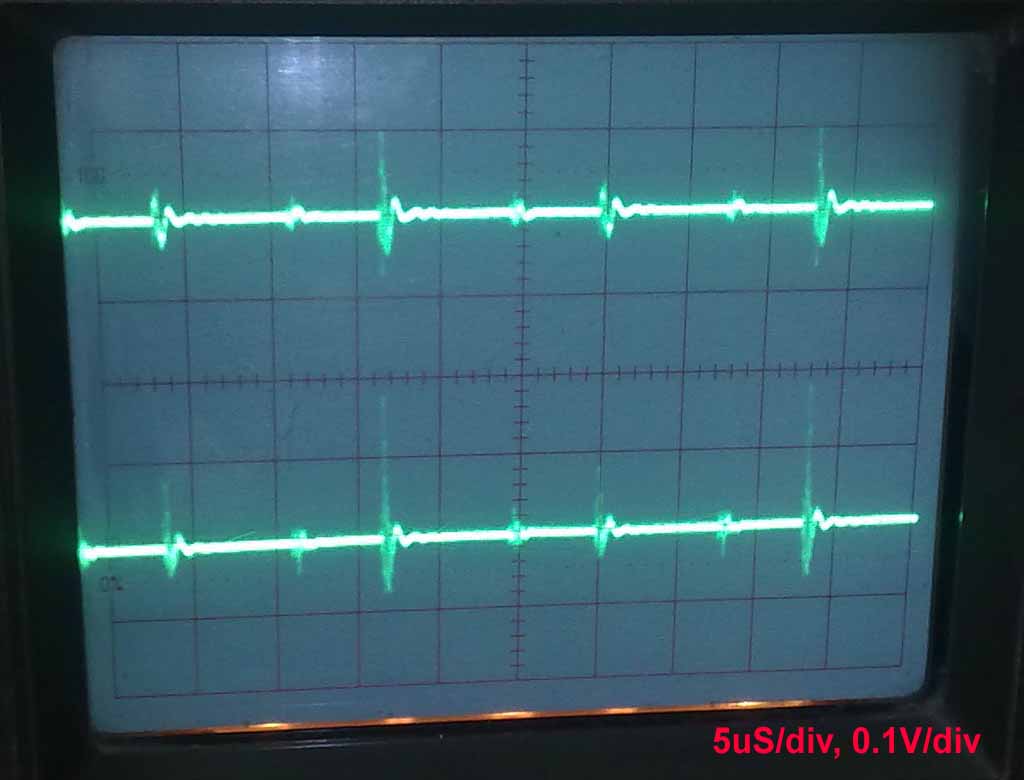

From the output, I can’t see some oscillations or big noise… looks fine for car amp. There are some HF spikes with level of about 150-250mV (f=40, 80, 100KHz) , comes probably from power supply.

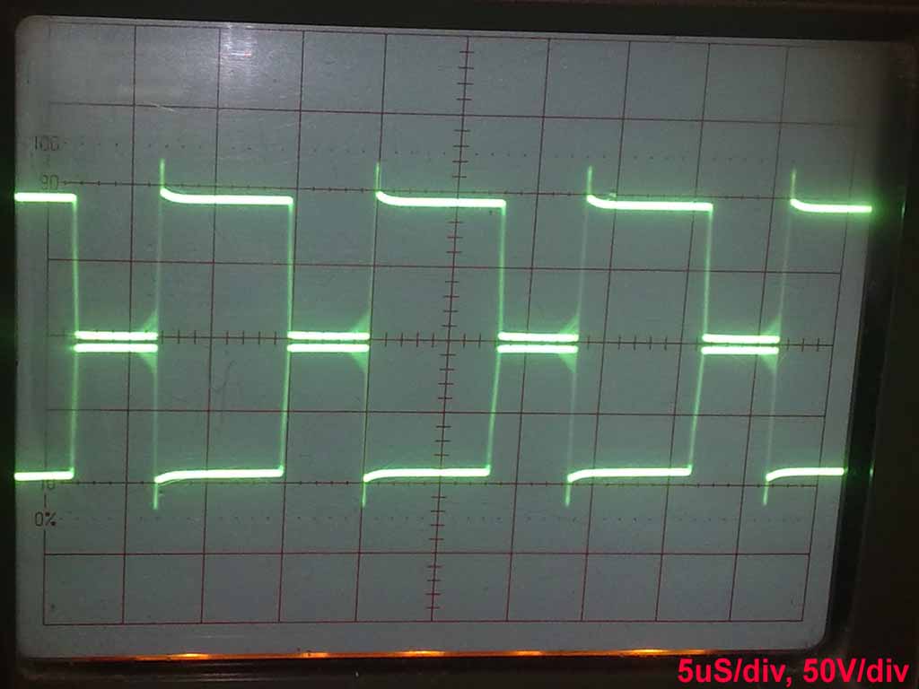

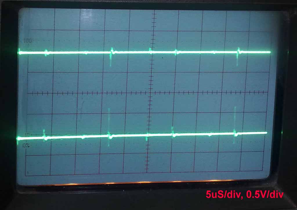

The output without signal and load looks like this:
attachment.php
I checked with oscilloscope some points shown here:
AC voltage on positive and negative rails to GND2 (measured +/-56V (+/-50 on schematic ???))

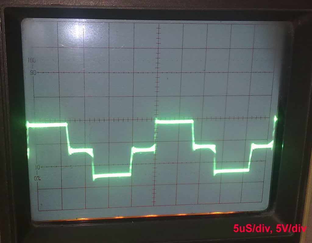

Voltages on the both inputs of the inductor L1 to GND2 (after rectifying diodes – pin 2 and pin 3 on L1):
attachment.php

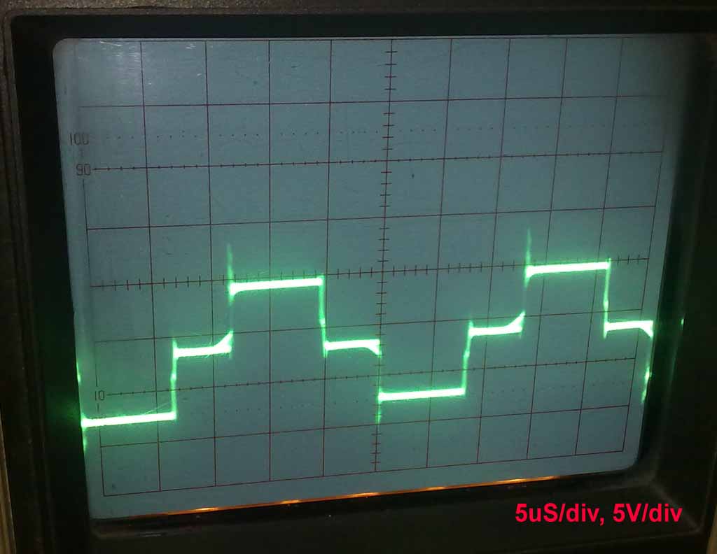

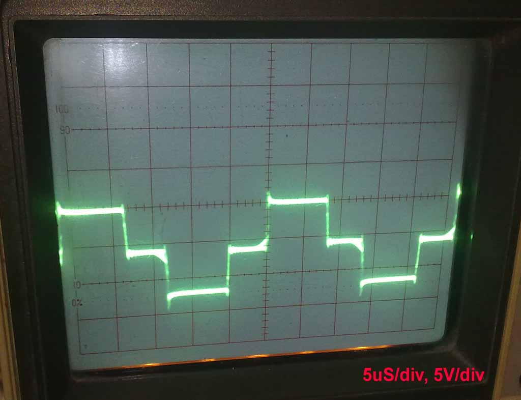

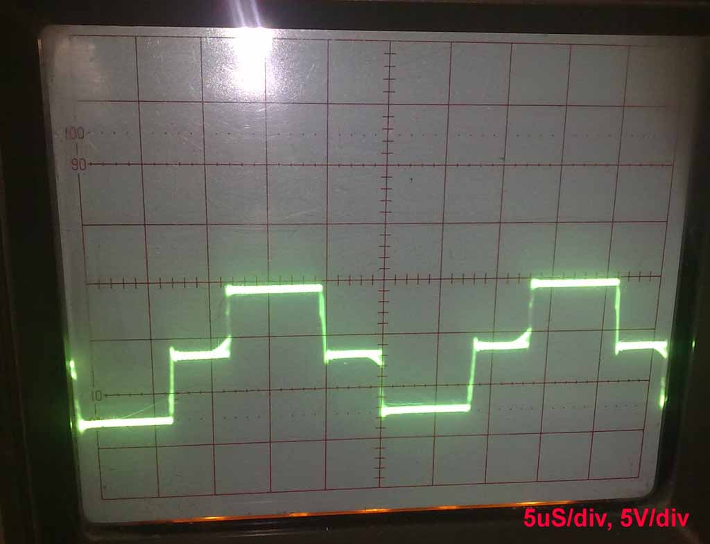

Voltages on the outputs of PSU MOSFETs to GND1 (common S-D of Q11,12, Q5,6, Q67,68, Q73,74)
attachment.php
attachment.php
attachment.php
attachment.php
(GND1 & GND2 are grounds before and after pulse transformer T1.

I don't see anything out of the ordinary on the waveforms you posted. Maybe 1moreamp can offer some suggestions.
