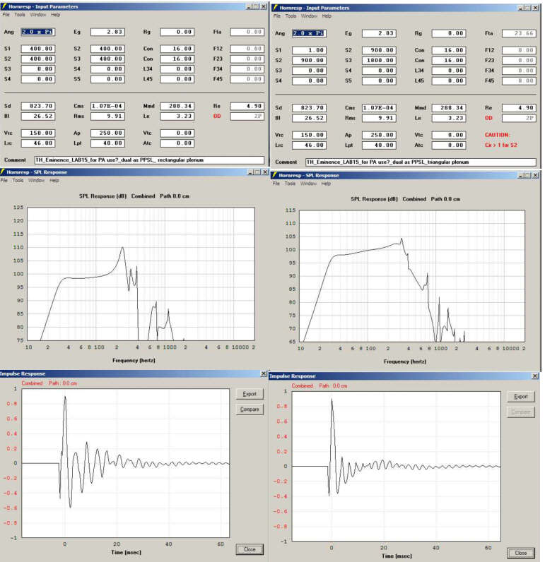

Shape of plenum chamber
Hi guys,
When looking at some models in Hornresp I found a pronounced peak in the PPSL frequency response that does not seem to be easy to tame. This may just be something I'm doing wrong, or it may be typical for this type enclosure. I then changed the plenum from its rectangular form to a triangular form and the peak becomes much easier to control in the model.
Maybe somebody who knows something about PPSL enclosures (e.g.: djk :)) can shine some light on this; or maybe we're on to something.

Hi djk,
I spend the last week rebuilding my computer after a virus attack.
It makes sense that the volume reduction inside the plenum would make a difference, especially if the plenum is kept to a minimum.
Thanks for the additional information.

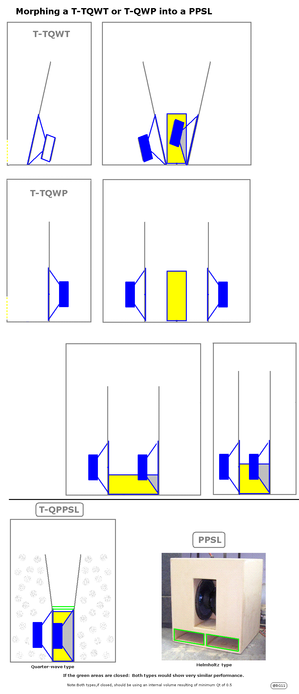

..2. Can you comment on the usage of PPSL for Home Theater? I've only seen you and Les building them for PA. Some users have commented that they won't work well down low??
HI,My :2c::
I would guess the PPSL shares similar SQ performance(= high) with a T-TQWT/T-TQWP if build sturdy, i.e. not letting any CSA:s larger than ~10”x 10” to be un-braced.
The differences when placed in a room would be : The PPSL sums sound pressures in the far-field thus shows directionality but the T-TQWT/T-TQWP acts like an omni pressure point-source and is not sensitive if placed jammed very close to other in room objects. Its like comparing in room performance using a closed sub to a corresponding ported.
..Please correct me if I am wrong--
My current thoughts are to build a dual opposed PPSL. Why?
a) The design is easy, its like a Dual Opposed Sealed but with one driver and mount facing in.
b) In terms of modelling and building it, as long as I have enough internal space and amp power, what else should I worry about? Other designs have angles, horn length, port length etc. This design is a sealed box ..
Comparing a closed PPSL would be like to compare with a closed T-QPPSL( easy to simulate in HR): Both offering very similar performance: Internally the the PPSL behaves like an ordinary closed box but the T-QPPSL like an closed TL,i.e. Lambda/2 behavior. See the picture:
b :)
Hi hawkson,
Sorry, but I don't get what you mean with: "...a dual opposed PPSL... its like a Dual Opposed Sealed but with one driver and mount facing in..." Could you, please, provide a sketch of that arrangement?
As to the design of the enclosure, keep the driver plenum(s) as small as practical, and follow the same general rules you would use for a sealed box (or for a vented (bass reflex) if you decide to go that way). It may be interesting to design the box with ports you can stuff, or close.
