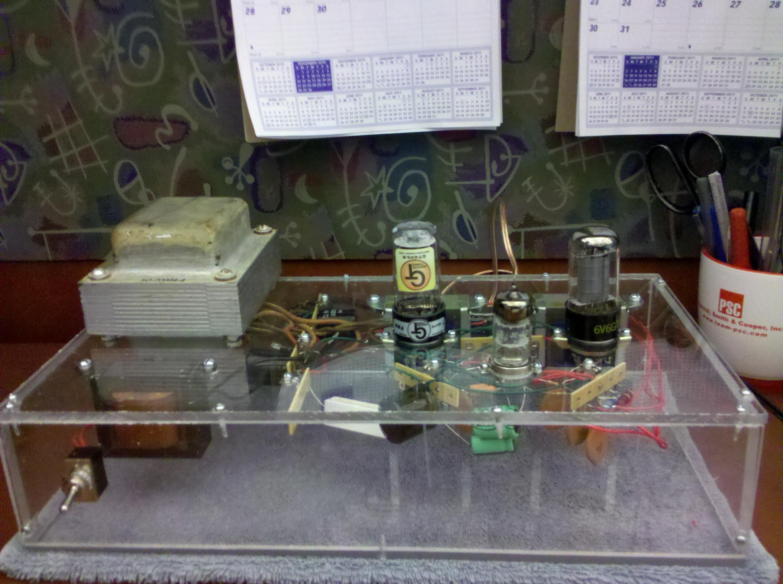

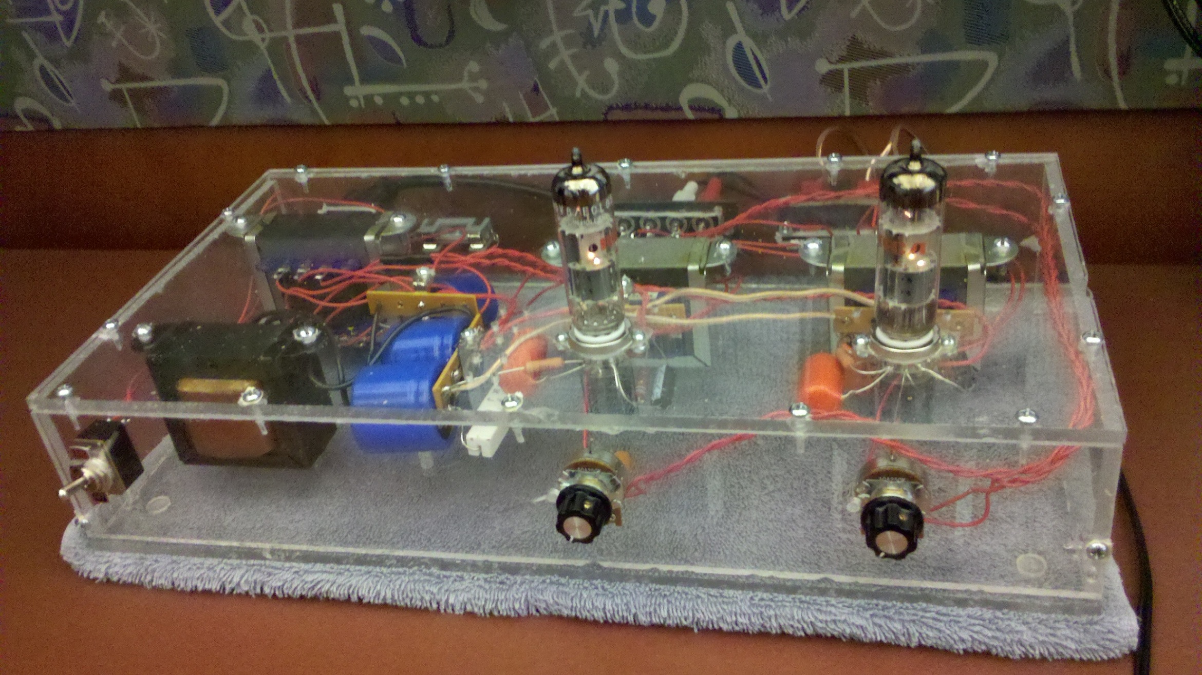

Well, after going through thanksgiving and working through the design. I had a spare transformer that was a little larger that could handle the voltages a little better. Here is a schematic of what I ended up going with. I am still up for some modifications if someone has any. Also I have one correction to the schematic that I have drawn. I have a choke from the diodes to the first capacitor. The choke is 7H and 240ohm. Let me know what you think. I have also included a picture of the amp. Thanks in advance.

If you still look for a bit higher anode voltage, put an electrolytic capacitor before the choke. This could rise the supply voltage a little.
Couple of other comments;
You could use separate cathode resistors at output tubes. This improves possible unbalance between tubes.
Since your output transformers are not the best for 8 ohms load ( too high turn ratio) you could also add a light NFB, for example by connecting the secondaries of the output pubes in series with the cathode resistors, (and with correct polarity).
Usually the linearity of the output stage is improved if some 470-680 ohms series resistor added between UL-tap and g2.

So last night I went back with some of these suggestions to implement them. The first thing that I did was separate out the 6v6 bias. So they both now have 470uf caps and 500 ohm resistors. I then took out both cathode bypass capacitors off the 12at7's. I then fired up the circuit. It sounds golden.
I then went ahead and decided to put a filter cap before the inductor to see if I could get the high voltage up to about 350 or so. I put in a 67uf there and now my high voltage is at 460 or so. not so good on the 6v6. However not a bad place for a 6l6g right?

Not necessarily bad for 6V6 since your output transformer has a bit too high turns ratio for 8 ohms load. Now with 450 volts anode voltage the tube works at higer impedance level, assuming the anode current is at right (=lower) level.
Now your bias (cathode voltage) should be some 15 volts if cathode resistor is 500 ohms. If not, adjust cthode current to 30 mA.
And, yes I know the max. anode voltage rating is 315 volts, but so what.
Main issue is that the max. anode dissipation is not exceeded (too much).
Actually 6V6 may sound great with this unusual bias - anode voltage - load resistance combination.
