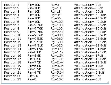

I am planning to design a stepped attenuator based on the C7D0423N rotary switch available from Electro Switch. It is a 4 deck switch having 23 positions. I am not sure on the method to identify the terminals and the method to connect the resistors. Can someone suggest me a method I should follow.
I am attaching the C7D0423N manual along with the resistor tables for reference.
