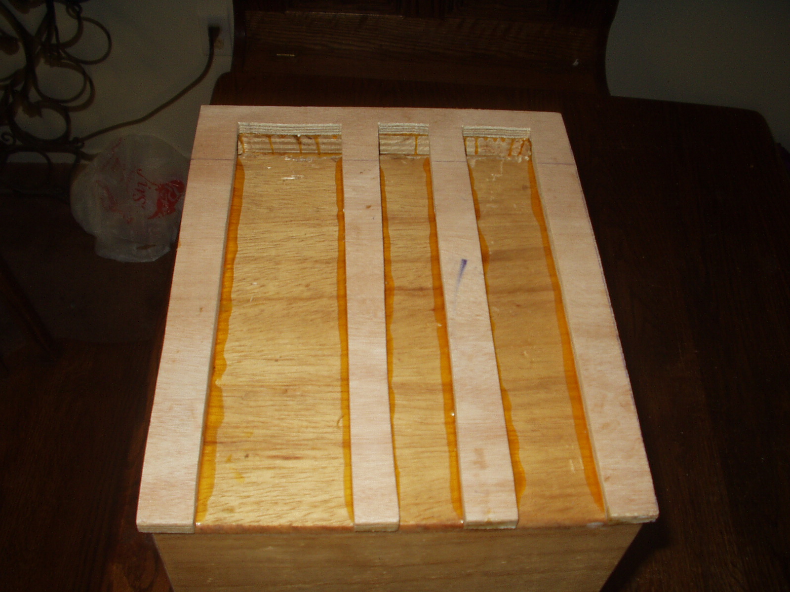

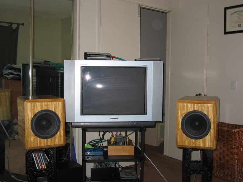

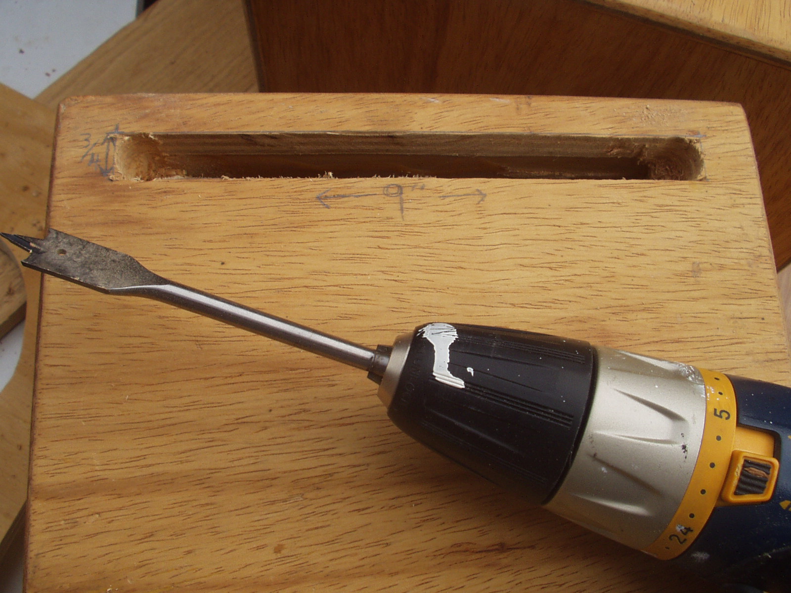

I have good results with some 25L semi-aperiodic box (30Hz tuning), and a supertweeter (Dayton ND20FB-4 IIRC) mounted coaxially. The small box gives it a bump that manages the baffle step reasonably well in my room, and the damped slot vents (down firing) worked well to hint at the deeper stuff without demanding massive excursion.

Attached are pics of my standmounts, and the slot porting method. The back panel attached over the strips.
