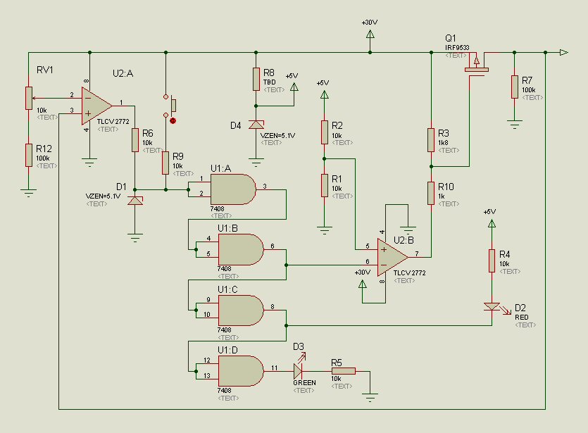

I need electronic scheme of the current limitation circuit on the scope of 20 mA to 2A, working voltage up to 30V DC
circuit should have little resistance, because after him I'd put LM317 to adjust voltage from 0-30V
little about the circuit:
need to have 2 states:
1st state - conducting - green LED glows
2nd state - not conducting - red LED glows
when the current reaches max value it should remove current completely and not to hold a limited supply, like real fuse
of course, point to expulsion can be adjusted by potentiometer
does someone has such a scheme?

i guess i need voltage comparator and flip flop or at least IC that has those

you made schematic based on my specifications...impressive
and you are measuring voltage drop on mosfet itself as i see...thats not going to work,im afraid...what is going to be measured when mosfet isnt conducting?
this is circuit to start with...just comparator and flip flop to be added,i guess

When MOSFET goes off, R7 pulls output down to ground, feedback to non-inverting input of U2:A turns U1:A off, turns U2:B on, turns MOSFET off until switch is pushed when R9 pulls inputs to AND gate on, turns U2:B off, turns MOSFET on, turns U2:A on, holds AND gate on, holds U2B off, holds MOSFET on until voltage at output droops below pot set voltage.

ok,so it will work,i guess
but it is measuring drop on mosfet,right? it is nice idea not to have 0.1 ohm or similar resistor,but im not sure how it will work with measuring on such nonlinear resistor like transistor
can you make version with measuring on 0.1 ohm resistor just in case?
i wonder how would it looks with D or T flip flop instead of AND circuits?
