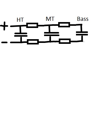

Hi
i wonder if this filter is a 6dB filter or is it a higher order? Its confusing me a little bit
the rectangles in serial are the resistors and the capacitors in parallel are the segments
Hello Quongelvis,
This type of filter is commonly known as a ladder network and is used with segmented line source ESLs.
The filtering is 6dB for each section of the filter.
In your circuit:
- the HT segment would receive no filtering.
- the MT segment would receive 6dB low pass filtering
- the BASS segment would receive 12dB low pass filtering

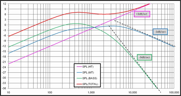

If you simulate your circuit for an ideal ESL with no mass and an ideal transformer with no losses you will get responses similar to what is shown in Attachment #1.
When simulating with SPICE, SPL is proportional to:
20*LOG[(current in ESL segment capacitor) / sqrt(frequency)]
In practice, the mass of the diaphragm and transformer losses roll off the high frequency response and you would get response more like that shown in Attachment #2

can i replace the capacity of the MT +HT panel by small caps in the passive bass-crossoveror is this not a good ides?
You can use capacitors in place of the HT and MT ESL panel capacitance to produce a 12dB crossover for a bass panel. But, the capacitors will need to be rated for very high AC voltage, not just DC. These are difficult to find and usually expensive.
If you want to use a passive crossover for a bass panel, it would be easier to to do it on the primary side of the step-up transformer since you would be able to use crossover parts values normally stocked for dynamic driver crossovers.
