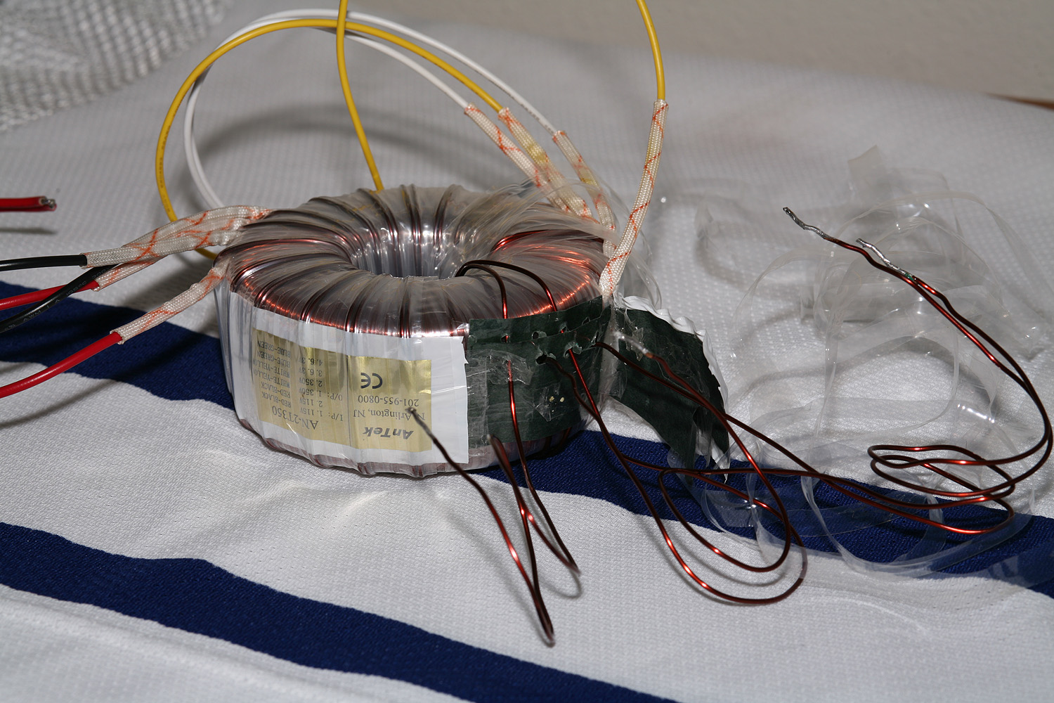

Folks,
I figured I'd share... Transformers are not exactly rocket science, but some people seem to be a little intimidated by them.
I have an Antek 2T350 that I intend to use for a project involving 5AR4 rectifiers. These rectifiers have a 5 V filament. The trafo provides 6.3 V. What to do...
Option #1: Insert a 0.68 ohm resistor in series with the 5AR4 filament. This drops 1.3 V across the resistor and voila, 5.0 V across the filament. However, it also dissipates about 2.5 W in the resistor which will need to be gotten rid of.
Option #2: Unwind the secondary a little bit to change the turns ratio from 120:6.3 to 120:5.
I opted for the latter on this project. I counted 21 turns on the secondary. So a little back of the envelope math:
6.3/21 = 0.3 V per turn
5/0.3 = 16.7 turns
So to get a 5.0 V winding, I'd have to make a 16.7 turn secondary. 17 turns aught to be close enough... So if I remove four turns from the existing secondary, the voltage should drop to 5 V (maybe slightly higher). So I set out to remove four turns...

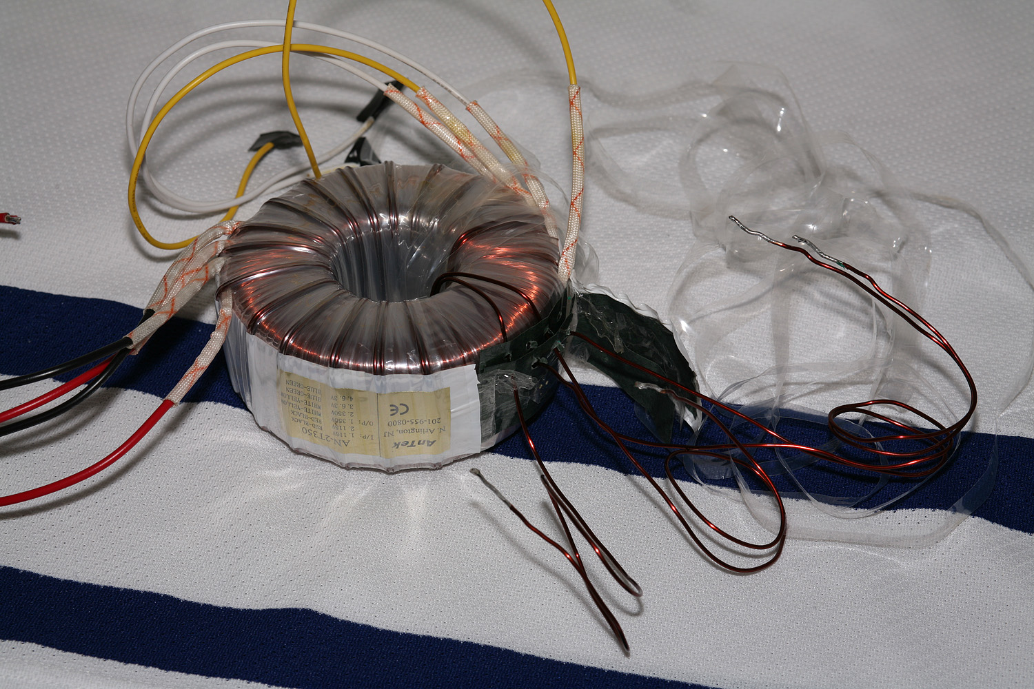

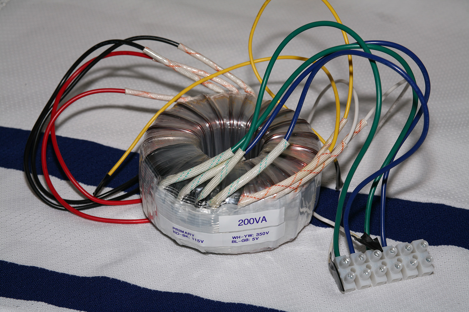

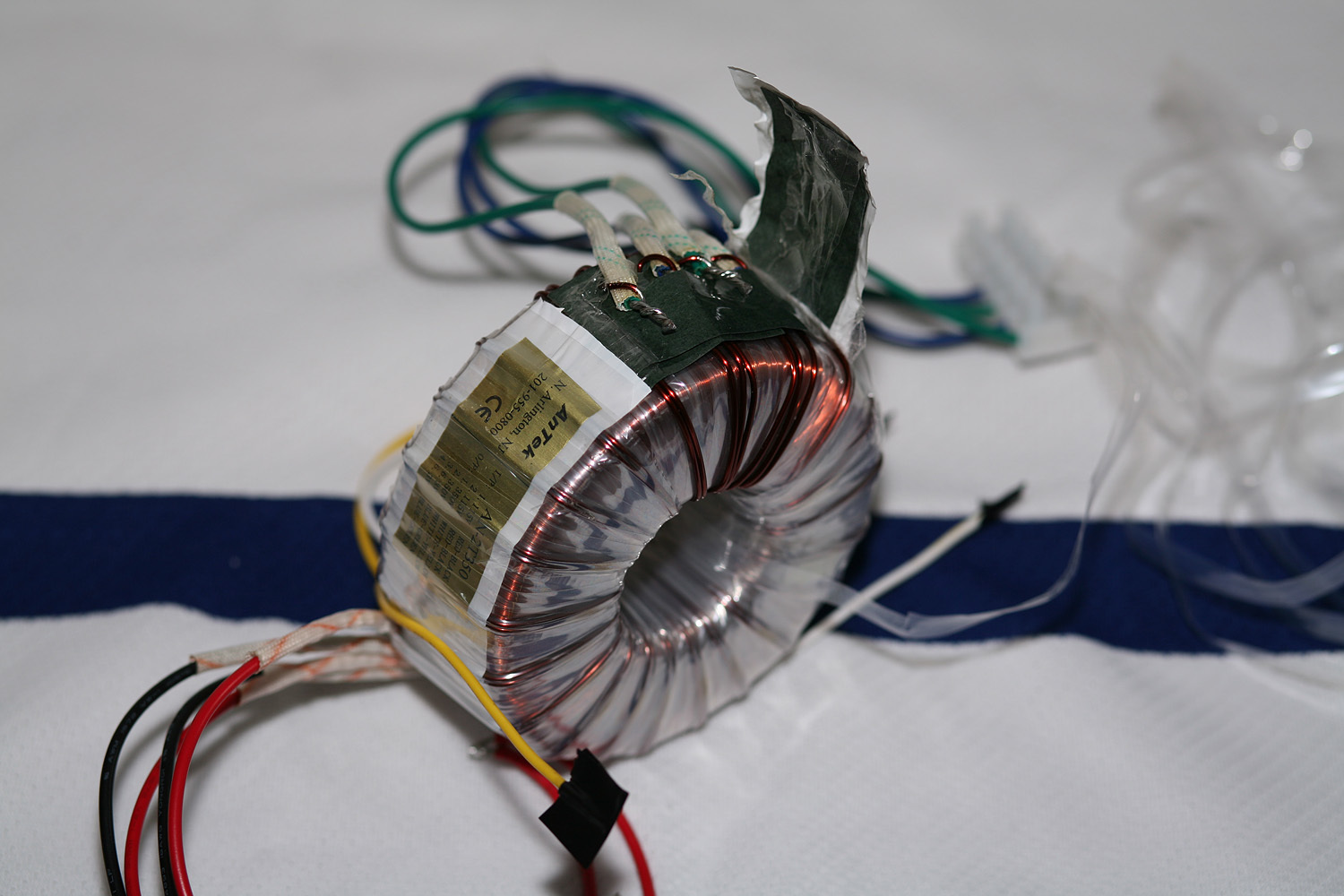

It's quite straight forward. The tape end of the plastic film wrapped around the transformer is found and the tape is removed. Then the plastic film is carefully unwound enough to expose the secondary connections. Taking care not to nick the windings, an exacto/utility knife is used to cut back the adhesive tape wrapped around the core. Note how the ends of the two secondary windings are interleaved between a piece of card stock to ensure that they don't short out. Pay attention to the sequence of the wires. I removed two turns from each end of each winding. The turns are actually bunched up slightly at the termination point, so I could do this and still have the secondary evenly spaced across the circumference of the core. With the now 17-turn secondary, I measured the secondary voltage. I loaded the secondary with a 5AR4 rectifier for this measurement. At 115 V input, I measured 5.0 V. At 120 V, I measured 5.25 V. That's within the +/-10 % normally required for heater windings, so I decided to stop here.

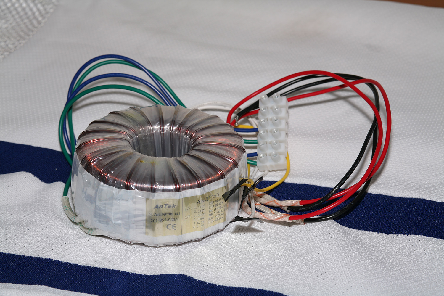

The secondary wires were cut, the laquer scraped off with a knife (followed by an emory cloth polish), and the old secondary output wires were soldered on. Then the windings were secured with tape and the plastic film was wound back on.
The whole process took me about 90 minutes including photography. With the transformer completely assembled, the output voltage on the secondary was 5.2 V for 120 V input.
Pictures from the various stages of the process below.
~Tom

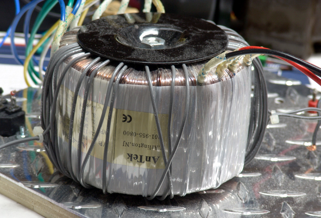

I have been using a slightly different and easier technique. Since I wasn't sure that the two 6.3 volt windings could reliably handle 300 to 500 volts between them, I decided to add another winding. In normal use the rectifier winding operates at the B+ voltage and the 6.3 volt filament winding operates at or near ground potential. The two wires are in close proximity and are touching each other in some Anteks.
I use two ways to add a 5 volt winding. The ugly method, and the pretty method. Since toroids are already rather ugly, the ugly method is my first choice because it is easy. How? Simply take a length of hookup wire that is rated for 600 volts and wind it through the core and hook it up to your rectifier tube. Neatness does not count, or matter. The only critical factor is the number of turns. How many do you need? That depends on the transformer. Some need as few as 11 and some need up to 20. How do you know? Wind 15 or so turns and measure the voltage. Add or subtract as needed. I start with a long piece of wire (about 20 feet) loop half of it through the core and wind from both ends. At 10 turns or so, connect a rectifier tube (or suitable load) across the ends, Tape up the HV winding so you dont fry yourself, and make a measurement. Heep adding turns until you are just over 5 volts. The voltage will drop slightly when all the secondaries are hooked up.
The pretty method. Use the ugly method to find the number of turns needed. Wind the new secondary with #18 or 20 enameled wire right on top of the existing tape cover. Solder hookup wires to the ends and apply heat shrink. Make a new cover by wrapping Kapton tape on top of the new winding.
The picture shows an Antek 4T360 with two added 5 volt windings. The Antek powers 2 Simple P-P boards, each wired for mono PPP and I am cranking the EL84's at 435 volts! Result...50 WPC!
