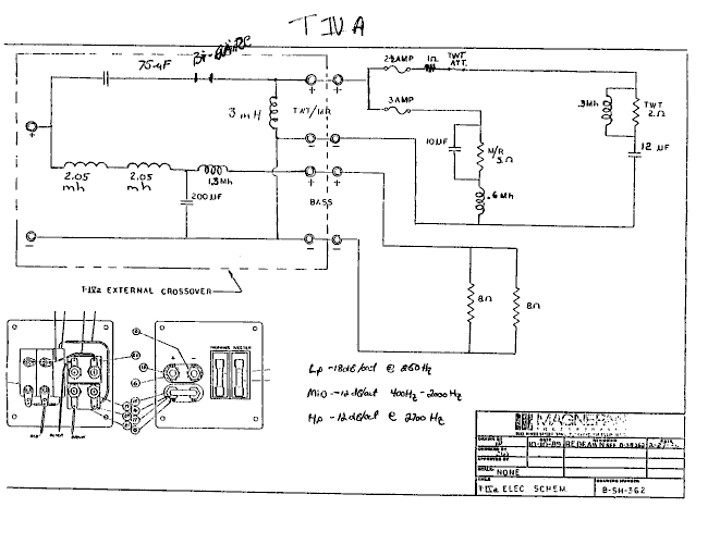

Hey all,
I have heard my Tympani IVa's with ICEPOWER ASP1000 monoblocks I built and also a Krell KSA-50 Clone I also built. I love what the Icepower does on the Bass, but prefer the Krell's mid and top end. So after looking all over gods creation, I found my Magnepan XO-1 Biamp crossover I had and will try biamp the Tympanis with both amps.
Now, looking inside the XO-1 there is no capacitor for the high pass (probably because Magnepan doesn't know the input impedance of your amp). The pots are there to balance the tweeter gain to bass gain and I know I will need to dial this in as the gains are quite a bit different.
For the cap value, I need to do a little math (C = 1 / (2*pi*f*R) with R being the amp impedance and f the crossover frequency for the mid/high pass), so Input impedance on the KSA-50 is 22K and the crossover is 400hz, yielding a cap sized at .0181uf.
But question is this... when the internal crossover inside the Mid and ribbon tweeter section already have the high pass cap, why would I need one on the XO-1? Am I missing something?
Joined 2005
Attached is the Crossover Schematic for the Tympani IVa. You can see the External Crossover, and the Internal Midrange and Ribbon tweeter crossover.
I would think I could send preamp out to bass amp to External Crossover and connect bass panel to Bass output of crossover, and for tweeter, send preamp out to tweeter amp to tweeter connection on speaker...the caps should knock out all bass frequency lower than 400hz... and using the XO-1 (without HP caps) connected to bass amp , to dial in gain differential on the tweeter and bass amp.

After looking closer, it appears that the midrange has no Hi-pass cap, just the ribbon does. So I would need the XO-1 to "trim off" all sub 400hz frequency before getting to the Mid/Tweeter amp, then go to the speaker panel.
Now I have also read thet the 75uf in the main external crossover needs to be cut out of circuit...don't understand why. I will put a switch on it. Maybe thats what that Biamp Switch someone wrote in on the attached crossover schematic means....

Hi John,
Given that the instruction manual you posted says "<i>for IIIa <b>and </b>T-IVa</i>" I would assume these two models must be configured similarly. By this I mean:
* my IIIas had an external XO box which had the bass LP & mid HP filters, and an "internal" XO which was the mid LP & ribbon HP filters.
* so the T-IVa must be the same?
Now the external box has 1 pair of input connectors and 2 pairs of output connectors. So I can't see why you wouldn't configure it as follows:
* wires from bass amp go into the external XO
* just connect the bass output wires to the bass driver input connectors on the back-plate on the bass panel
* don't connect any speaker wire to the mid/ribbon output connectors on the external XO.
Thus you have the bass amp connected to the bass driver.
Now for the XO-1. AIUI, this consists of a series cap for the input to the mid/ribbon amp, plus an attenuator. (So it assumes the gain on the amp used for mids & ribbons is higher than the gain of the bass amp! Which may not be the case! :)) )
You calculate the appropriate cap value (according to the table given in the manual), solder in the cap and connect the XO-1 between preamp and mid/ribbon power amp. Then connect the output of the mid/ribbon amp to the mid/ribbon input terminals on the back-plate.
IE. no unsoldering of that cap inside the external XO box is required?
BTW, if you have both amps, why not get a 2-way active XO instead of using the XO-1? You will deliver more power to your IV-as this way, for a start ... and doing away with the passive XOs will make them sound better IMO!! :)) And active XOs come with gain adjustment.

Thanks for your reply. If you look at the schematic for the XO-1, it is the bass amp that gets attenuated, not the mid/treble amp, which is exactly what I needed as teh ICEPpower has more gain than the Krell.
According to the instructions, that External 75uf cap needs to be removed from the system or it will cause issues with the bass amp...

OK, if you want to go 2-way, the DCX will replace the external XO box (and you won't use the XO-1).
Please tell me what the DCX is capable of - is it limited to symmetric slopes for LP & HP ... or can it supply, say 18dB LP for the bass and 6dB HP for the mid? :confused:
Andy
Andy, it is capable of all the following:
Butterworth, Bessel and Linkwitz-Riley filters with slopes from 6 to 48 dB/octave. The LP can be a different slope and/or filter from the HP...neato huh?
I have the cross on a 18db LR at 250hz now.
That's very flexible. :D
You have quite a few options to try - the only thing that counts is how you think it sounds in your room.
But what you have now - 18dB LP & HP at the same frequency - is not recommended as this delivers a 3dB hump centred on 250Hz. This is because while even-order filters (eg. 12dB & 24dB) are normally described by their -6dB ("1/2-voltage") frequency - and 2 halves make a whole, odd order filters are described by their -3dB ("70% voltage") frequencies.
You need to read the DCX user manual to confirm this is the practice it uses (as it can get confusing when you are combining odd & even-order slopes).
So at 250Hz, you have 2 x 70%-signals adding - which gives you more than 1 ... ie. you will have a hump at that frequency.
NB: The suggestions I make below refer to -3dB frequencies for odd order filters and -6dB frequencies for even order.
According to lspCAD, the stock passive XO has:
* bass LP 18dB @ 250Hz (-3dB point), and
* mid HP 12dB @ 330Hz (-6dB point).
These are basically flattened Butterworth slopes.
So you might like to try this first - with the drivers connected the way they are, stock.
Then reduce the mid HP slightly, to 300Hz (still 12dB) - lspCAD gives this combination a slightly smoother overall frequency response.
If you want to try 18dB then try:
* mid HP 18dB @ 400Hz (-3dB point).
You would keep the same driver connections with this change of the mid HP slope to 3rd order.
Again, you'd need to experiment with Butterworth vs. Bessel slopes.
Good luck. :) Tell me how it goes!
Andy
Joined 2005
OK, looks like I set the LP at 400hz with Butterworth 18db. The upper side was set to 400hz and Butterworth 24db. There isn't a way (that I have been able to make out) how to reduce the Bass LP to 250hz and keep the Mid/HP at 400hz...
So far I alike it a lot. May sell off the external and XO-1 with this setup.
More experimentation tomorrow...
Hi John,
If you can't set the Bass LP to 250Hz and the Mid HP to 400Hz then, sorry, it appears the DCX is not as flexible as you thought it was. :(
In this case, try 24dB LR at anywhere from 250Hz - 350Hz ... however, you need to invert the speaker wire connections on the mid/ribbon back-plate (because with 24dB slopes, the mid must be in the same phase as the bass - whereas with the slopes used in a stock T-IVa (and your 18dB variant), the mid is reversed).
