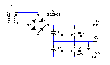

Wasting half the voltage seems like a bad idea - and there would be twice as much heat to get rid of.
Maybe you could do something like shown below, with the left and right channels each having their own supply (one transformer secondary per channel).
It looks a bit funky, but Quad uses this arrangement in some of their amps so I guess it works OK.
I'm not sure what resistor values would be best - with 100R as shown, they'll each waste about 6W as heat. For a class A amp that won't make much difference though.

those 100r will allow a low current unbalance for an opamp or similar low current circuit.
Each F5 could require 5Apk of unbalance when still in ClassA and more if the amp is taken into ClassAB.

The high AC currents will go through the capacitors, so the resistors only have to deal with DC offset current, which should be very low.
Performance should be acceptable although an active solution would be better.

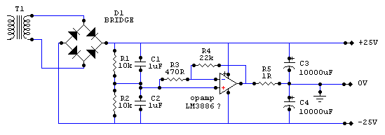

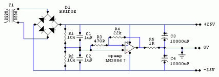

The circuit below could be good. The opamp is used as a unity-gain buffer. R3 and R4 simply limit it's loop gain for stability.
R5 is included to ensure that the bulk of the current flows through the caps, so the opamp will only have to deal with the relatively small DC offset current (and some low frequency ripple).
R5 should also help with opamp stability, and is low enough to ensure minimal DC offset voltage.
Regards - Godfrey
your solution shows a 7A chipamp. Why, if it only has to handle the very low DC offset?.........the resistors only have to deal with DC offset current, which should be very low.

In the active circuit (post 8), all of the loudspeaker return current flows throughyour solution shows a 7A chipamp. Why, if it only has to handle the very low DC offset?
C3//C4//R5. Most flows through the capacitors but at low bass frequencies a significant amount flows through R5 (and the opamp).
For example, with the values shown:
C3 = C4 = 10000 uF, R5 = 1 ohm.
At 32Hz the reactance of the capacitors is about 0.5 ohms each, i.e. 0.25 ohms for both in parallel, so the current through R5 will be about a quarter of the current through C3//C4, i.e. roughly a quarter of the total loudspeaker current.
e.g. for a loudspeaker current of +-2A (1.4A RMS) at 32 Hz, the current through R5 will be about +-0.5 A (350 mA RMS).
The suggested LM3886 may be overkill, but some sort of power device is needed, ideally capable of at least a couple of amps peak current.

thanks for this explanation.In the active circuit (post 8), all of the loudspeaker return current flows through

It shows that
is not true for an audio Power Amplifier..........the resistors only have to deal with DC offset current, which should be very low.
