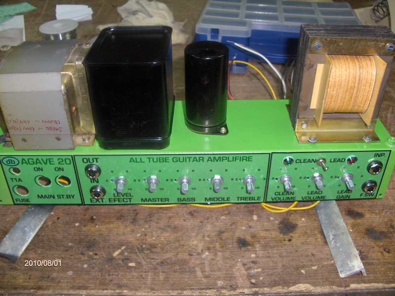

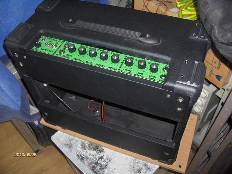

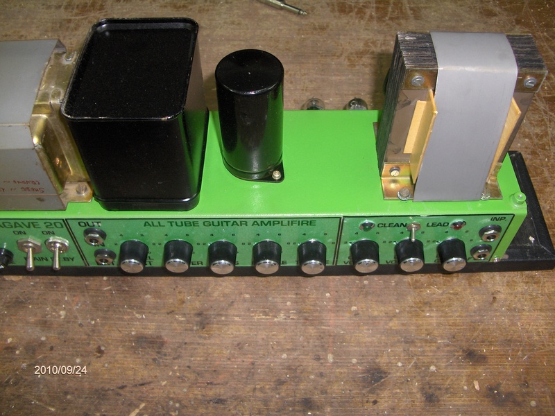

Faceplate was created with "Card Maker 2.0("Zweckform"-program), and printed with HP-DJ970Cxi (ink-jet) on common office paper (80gr.). Glue was transparent spray lacquer on chassis first, than on paper for protect color and printing.How do you do the lettering on the front panel?

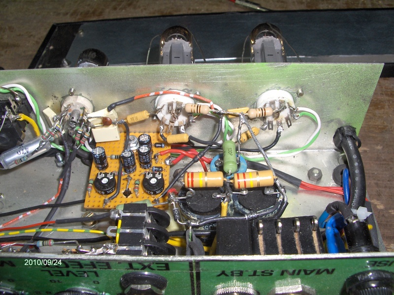

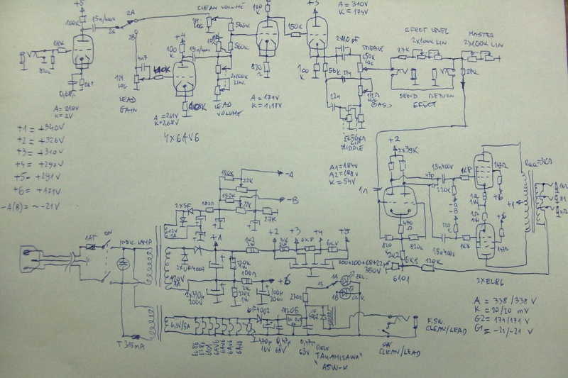

Can you explain the effect level control. It looks like it actually adjusts a parallel "dry" path? I employed a parallel loop in my amp but could not find any schematics. I used a "blend" control to combine the paths after the loop (and a boosting stage immediately after the effects.)
Is there a standard name for the approach you are using for the loop and it's adjustment? Is it based on a particular amp? Is the signal it sends out to the effects unit too strong if the preamp is set high?
