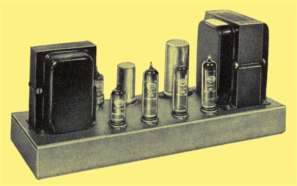

Here's a picture of a generic 5-10 monoblock.

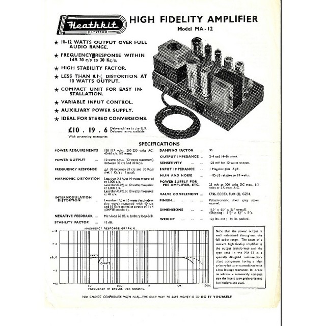

& Heathkit MA-12 brochure.

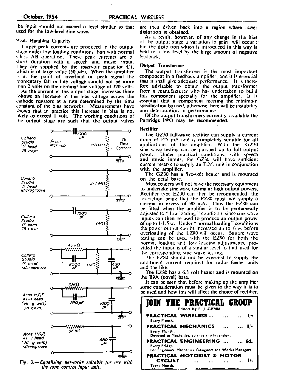

Mullard Back-Room Boffins Create A Legend In Their Own Lunch-Time.
Hello again EL84 lovers & fans of the tiny tube amp.
Here's the original Mullard 5-10 article which appeared in the UK magazine 'Practical Wireless' October 1954 edition.
The Heathkit MA-12 is based on the classic Mullard 5-10 design.
Simon.

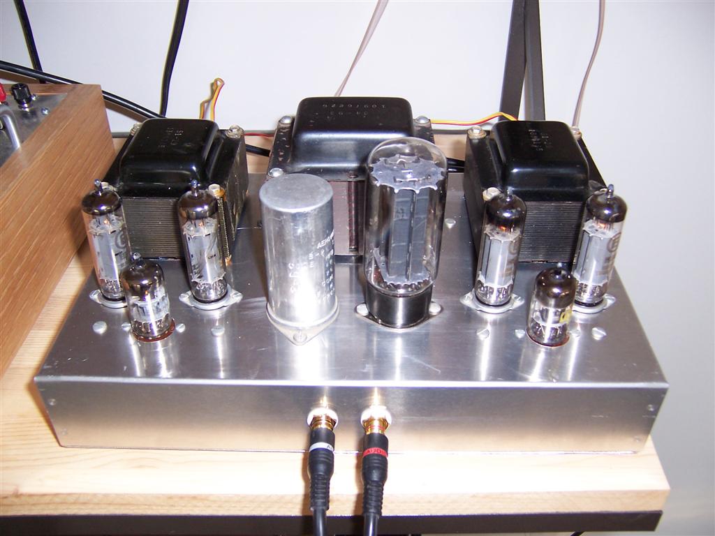

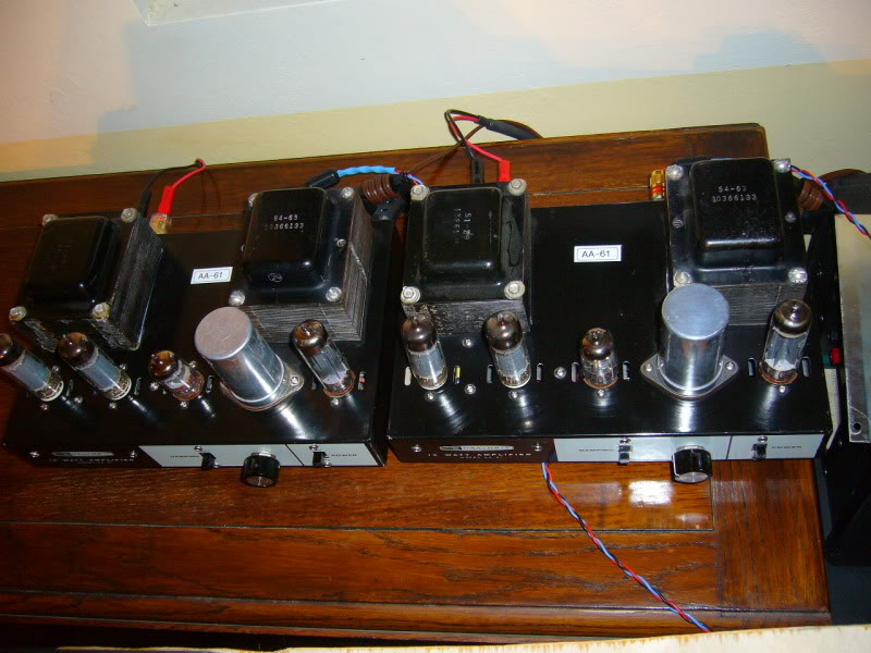

Simon,
How many tubes on this thing including the Phono Stage? Does it look something like this?: Heathkit Virtual Museum | A-9C

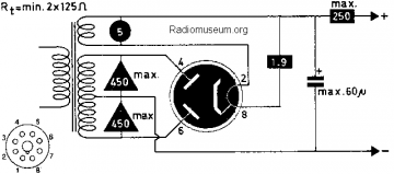

The GZ34 Rectifier Valve Used In The MA-12 Monoblocks.
Heathkit opted to use the GZ34 rectifier valve in the MA-12 monoblocks.
A change from the original Mullard 5-10 design.
Here is the GZ34 rectifier valve, it's pin outs, a power supply schematic and the Philips datasheets from 1954 & 1958.
The Mullard GZ34 rectifier valve with it's 'double halo' getter is thought to sound particularly good.
Simon.

Simon,

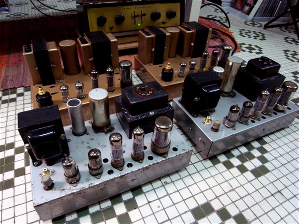

Photograph Of A Heathkit MA-12 Monoblock Pair.
Hi Scott
I should have posted some photos of the monoblocks, but haven't taken any yet.
I shall take some decent photos of them tomorrow, and pop the hoods for an inside look at their guts.
Don't think that'll impress you much though, having seen your neat and tidy construction. Whoever made them got the job done but it 'aint pretty.
In the meantime here's a photo of a pair of MA-12's from the net.
They come in any colour you like as long as it's industrial battleship grey.
See what I mean about slightly different pairs like mine. Ones got a bad case of iron oxide outbreak, and the other looks shiney and new.
When stereo came along I figure folk just made another one to add to their existing mono setup. No built in obsolesence there.
I seem to remember when I switched them on a few years ago the bass sounded pretty chunky, so if I refurbish them and don't use them much, I could always fit an i-pod dock and give 'em to the kids for rap music !!!
Cheers Simon
Simon,
How many tubes on this thing? Does it look something like this?

I should have looked at your first post last picture. It shows that it is a Heathkit. The additional pictures are of great help.

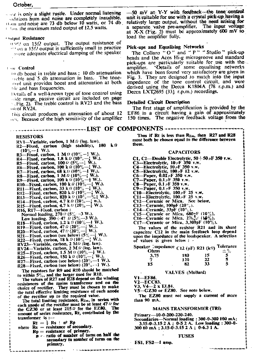

The MA-12 Amp Has 40mv Input Level.
Hi mashaffer
Yes your right the Mullard and the Heathkit both have an input level of 40mv.
There was a phono preamp available for the Heathkit MA-12, which could be powered from the octal power supply outlet socket on the back of the monoblock.
Heathkit also made a matching radio tuner that had it's own AC power supply.
It could be switched through the preamp (or two preamps, with obviously seperate selector switch and volume controls), there's a thought you could play an old 78 on the left speaker while listening to the news on the right.
I think though, the main reason for the very high input sensitivity, was to allow the direct connection (in either mono or stereo) of a crystal type phono pickup to the system without the need for the preamp/s.
The monoblocks actualy have as standard, a volume dial built into the top of the chassis.
Some people didn't want or need the tuner and preamp, and even as kits, my guess is at the time they were released, they weren't exactly cheap, but they were affordable and 'upgradeable'.
All in all a very modular system, and perhaps even a bit ahead of there time.
Simon...

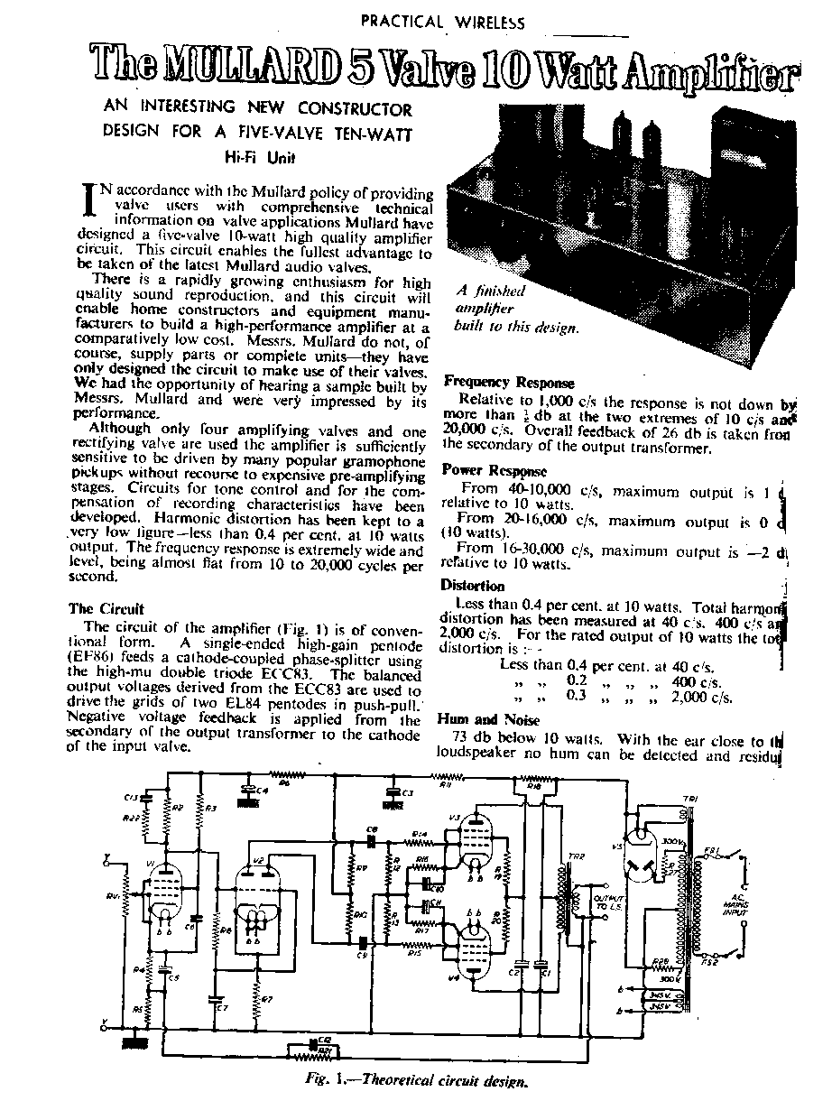

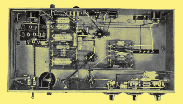

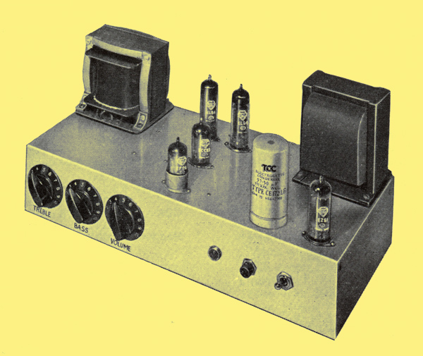

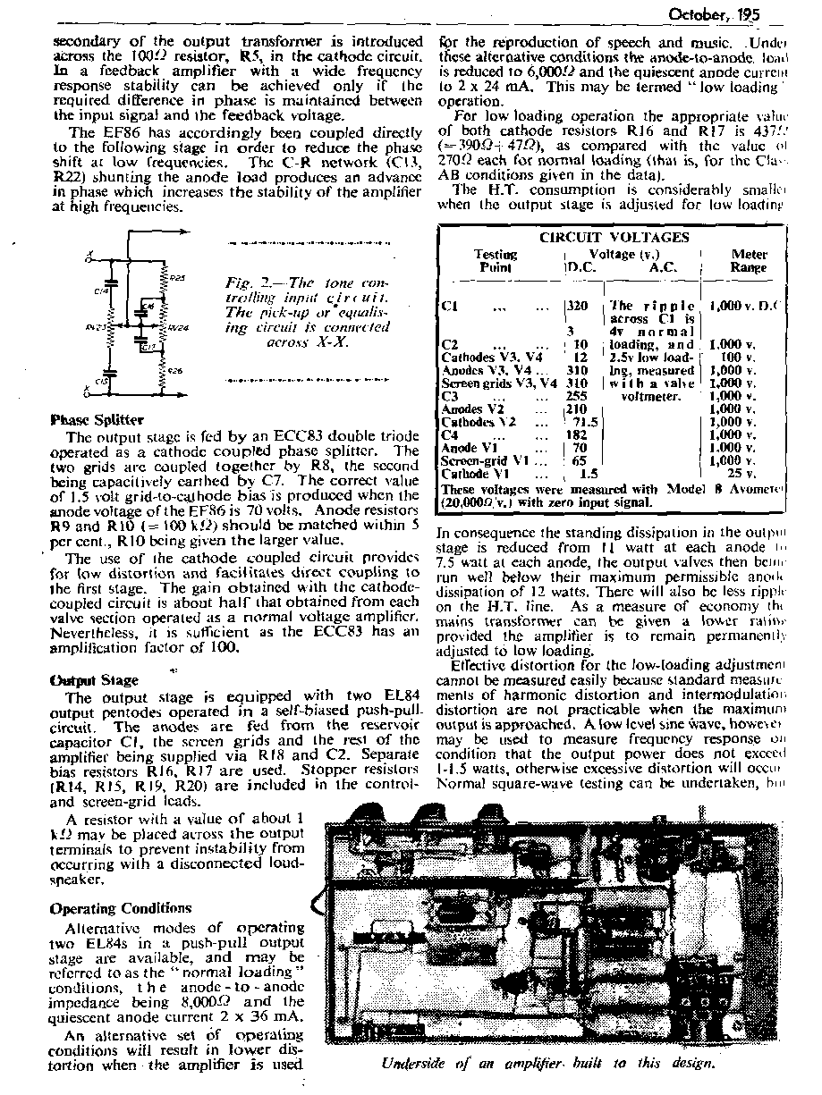

The pictures below show a generic Mullard 5-10, with and without volume and tone controls.
I wouldn't, given the rarity of those amps.
Classic Mullard did have a boat load of GNFB.

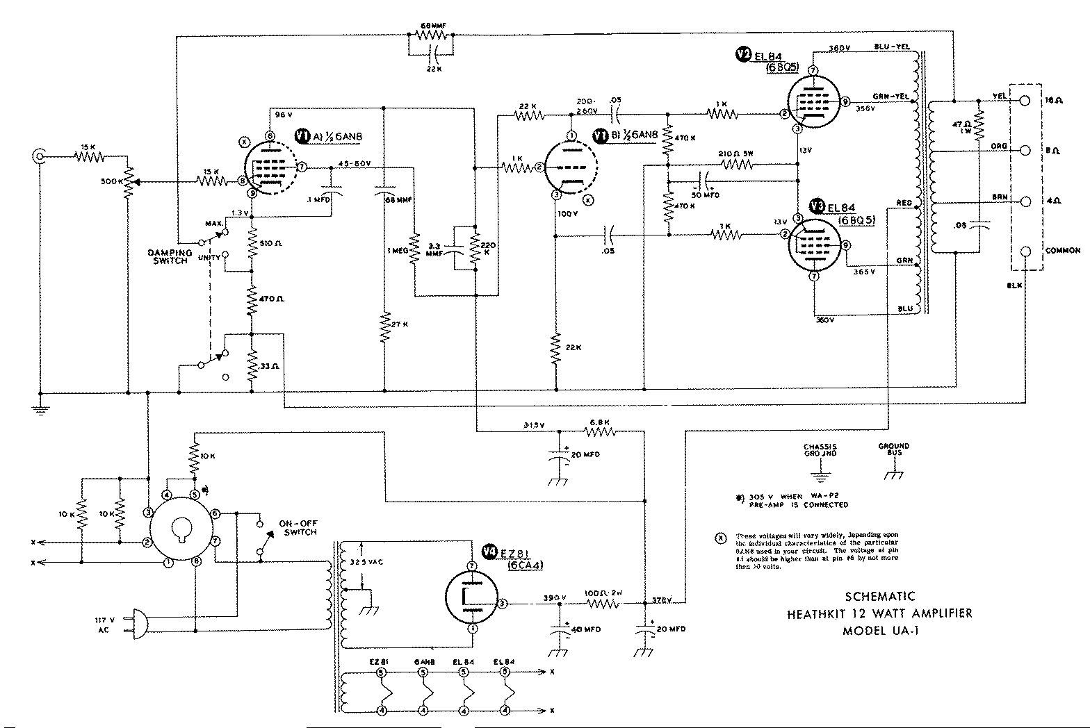

The last circuit only has four tubes. THe input and splitter share the same V1. It is also a different splitter than the typical mullard.
It's a completely different circuit, but I bet someone in NA built a Mullard clone.
Jeff
The fifth tube is the rectifier......."5 Tubes"
# of Tubes ?
Hi Scott
I still make that 5 ?
Simon...
I had the regulator included when I counted four. In the last schema the V1 is a triode/pentode combo tube which serves both as the input and a phase splitter duties
Hi Scott
Simon...

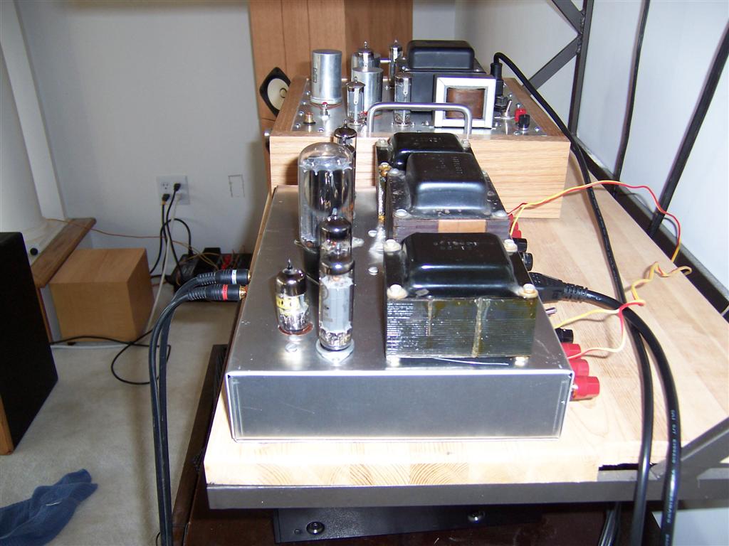

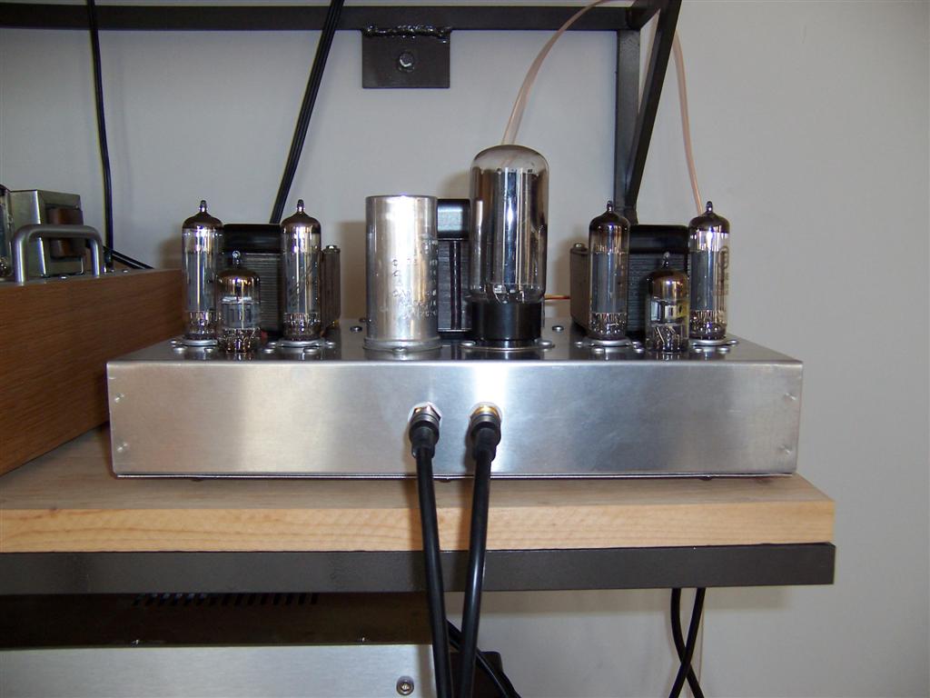

Finaly Found A Guy Using A Pair Of Refurbished Heathkit MA-12's !

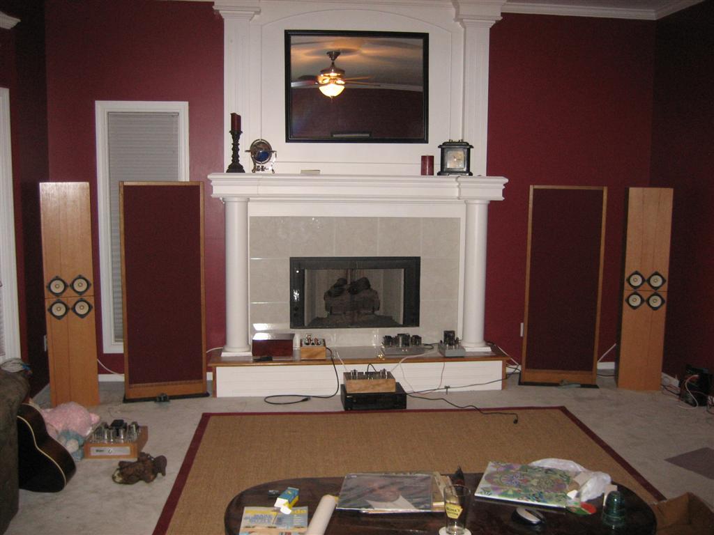

Finaly found a guy using a pair of refurbished Heathkit MA-12's !
I think that has to be the longest net search I've ever done, and I still haven't located a copy of the original Heathkit schematic.
There's zillions of Heathkit schematics out there on line but not this one so it seems.
I think I will send this guy an e-mail and see if he has the original schematic.
He seems to be adopting a very small kit, very large speakers approach.
The refurbished monoblocks have been 'stereoed' and are running into big 4 driver, full-range horn speakers with large panel speakers at each side.
Seems to have a few other pieces of hyper-minimal valve kit on his web site as well.
Simon...

Hi Vinylkid
Thanks for the photo of the AA-61's.
I have come to the same conclusion as you I think.
There are loads of 'AA' series schematics on the web but I had ignored them as they obviously wern't an MA-12. But...
I think now the amps coded 'AA' something were all sold outside the UK, mostly in the USA, and maybe around the rest of the world.
There's the odd Brit comment about them in one or two forums here, but still no schematic.
Your picture shows an original chassis with no 'missing tubes'.
What I have learned seems to be that when people refurbish and maybe re-chassis the MA-12's, they either modify the EF86's wiring, as all that gain isn't needed these days, or they just get rid of it, leaving 3 tubes and a rectifier per channel.
Am just going to check on the code number of another 'USA ?' issue amp and see if the schematic for this looks right.
Thanks for your help VK

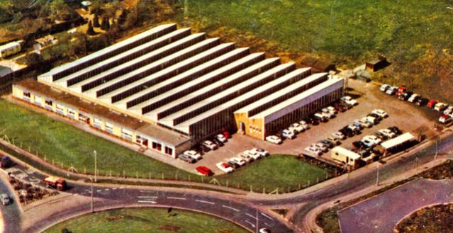

Here's their factory, in England they were known as Heathkit Daystrom Ltd.
Here are a pair of Heathkit AA-61's. Same circuit as the UA-1, four tubes each.

Hi Vinylkid
Simon...
