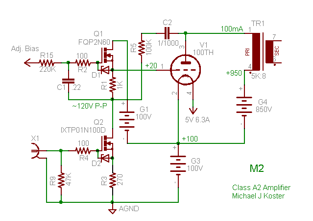

You don't say that the line input has to drive the grid directly so... It could be done with a couple of MOSFETS driving the grid of a 100TH with current mode plate feedback.
About 25W at the plate, 20W+ output depending on OPT. 80W dissipation + 30W filament.

OOPS grid is actually +20 wrt the filament so make that +120 from ground.

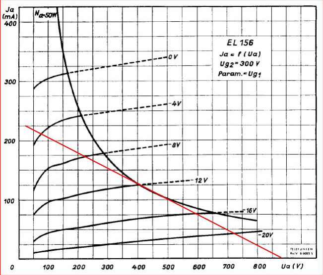

I guess one could get almost 25W out of an EL156 with an input stepup transformer, run right on the edge of it's 50W (autobias only) dissipation limit.
There's no way to apply any NFB given the input signal is barely enough, so there will be no speaker damping to speak of.
But it could be done...
