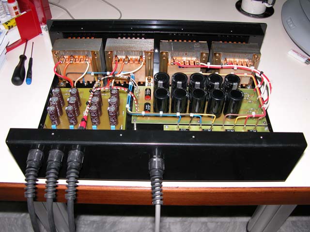

The transformers are 160 VA each, Split-Bobbin types without Faraday shielding.
There is no hum, no buzzing, no voltage drop under load and the preamp sounds huge and very relaxed.
If not in standby mode the pramp needs about 1 hour from turn on to sound at its best.
Original Aleph preamps were fitted with an on-off switch???
