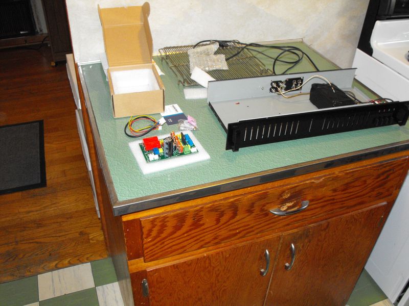

i really like my dayton dta-1 amplifier.so i finally decided to get a helder mk3 2024 board ordered today.does anyone have any experience with this particular version?this board can accept either ac,or dc input.which would i be better off doing just getting a transformer,or building an entire power supply?either way for starters i will probably just use a transformer.with consideration of the upgrade path if needed.

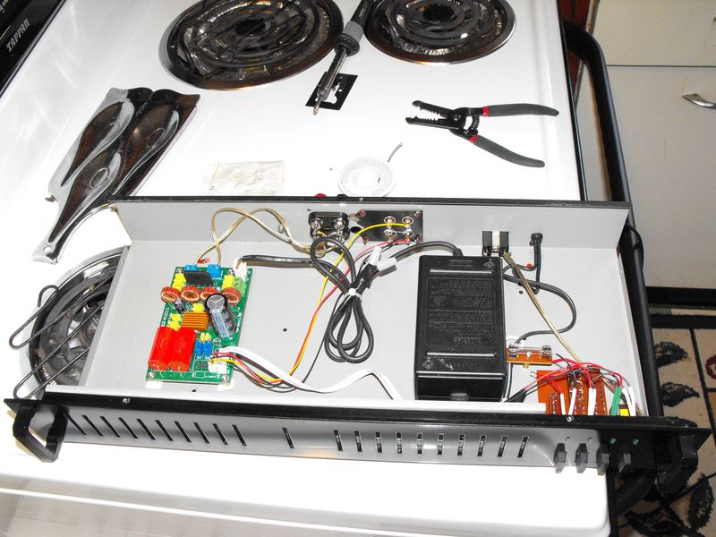

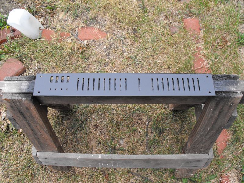

i got a chasis for it already.its an old blown up equalizer.its already gutted out so its ready to build.i am gonna sand down the face to remove the lettering and stuff.then im gonna refinish it glossy black.
well the day is finally here shipping was faster than expected.so far it does sound good for such a new built amp with no real burn in time.the highs are a tad harsh. just like my dayton dta-1 was when i first powered it up.
i must say for a decent amp on the cheap it is surprising.i have spent less than 50$ on it and a bit of time of course.so far im very pleased.

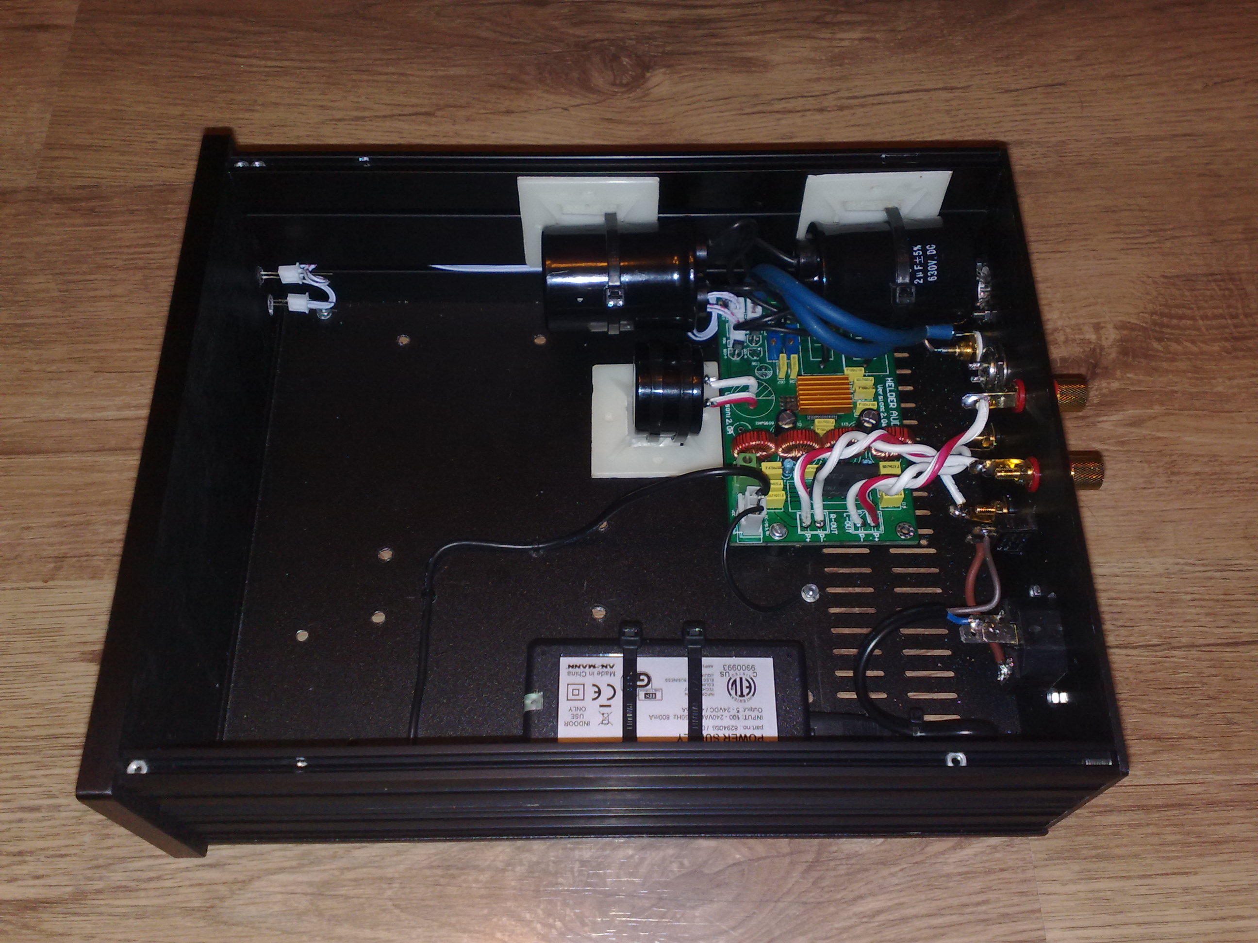

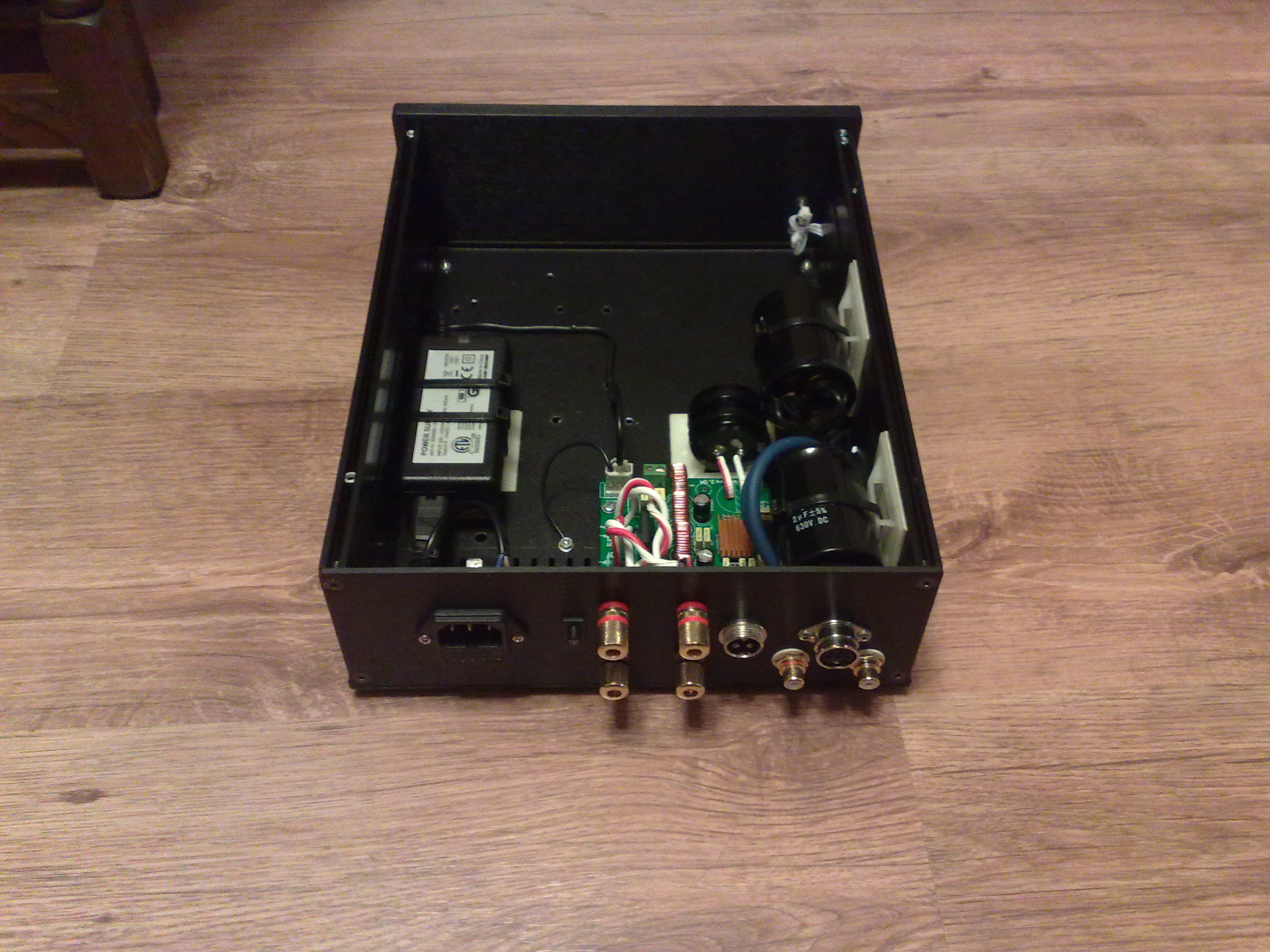

All finished and cased.
Changes to standard board are bigger (18,000uf) tank cap and Panasonic FC's (220uf, 25v) at the chip, a 3.3uf cap added to the 5 volt reg line and of course the two flipping huge Oblligatto 2uf coupling caps!
Sound is a lot smoother and detailed with little listener fatigue.
Still don't think it's as good as my Amp-32 but it's pretty good for the money.
Case was 1 of a pair bought off that site second-hand, hence the spare holes!
13 volt sm power supply.

Not only with stock components but I've been through several changes of capacitors and 3 different power supplies.
All sounded different but the final configuration is the best of the lot.
To be honest the stock input coupling caps are not bad at all, the Obbligatto's did not give me the huge improvement heard by others.
But then again, one mans meat is anothers poison.
At the price these come shipped at they are a real bargain as it must be remembered that they are fully assembled, tested and have offset adjustment as standard.
To achieve all that with a kit takes lots of time and soldering skill for the surface mount components.
Here's to hoping mine gets even better after a decent break in time, I'll report back if anybody is interested.

And here is that later report!
3 months, 1 Christmas and a lot of burn in and comparisons with a verdict that I like it, I like it a lot.
Without warning the Obbligatto's have become exactly what everone said they are, the differences from the stock caps are remarkable. They are smooooth, fullsome in the bass and have nicely differentiated detail without any harshness in the midband or treble that I can hear.
In comparison my AMP 3 now sounds more 'shouty' and strained after prolonged listening. I had also been using a lightly modified Teac AL-700 which gave the benefit of greater power available which I thought would be significant but strangely at normal listening levels any difference between the Teac and my implementation of Argen's 2024 board revolves around a sense of greater ease and general listenability from the 2024.
All this into Scandyna A25's firstly and then a pair of Dalesford D's.
The Scans are are 4 ohm and fair effeciency whilst the Dalesford's are 8 ohm and a low 82dbw and yet power is never an issue within reason (and neighbors).
So, an undeniable and unexpected success.
To be absolutely honest, I never really expected a great deal from this soundwise as I always found the original T-Amp somewhat strident even with cap changes and mods galore. It was as if great promise was hidden by the implementation and cheap components used, not so with Argen's board which even in stock form is nicely constructed with above average component quality and reliable.
I'll continue to pile on hours and see if there's any further developments if there's any interest.
