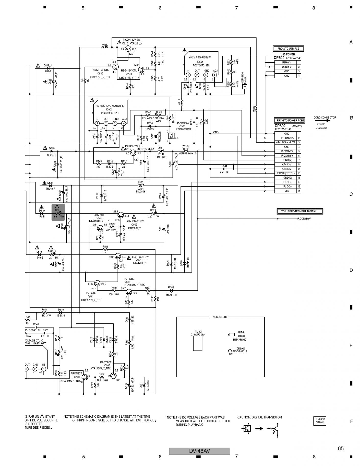

stephensank, that's a very interesting point. My DV-48AV typically takes quite a few seconds even to just light up (and it won't start up if I remove the cover), so I'm sure there were some processes that start after others. I've attached the schematic of my power supply board, and I'm using pin 3 of CP502 (AT +12AV for MUTE) to power my clock board. Does anyone have any comments? Is there a way to make the power go on sooner?

The first thing to try is to move the power feed to the other side of that regulator transistor, to the PCON+12V output. This still may not time the start up right.

I've also tried the PCON +12V output to no avail - in fact that's what I used first before moving on to pin 3. The reason I thought pin 3 could be better is because it comes out directly from the transformer T501, just as the AT+3.3V does, and I believe the AT+3.3V powers the factory clock. It sounds like the problem is the clock starts too early rather than too late? That's really weird - what do you think the processor is looking for? Does that mean an externally supplied power would be even more difficult?
