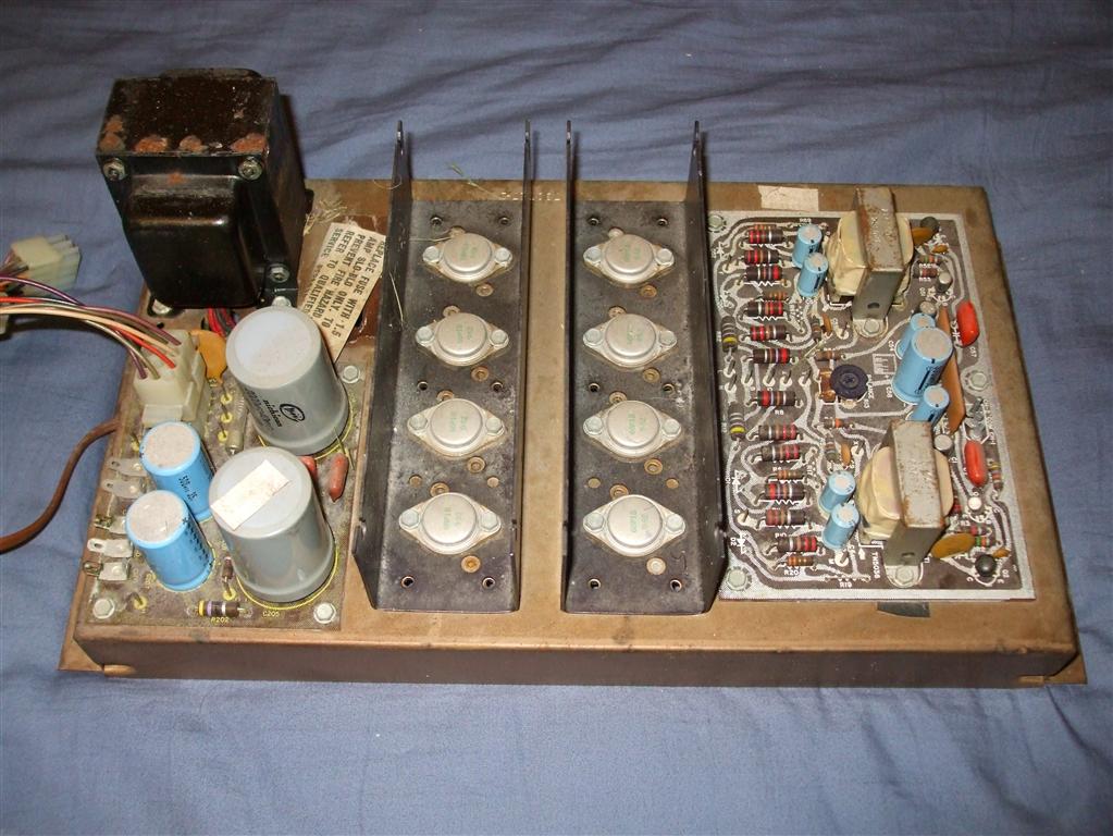

What are the transistors called?
TO-3 case 68P1B (crosses to NTE 121) Germanium PNP

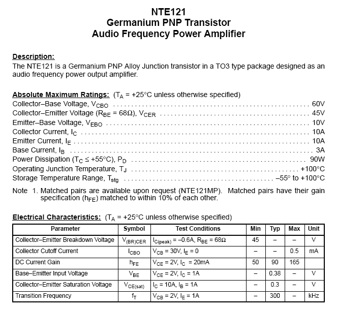

It is a 45V, 10A, 90W PNP Audio Output TO3 GERMANIUM transistor.
At least NTE121 and 68P1B is something like.
... See attached data ....
The hFE gain is good: 50-165, typ 90
VBE at 1A is only 0.38V ... which is a Germanium feature
fT, upper transistion frequency is low: 300 kHz
but this enough to make a good output follower stage
I am sure someone would like to try those.

How much for shipping to sweden ?
Probaby alot.
25-30 USD ? Im willing to spend about that much for a free amp.
I really don't have any idea. Last time I shipped something out of the states (dvd player) it was over $100 in shipping.
- Anyone want this?
