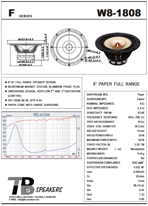

I wanted to avoid creating a new thread with the same question, but I have the need for experimentation. Regarding the value of capacitor / resistor, this is an inquiry that I posted to the Parts-Express W8-1808 page:
"I am a novice builder that has a set of these W8-1808 drivers. I am interested in calculating a Zobel network for them, and I think that I may be missing something… The two calculations that I have tried using states: R = 1.25 x Re, where Re is driver’s DC resistance in ohms [R = 1.25 x 6.8 = 8.5ohm], and: C = Lvc / (1.25 x Re²), where Lvc is the driver’s voice coil impedance in henries. The spec sheet of the driver (located above on this page) shows Le is 0.048mH, or 0.000048H: [C = 0.000048 / (1.25 x 6.8)² = .000000664 Farads, or .664uF]. For everything that I’m reading, the ending capacitance value of ~.664uF is much too low. Am I overlooking something crucial or missing my decimal placement? Thank you!"
Please reference attached spec sheet:
