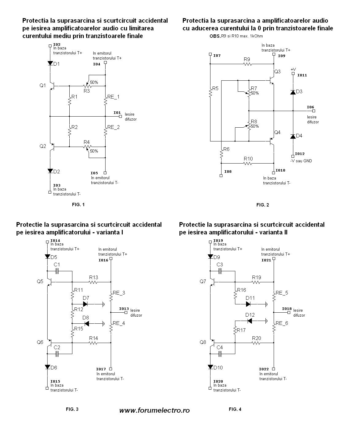

Symetrical input stage (mirrored) receive 1mA current, from precision constant current generator, thermally compensated.
Watching Makie M1400 schematics, mine amplifier is more more simplistic, and does't look the same.
Sorry, schematics will not be posted because is mine prototype.
PCB is JUST for testing purpose, professional PCB will arive in 2-3 weeks.
So on this simple PCB works like that, in a pro PCB will work minimally the same!
I'm satisfied with the results of it.
Mine protection Kill entire input stage, not pilot transistors!
That means at accidental shortcircuit on outout(as you can see in some movies posted), will shot down differential input stage.
Also second protection will activate with some delay,(mutting) the general input level, untill overload dissapear.
Also will be thermally protection with bimetal or LM350 circuit.
But all these in other module separately.

DjLeco, this is the picture I referred to in the previous message (fig.4).
By the way, what PCB software you use for the assembly?
I think he means killing the bias in the input stage. Not the parts. :D Doing that wouldn't be very productive.
So have you built an amplifier that does 500W into 8 ohms and 900W into 4 ohms like you suggest is needed to be "good"? It requires "a little" more extra bulk than getting so close to doubling in a 100W / 8 ohm amplifier...
In my case will shot down the differential outputs before go further in schematic.
Hope this explains better:
Hi, as a mental exercise and to understand the consequences of protection, take a moment in time when the output is at -30V with +-35Vsupply rails and connect the output to ground with a 1r0 resistor.
Hold this snapshot and put in all your voltages and currents and see what the protection transistor has done to load up the VAS. Does this condition damage the VAS? Will the active (triggered) protection transistor and/or the damaged VAS cause consequential damage to the input stage?
Hold this snapshot and put in all your volates and currents and see what the protection transistor has done to load up the VAS. Does this condition damage the VAS?
Whai is VAS?.
In my movies, IF ALL OF YOU, will have PATIENCE to watch it all from start till end, you will see SHORTCIRCUITS, DIRECTLY TO OUTPUT,AND UNDER 2 OHMS LOADING TOO with suplimentar dummy loading,during tests...
Protection works flawless, but must watch movies and see...
I think it was better if implemented protection from Mackie 1400 input stage. But who knows, maybe the next version of the amplifier!
The VAS is the transadmittance stage. At this stage, a word to say on performance amplifier it is determined solely by the Miller capacitor (called C_dom). All the voltage gain is provided by the VAS stage, which makes for easy compensation. The local NFB (negative feedback) working on the VAS through C_dom has an extremely valuable linearising effect.
Any amplifier operates in two regions: the LF, where open-loop gain is substantially constant, and HF, above the dominant-pole breakpoint, where the gain is decreasing. This regions must be controlled carefully by choosing proper values of capacitors and value NFB diagram audio amplifier. In the HF region, things are distinctly more difficult as regards distortion.
